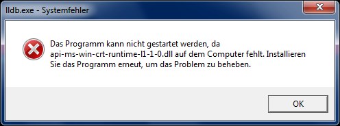

CT LAB ver 6.80 7 years 8 months ago #13219
  • Peter Heckert
  • Peter Heckert's Avatar
FpDebugger is ok now.
It stops at a breakpoint.
However, currently also GDB stops at the breakpoint. (I am referring to the simple test project above.) So I have to try again, when the problem occurs again. I dont know a way to force it, it happens randomly.
Both debuggers do not step into FormatDateTime.
lz_debuggerlldb was already installed.
If I try it, I get a message about a missing DLL.
Last edit: by Peter Heckert.
CT LAB ver 6.80 7 years 8 months ago #13220
  • Posts: 1436
  • Thank you received: 233
My mistake
CT version of LLDB don't support Win7

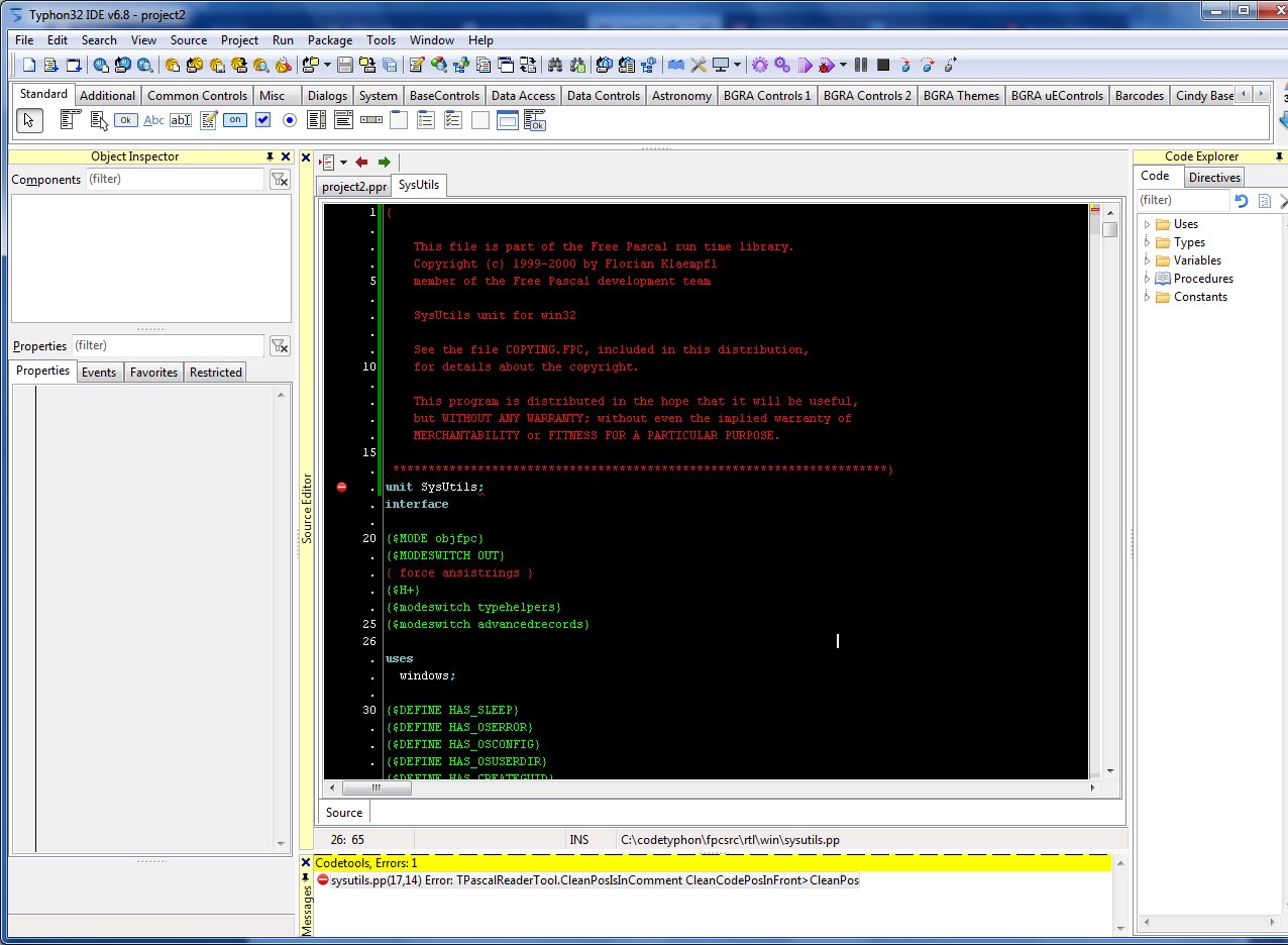

CT LAB ver 6.80 7 years 7 months ago #13232
  • Peter Heckert
When I try to find the procedure definition of any procedure in datih.inc, then I get this message in the message window:
Codetools, Errors: 1
datih.inc(158,73) Error: TPascalReaderTool.CleanPosIsInComment CleanCodePosInFront>CleanPos
CTLAB 6.8 32 Bit medium sized IDE on Win7 32 Bit
Edit:
I added a screenshot with another example:
If I use Alt-Up to go from my project to the unit SysUtils I get:
sysutils.pp(17,14) Error: TPascalReaderTool.CleanPosIsInComment CleanCodePosInFront>CleanPos
CT LAB ver 6.80 7 years 7 months ago #13235
Just restart the Typhon IDE and try again
IDE CodeTools need more work...
