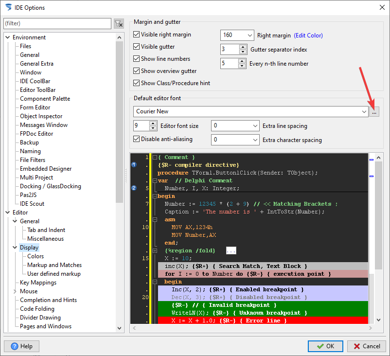

  • skrzat
  • skrzat's Avatar
  • Posts: 44
Whenever I upgrade to new version of CT, I change default editor font. For the first time I can't do this. I try every CT LAB version and I never had problem. But in newest one (7160), when I click on "...", it doesn't show window with fonts installed. It freezes IDE. I must end process to close IDEWindows 10 64bit. The same is with 32bit and 64 bit of CT LAB 7160.
Last edit: by skrzat.
CT LAB ver 7.20 6 years 3 months ago #14933
  • Posts: 1434
  • Thank you received: 231
We fix-it and we are preparing Revision 007165

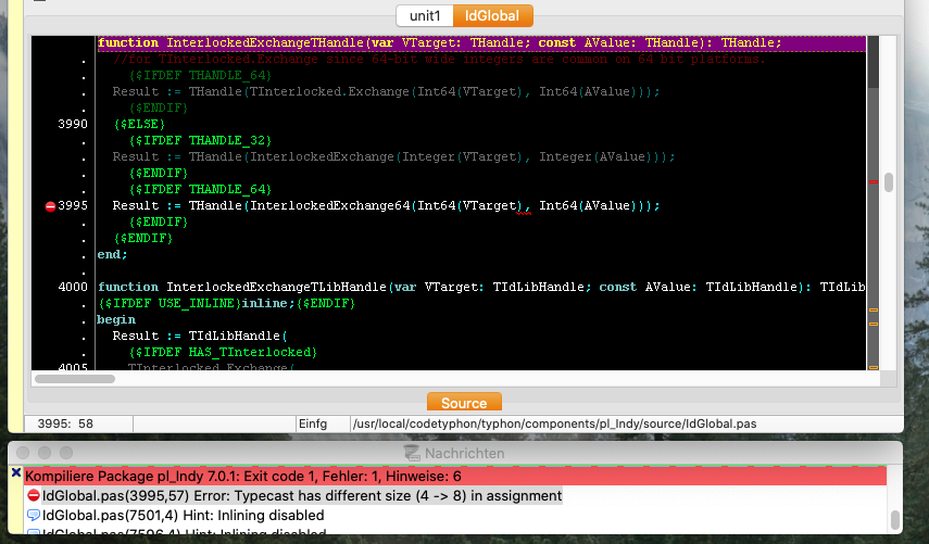

  • Idelberger
  • Idelberger's Avatar
  • Posts: 10
Hello sirs,
I found an error in pl_indy in the new build.
Typhon 7.2 r2008202055 FPC 3.3.1 r2008202055 Platform : x86_64-darwin-cocoa
Errormessage in file ldGlobal, line 3995.
See attachment.
Best regards,
Jens Idelberger
CT LAB ver 7.20 6 years 2 months ago #15003
  • Posts: 1434
please give us time to fix
CT LAB ver 7.20 6 years 2 months ago #15004
  • Posts: 1434
Replace IdGlobal.pas
with fixed in attach zip file

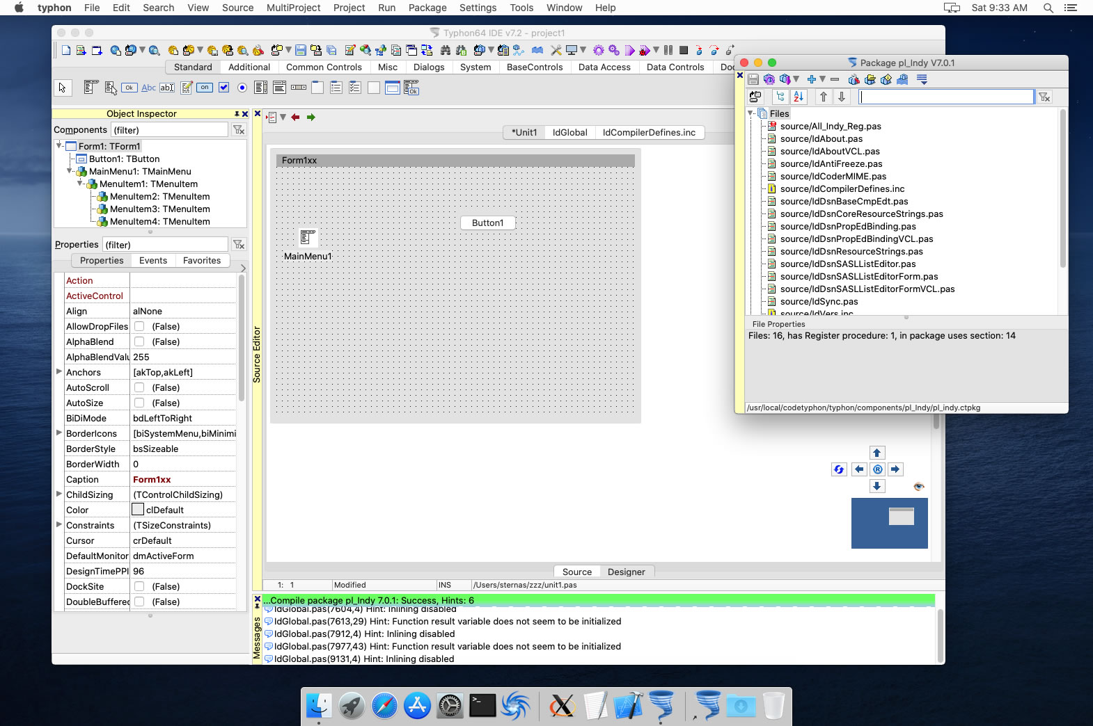

In last CT 7.20 Revision 007180
we fix and Embedded Form Designer on MacOS.
Has some small problems but it's a positive step...
Screen from MacOS 10.15.6 now...
