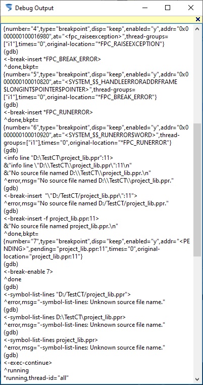

Early I wrote that even in simple dll project dont work debug in windows.
Same project is debuging ok in linux in CT, and in all OS in lazarus.
In internal debuger log I see that file name of modules not found.
I tested this in versions 7.0 and 7.1.
Is there any hope that this feature will work in version 7.2?
CodeTyphon is great IDE but I cant use it without debugging dll in windows.
Thank you

Andrew wrote: Hello
This is test projects and internal debug log
Thank you
we find the problem, it's in GDB build.
We are rebuilding GDB 9.2 for windows now,
after the totally update of "CrossEng" CT Session with GCC 10.1.
After new GDB tests, we will release new LAB CT (ver 7.2.0) revision
But you can use LLDB debugger, works OK

CT LAB ver 7.20 6 years 4 months ago #14804
You can download the new GDB ver 9.2 builds for Win32 and Win64
from here
Just remove C:\codetyphon\binGDB folder and replace it with new from binGDB.7z
CT LAB ver 7.20 6 years 4 months ago #14805
  • Andrew
  • Andrew's Avatar
  • Posts: 8
Its work!
Great job.
Thank you.

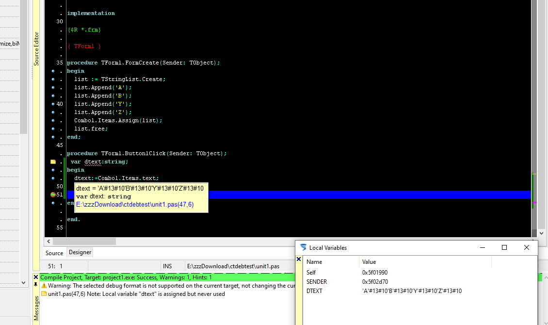

Tested the new gdb. For me, it works but, as always, cannot inspect TStringLists, for example items inside a TComboBox. Please see the simple project attached. I set a breakpoint in line 48, click Button1, set the cursor over "Combo1" and press ctrl-F7. Gdb shows a lot of properties of Combo1. I write "Combo1.Items" and press enter; again a lot of properties but no way to see the actual items. It used to work using FpDebug but I have just realized that this no longer works. Tried with dwarfsets, dwarf2, dwarf3 but no luck, it is almost the same as with gdb. LLDB does not work here. After ctrl-F7 it shows an empty evaluate/modify box and hangs. The debugee dos not run anymore but the red stop button still shows as active but does nothing, and the only way to get out is to kill typhon.
Typhon64, latest lab 7.20, windows 10 x64 v1809.

CT LAB ver 7.20 6 years 4 months ago #14809
my suggestion is to use "local debug variables"
in your attach sample
 var dtext:string;                  //<=== local variable for debug only
  dtext:=Combo1.Items.text; //<=== Set value to local debug variable
  ShowMessage(Combo1.Items.text);
in code above you can "inspect" Combo1.Items.text

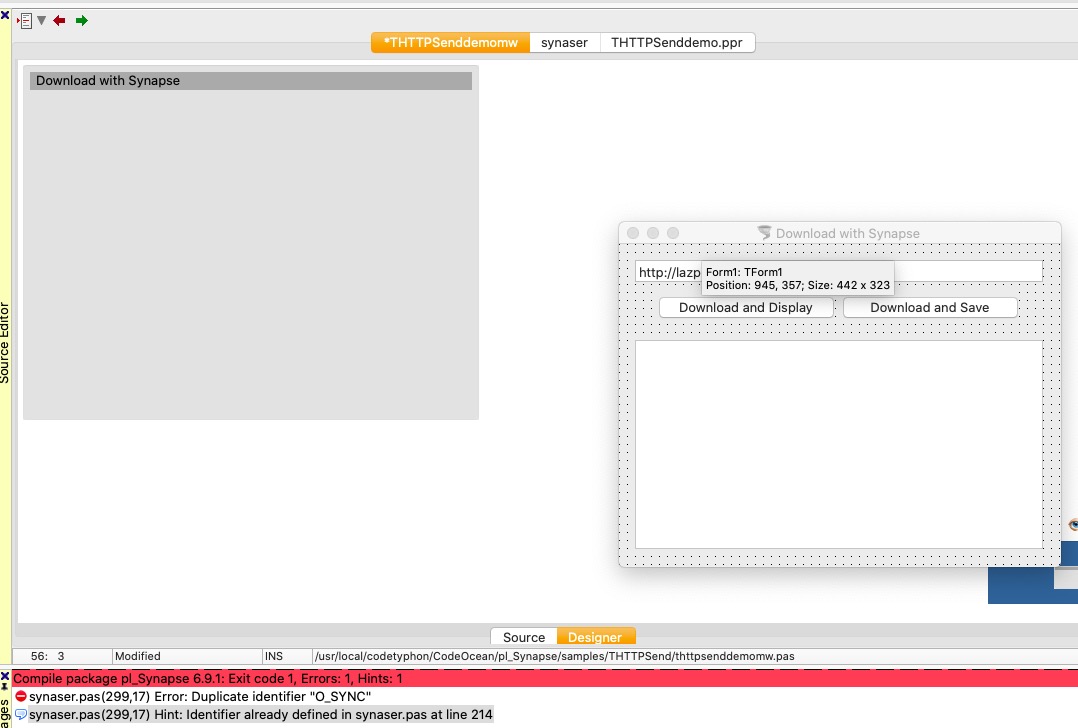

Hi, I just upgrade CT from 6.9 to 7.2 (both FPC & IDE are 2006190435) on OSX Catalina.
Found two problems :
1. try to build THttpSenddemo of Synapse in CodeOcean Examples, errors:
synaser.pas(299,17) Error: Duplicate identifier "O_SYNC"
synaser.pas(299,17) Hint: Identifier already defined in synaser.pas at line 214
2. The Embedded Form Designer is not working, the "design window" is always floating, screenshot attached.
Thanks!
