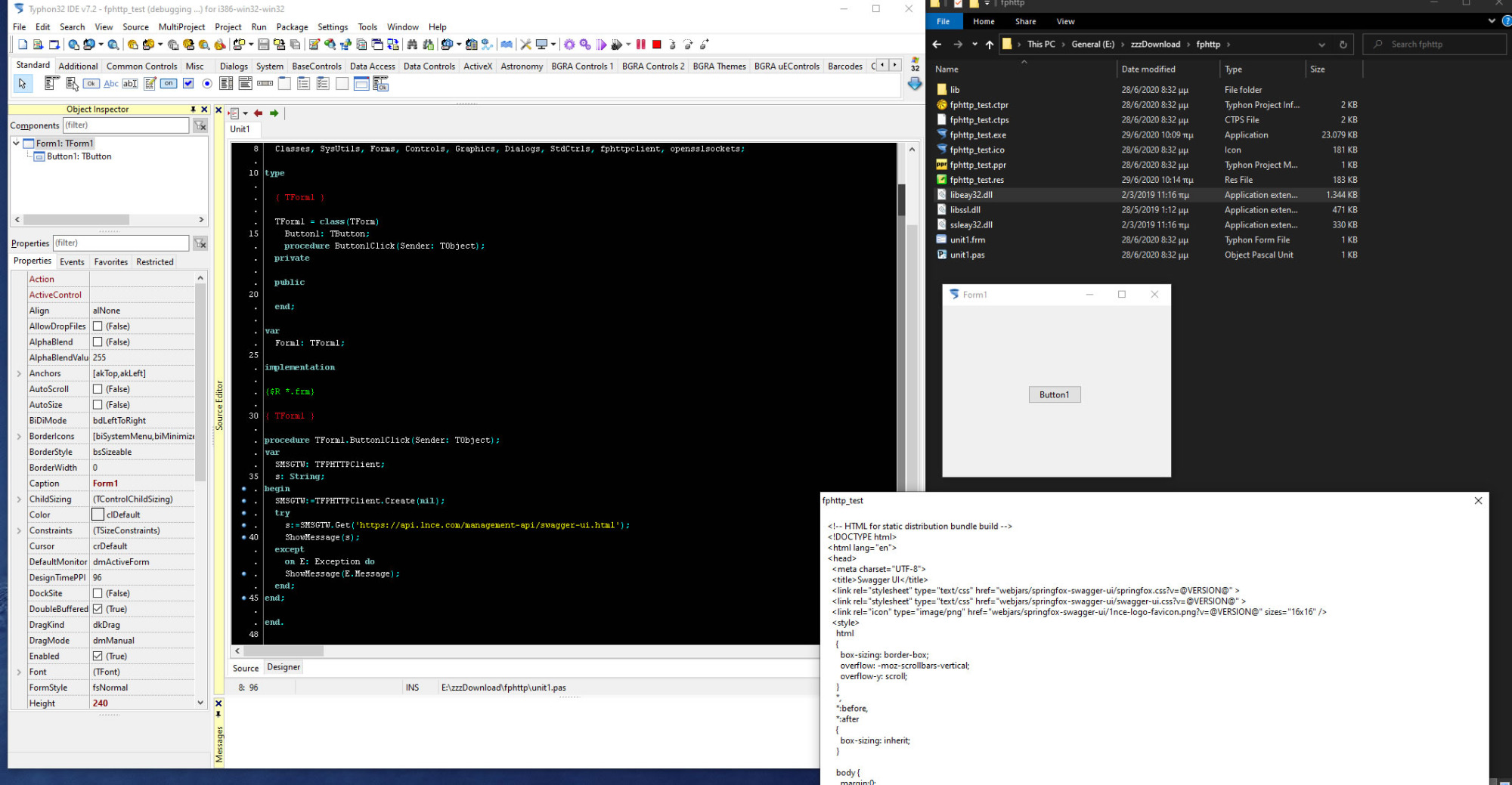

  • Gyula Kampfner
  • Gyula Kampfner's Avatar
  • Posts: 25
Windows 10 64 bit, ct 7.1. I'm out of office now so i cannot send a project now, but what i sent is the problematic part. Just run it from a button click event. Thank you :)

  • Gyula Kampfner
  • Posts: 25
Here is my sample project:
File Name: fphttp.zip
File Size:536 KB
CT LAB ver 7.20 6 years 4 months ago #14832
all work OK here
We just copy from C:\codetyphon\binRuntimes\i386-win32\ folder
to your executable folder
the libraries:
libeay32.dll
libssl.dll
ssleay32.dll
CodeTyphon has the correct Runtimes Libraries at codetyphon\binRuntimes

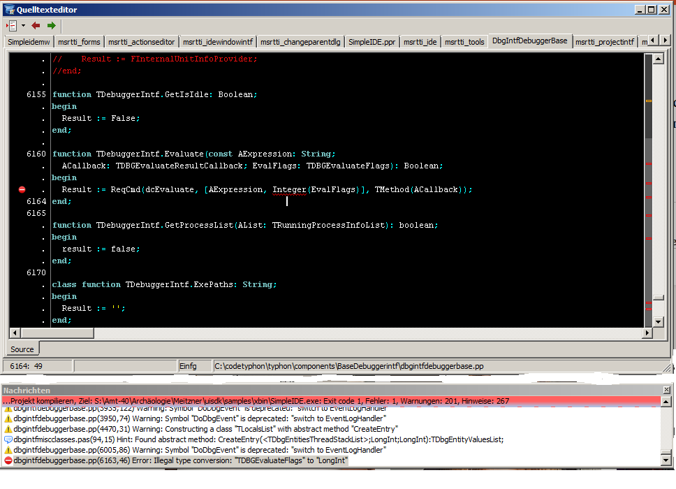

  • LuZZZZi
  • LuZZZZi's Avatar
  • Posts: 130
The next issue I found in dbgintfdebuggerbase.
There is a set which can't cast to Integer. See picture
What is the solution for that?
Thx for help.
CT LAB ver 7.20 6 years 4 months ago #14878
Replace
Integer with PtrInt or PtrUInt
Integer(xxx) work only on 32Bit Pascal.
CT as leading Programming Studio use THE latest Object Pascal.

  • LuZZZZi
  • LuZZZZi's Avatar
  • Posts: 130
I have tried your advice but the issue persists.
dbgintfdebuggerbase.pp(6163,46) Error: Illegal type conversion: "TDBGEvaluateFlags" to "Int64"
Thx
