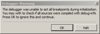

CT LAB ver 5.30 11 years 9 months ago #6801
  • Vbxler
  • Vbxler's Avatar
I've compiled CT 5.30 Revision: 005221 under winxp-32 and tested under win7-64, runs so far.
But when I press the button 'Start', I get the following new message:
If I press ok, I can continue to work normally.
CT LAB ver 5.30 11 years 9 months ago #6802
we will check this
CT LAB ver 5.30 11 years 9 months ago #6803
  • Martin
  • Martin's Avatar
  • Posts: 1
Vbxler wrote: I've compiled CT 5.30 Revision: 005221 under winxp-32 and tested under win7-64, runs so far.
Please report this one on the lazarus issue tracker bugs.freepascal.org/view_all_bug_page.php?project_id=1
and attach a logfile. thanks
wiki.freepascal.org/GDB_Debugger_Tips#Lo...fo_for_debug_session
Last edit: by Martin.

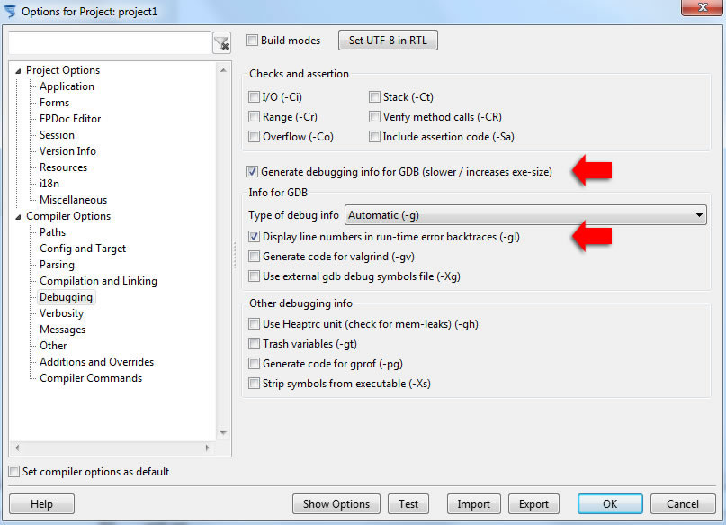

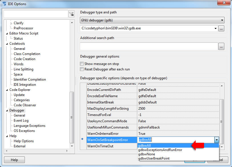

CT LAB ver 5.30 11 years 9 months ago #6811
Check if
and
if NOT set Debugger info at your project=> Options => Debugging settings
and you have set on Typhon IDE =>Options=> Debugger Page :
WarnOnSetBreakpointError=gdbwAll
then you will get this Warning from the Typhon IDE,
debugger NOT has "Break Point" Info

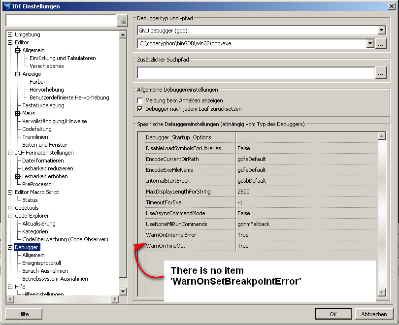

CT LAB ver 5.30 11 years 9 months ago #6819
  • Vbxler
  • Vbxler's Avatar
There is no entry 'WarnOnSetBreakpointError':
CT LAB ver 5.30 11 years 9 months ago #6820
We will fix this Sir
PS: we fix it
