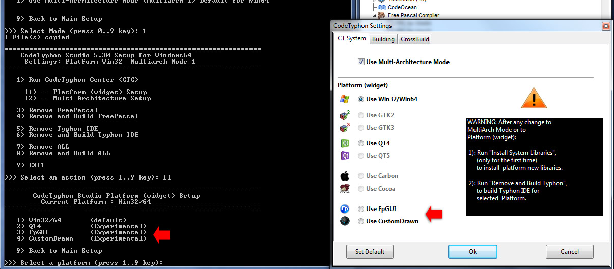

Hello Sternas.
What do you mean with =>
--05-03-2015 Add ability to build Typhon IDE for "customdrawn and "fpgui" platforms on Windows and solaris
Is it possible to build Typhon with fpGUI widgetset ?
If yes, how did you do to fix TfpgLabel ?
Do you have plan for Linux ?
Thanks.
Fre;D
CT LAB ver 5.30 11 years 8 months ago #6879
The First Step is to give the ability to Codetyphon Studio to Build Typhon IDE for
Customdrawn, fpgui and new QT5 Platforms.
Now this ability is the same for all Host Typhon OSes Windows, Linux, FreeBSD, Solaris and MacOS
The second Step
is to fix all problems
On this CT version (5.3) we working on TyphonIDE Platforms (Customdrawn, fpgui and QT5), it's a lot of work....

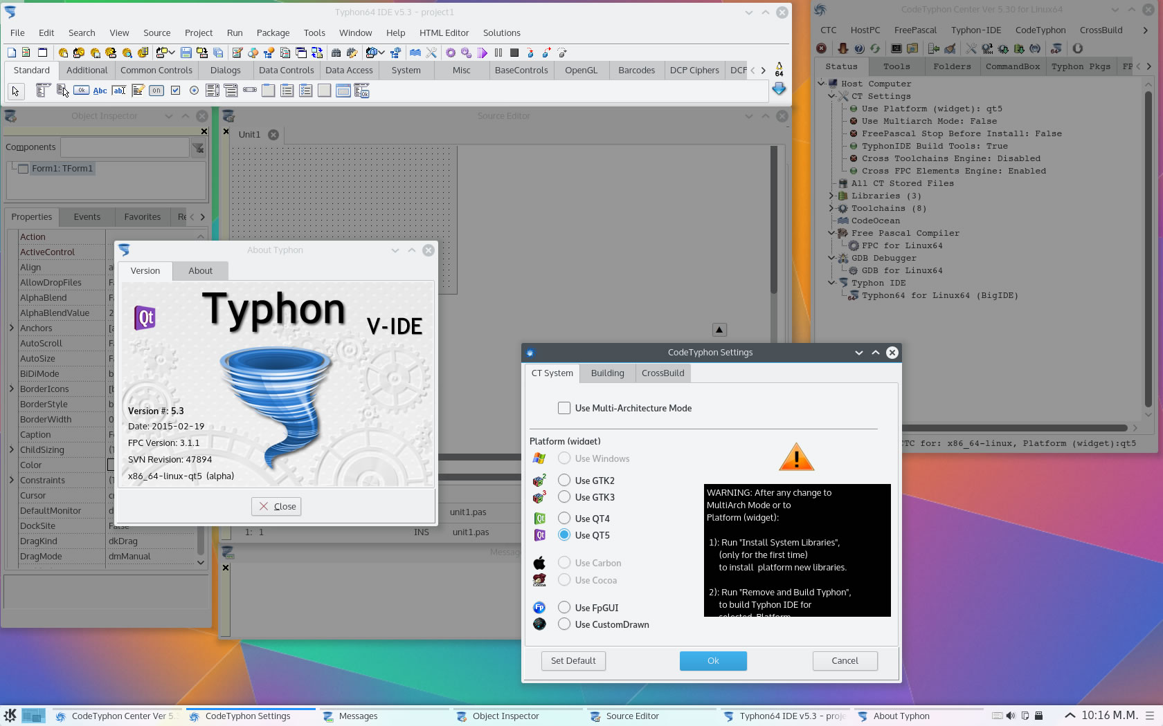

Screen1: from Windows CT Setup script and CTCenter=>Settings Dialog
it's the same functionality....
Screen2: Kubuntu 15.04 (alpha 2) with KDE plasma 5 (QT5)

Hello Sternas and thanks for answer.
Hum, i have updated last Codetyphon v 5.3.
Everything works fine ;-)
But when i tried to re-compile Typhon IDE with fpGUI widgetset...
It compiles but when trying to run it => I get the typhon splash screen and then => crash.
All is blocked and i have to re-boot (using power button).
I use Linux Mint 64 bit.
Fre;D
CT LAB ver 5.30 11 years 8 months ago #6881
To build the TyphonIDE for a platform is NOT so simple
we must work on fpGUI platform ( or widgetset)
But you can build applications for fpGUI platform and this is a fact.... :)
Our plan for CT 5.3 is to build TyphonIDE for QT5, with small problems...until now.
We will leave build TyphonIDE for fpGUI and Customdrawn for next CT 5.4,
I don't have programmers for this task now (CT5.3)....
