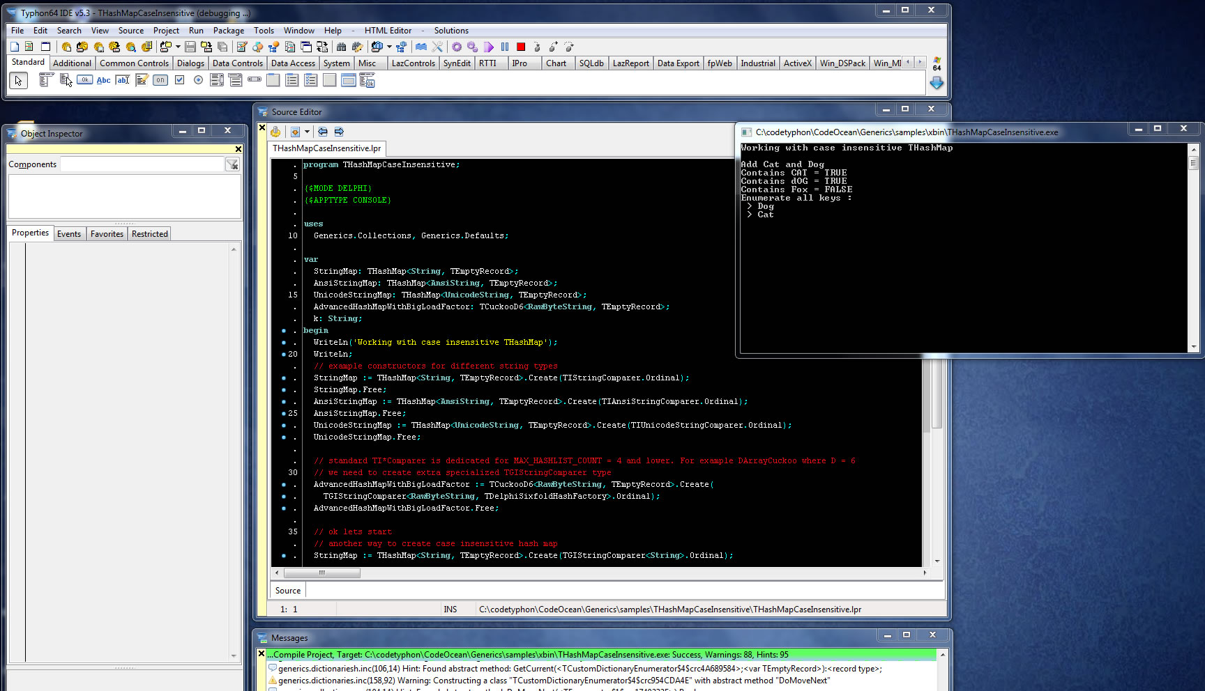

CT LAB ver 5.30 11 years 8 months ago #6678
We finish Step 1 and 2 of LAB Task50 "ADD Generics Collections support" (Total Steps 3)
Step1-Generics Collections on Windows 32 and 64bits 100%
Step2-Generics Collections on Unix 32 bits (Linux, FreBSD, Solaris etc) 100%
Remain Step
Step3-Generics Collections on Unix 64 bits (Linux, FreBSD, Solaris etc)
screen from Win7-64
