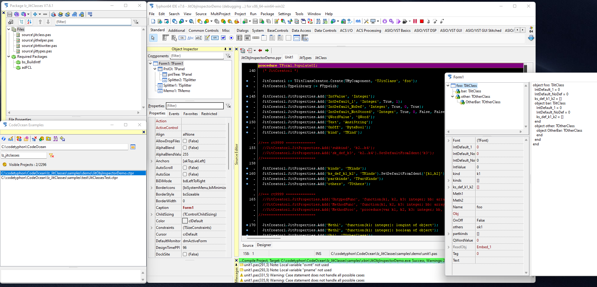

Demo app crashes at line 153 of the unit1.
Win8 x86_64 CT X86_64 7.6

Use this code from LAB CT
