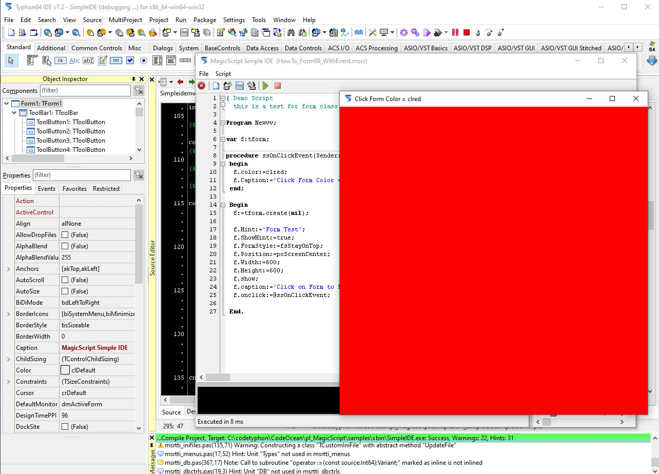

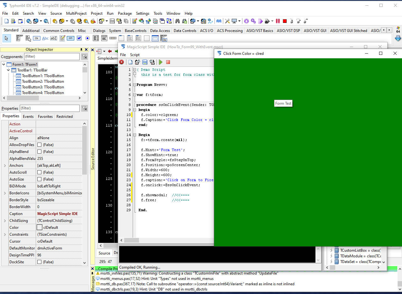

pl_magicscript 6 years 5 months ago #14785
TForm.Create is all ready register in the pl_MagicStript
did you look at
codetyphon\CodeOcean\pl_MagicScript\samples\01_SimpleIDE\ ?
did you test
codetyphon\CodeOcean\pl_MagicScript\samples\scripts\Forms\ sample\ ?

pl_magicscript 6 years 5 months ago #14787
Here, ALL samples in
directory working OK
Your OS ?
Your CT version ?
pl_magicscript 6 years 5 months ago #14788

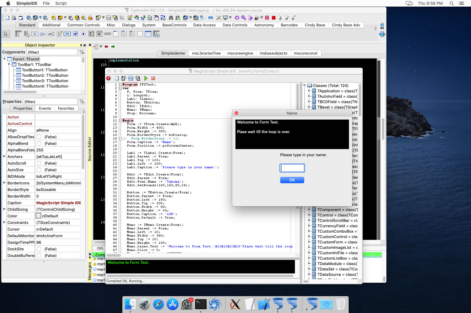

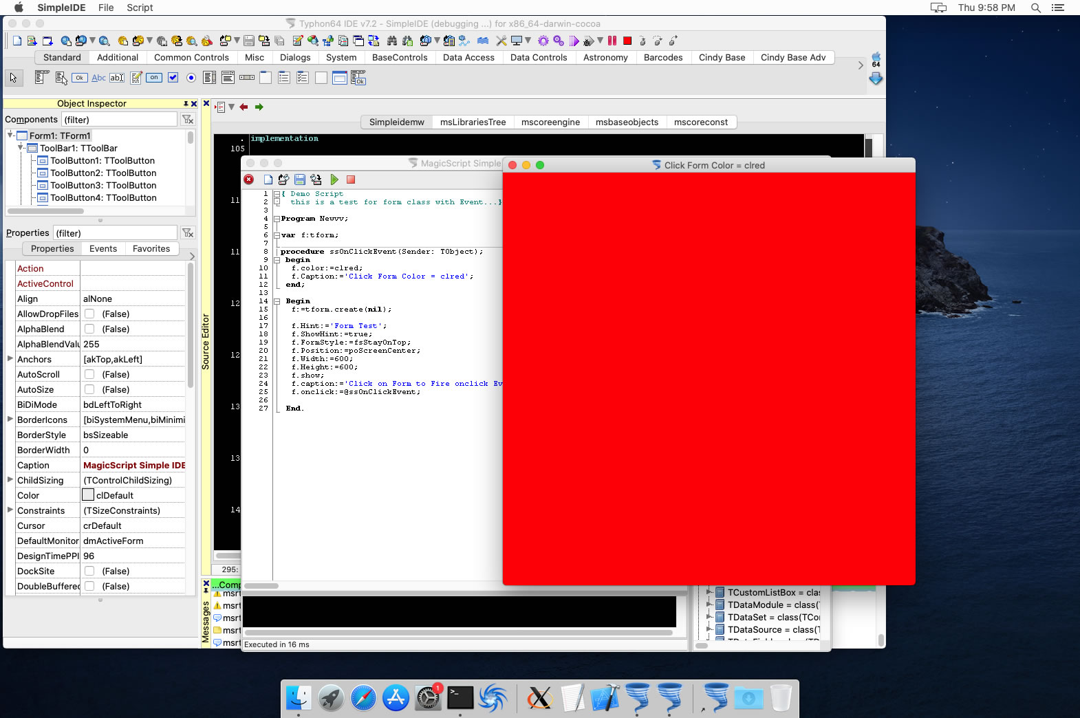

pl_magicscript 6 years 5 months ago #14789
I don't know, in our tests ALL are OK
Win64 ent
Win64 ent 2
MacOS 10.15.5
If you want I can screen pl_MagicScript samples to any CT Host OS.

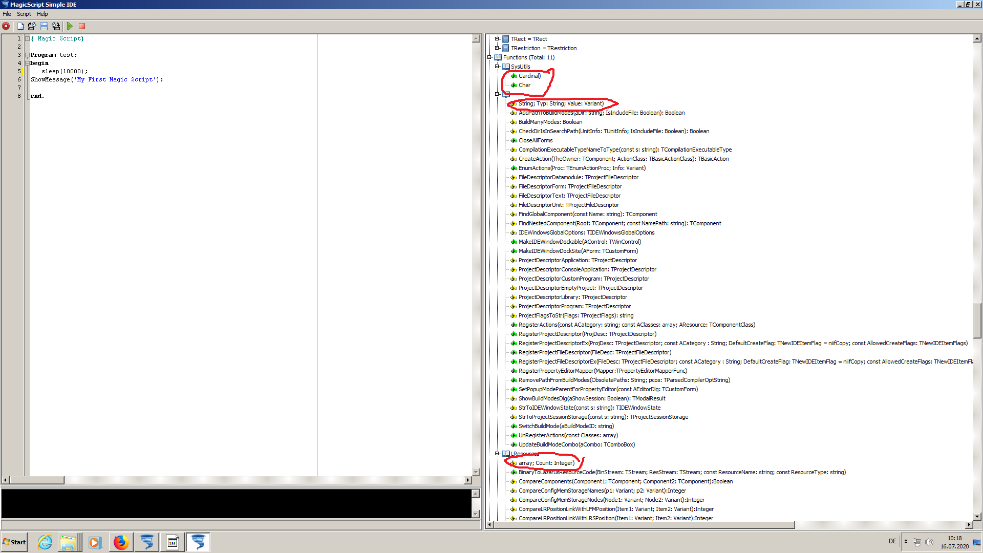

Hi folks,
There is another issue in the treeview. In the functions section the first entrance is not completely shown.
Thx

pl_magicscript 6 years 4 months ago #14893
  • LuZZZZi
  • LuZZZZi's Avatar Topic Author
  • Posts: 130
I saw that not all of the entrances in the functions section not fully viewed. I have added some "fresh" methods to register_classes function. See picture
