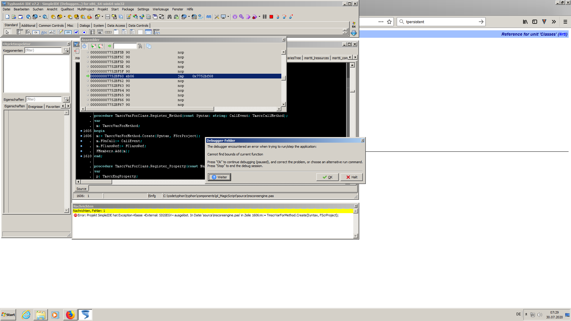

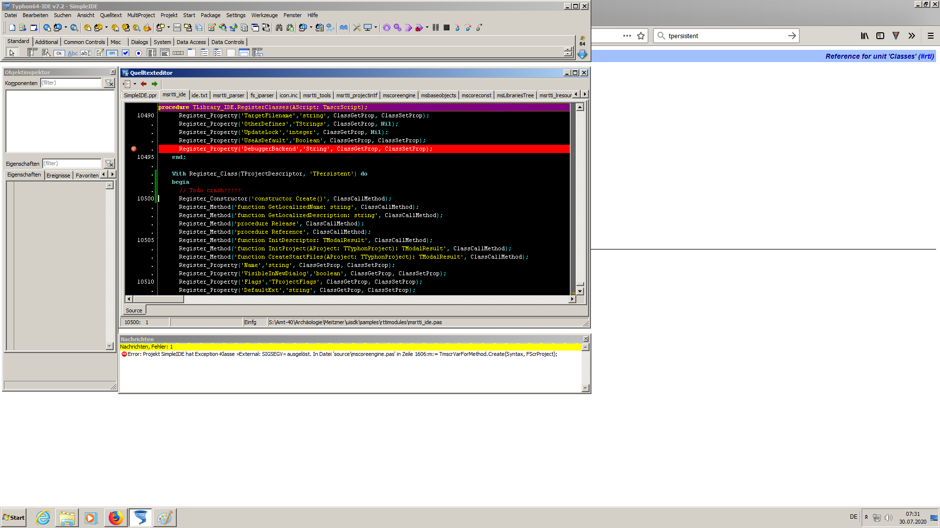

Hello Guys,
I do have a problem with this package. See pictures
I have checked for double definition but the program crashes every time. Do you have a tip how can I clear this behavior?
Thx
pl_magicscript 6 years 3 months ago #14936
  • LuZZZZi
  • LuZZZZi's Avatar Topic Author
  • Posts: 130
I have found that issue. I have made a double definition. Sorry.
