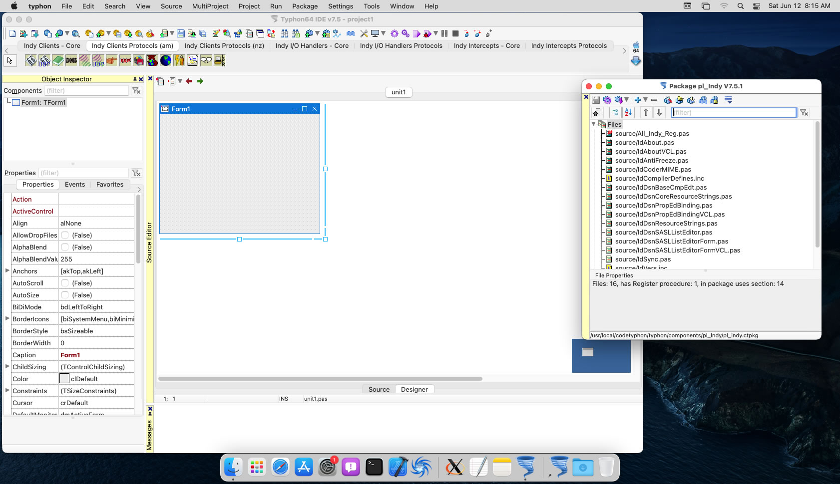

You can use and CTCenter=>Tools page=>"Typhon BigIDE Packages Setup"
Current LAB CT unreleased
MacOS 11.4
pl_indy 7.5.1
download this latest pl_indy from here
It's NOT so simple to support so big Packages/Libraries on MacOS
and we give a lot programming Hours/Days for this.

The only CT version support pl_Indy on MacOS is LAB CT ver 7.50.
We hope to port and pl_Synapse to MacOS.
For your info, LAB CT ver 7.50 support only MacOS 11.x Big Sur.

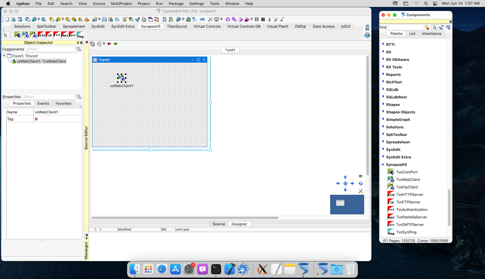

Finally we port and pl_Synapse to MacOS.
Now BigIDE has about 1695 components.
Current LAB CT ver 7.50 unreleased
MacOS 11.4
pl_Synapse 7.5.1 and pl_SynapseVS 7.5.1

I finally switched to Big Sur and CT v7.5 where Indy and Synapse componnents work well! Thank you for fixing it!
