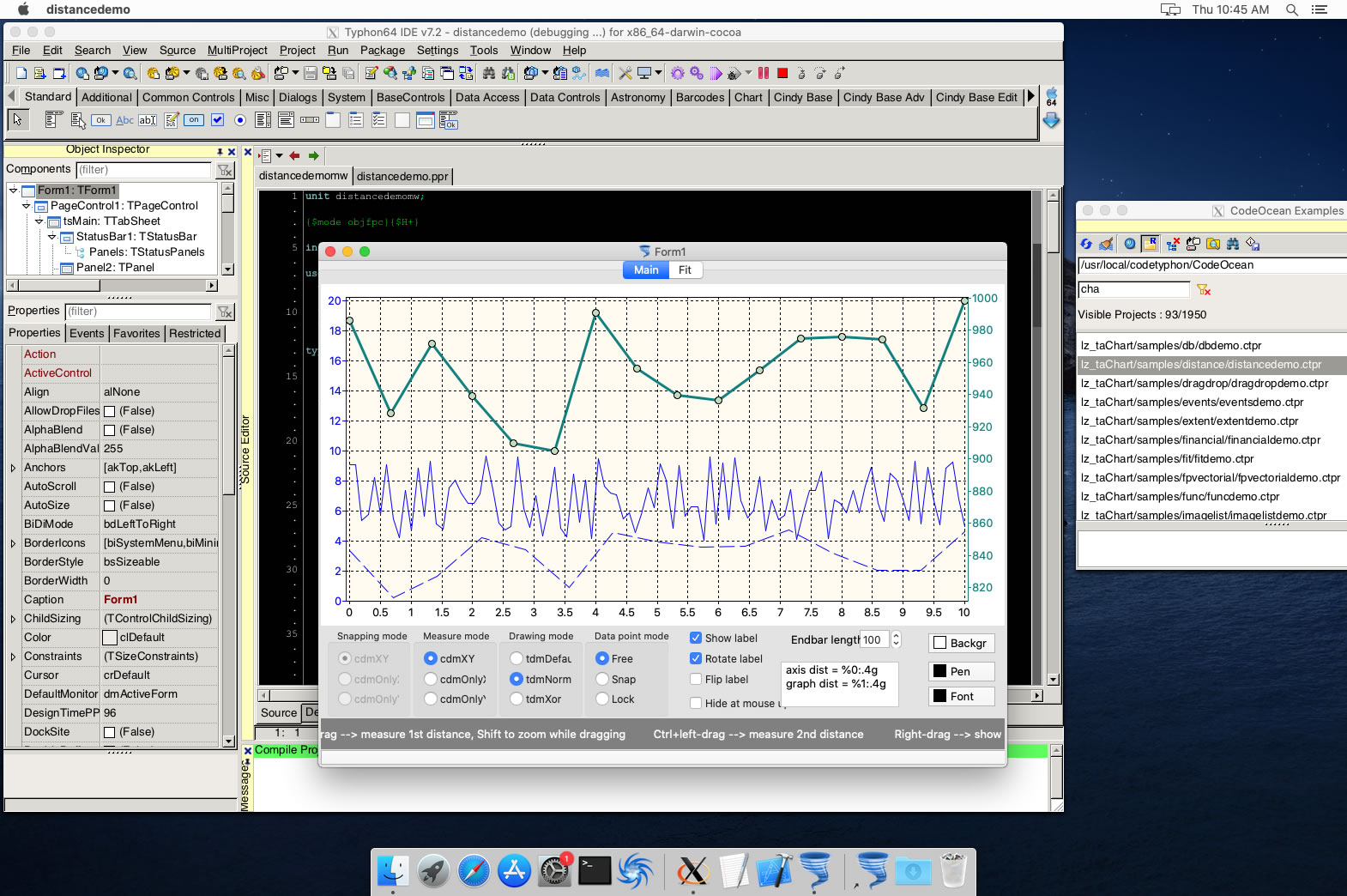

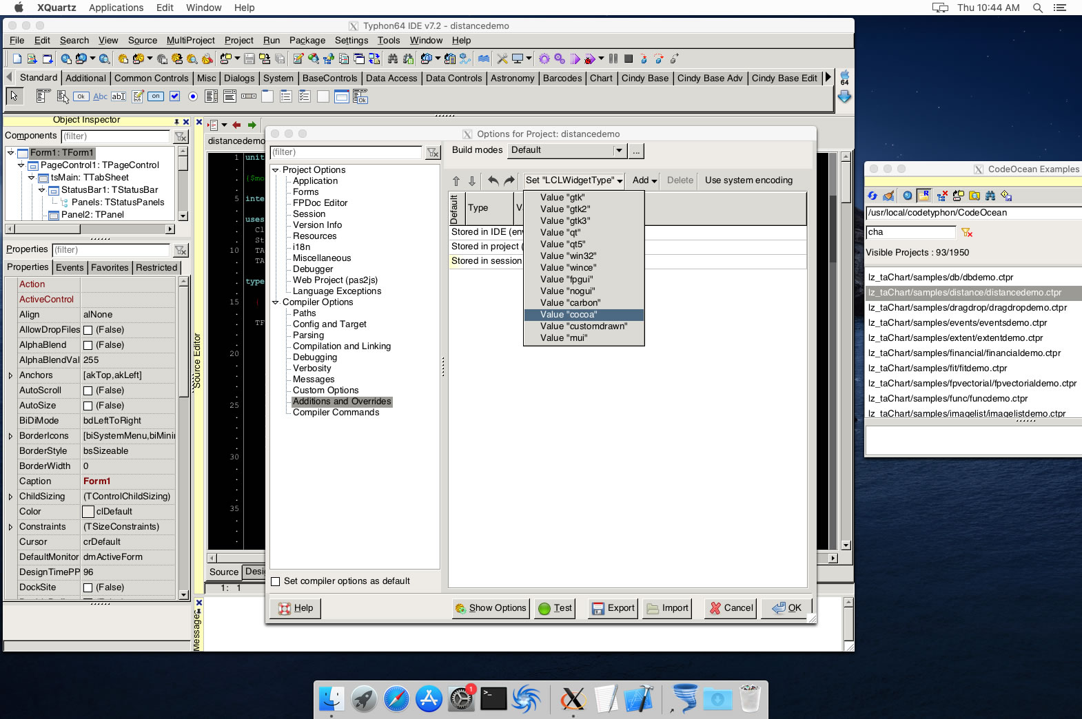

On MacOS you can build Typhon IDE for Cocoa and for GTK2 platforms
1) Cocoa as IDE platform has some problems, one of them is the maximum number of pkgs you can installed to Typhon IDE.
2) GTK2 as IDE platform don't has this problem.
So, you can try GTK2 Typhon-IDE and build app for Cocoa platform.
for sample we add to GTK2 Typhon-IDE lz_taChart pkg, rebuild the IDE and run a test from CodeOcean samples
for Cocoa platform.
Yes it's GTK2 Typhon-IDE => build Cocoa platform application on MacOS 10.15.5

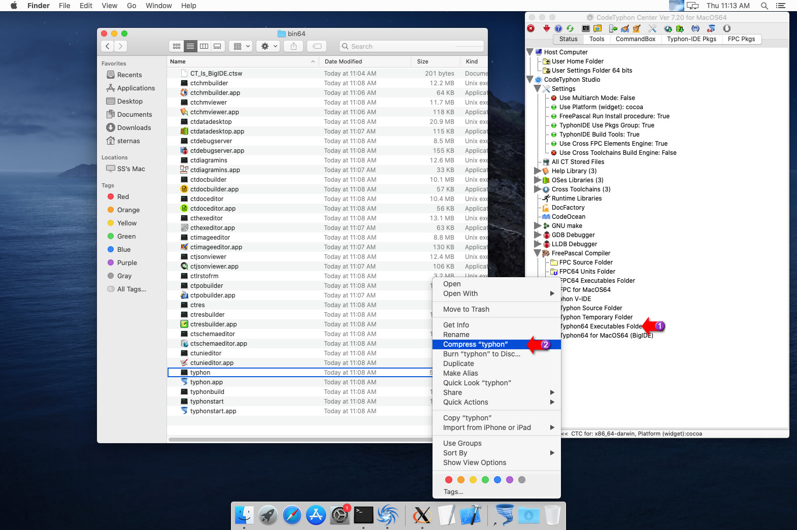

It's a good practice to "backup" a "good" Typhon IDE before Rebuild IDE
On MacOs just zip typhon executable and
unzip the good old IDE, if something go wrong with the new IDE

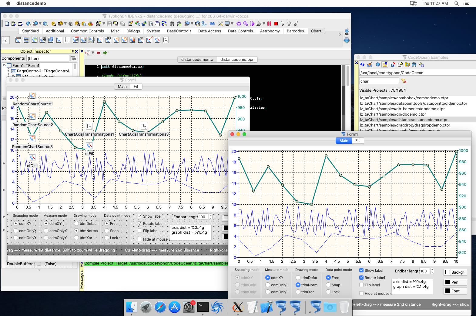

We build Typhon-IDE for Cocoa platform on MacOS 10.15.5 (4-Cores / 8 Gbyte RAM / 120 Gbyte SSD)
we add lz_taChart pkg to IDE,
we rebuild the IDE and
run the same test above from CodeOcean samples
for Cocoa platform without problem
