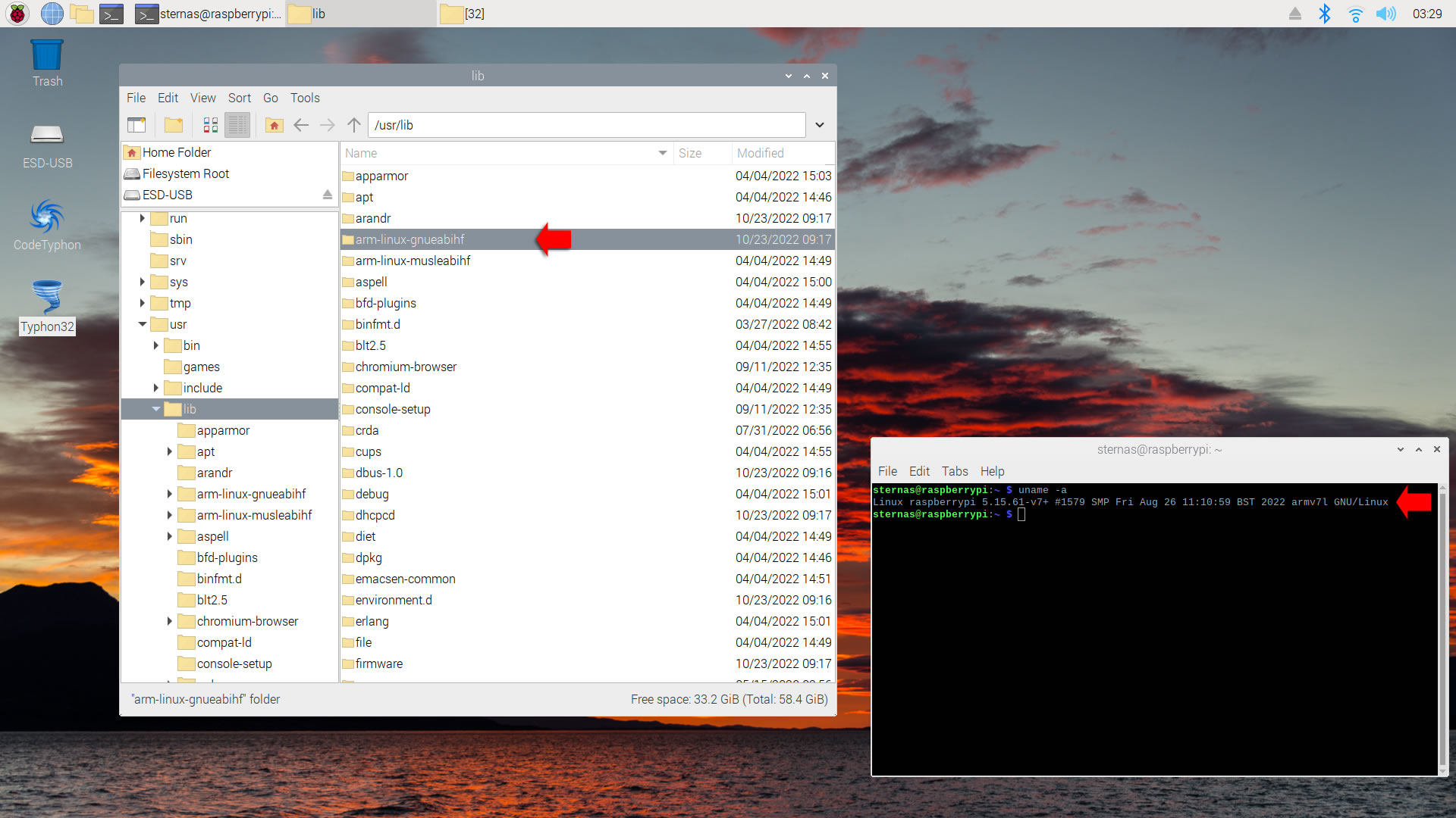

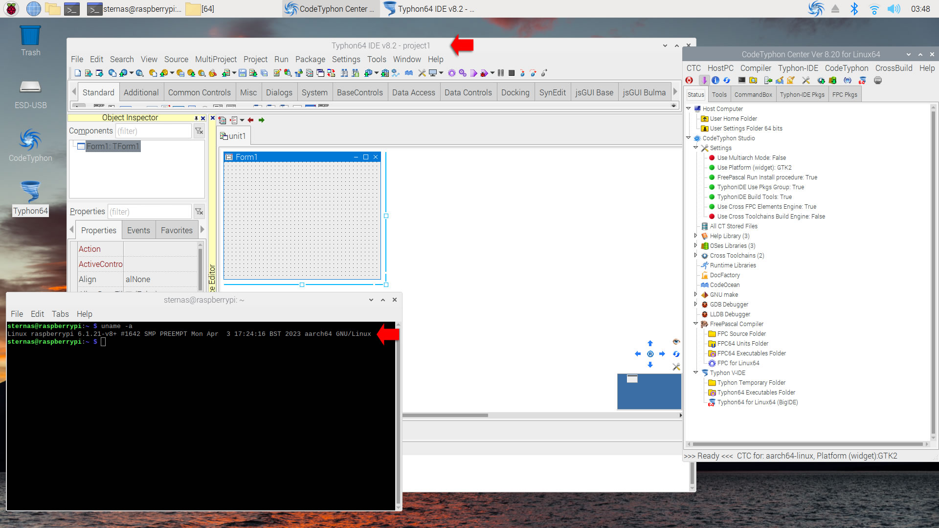

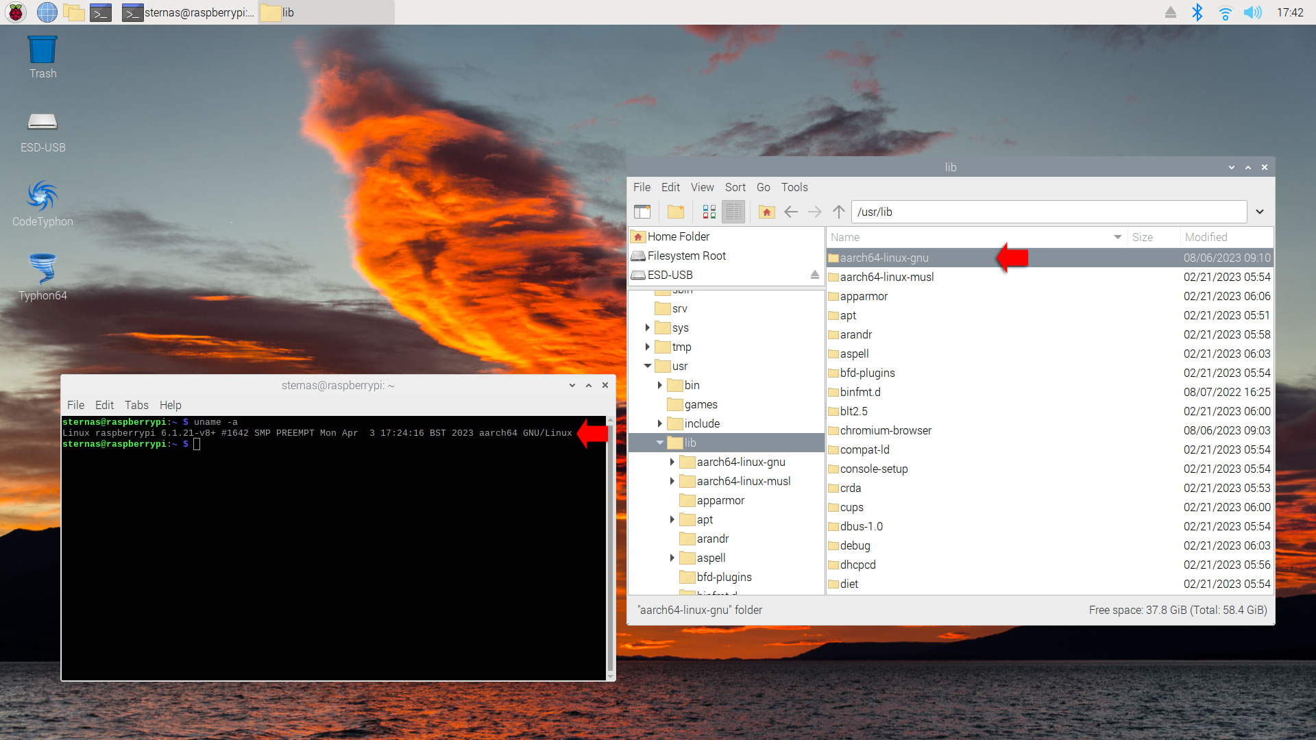

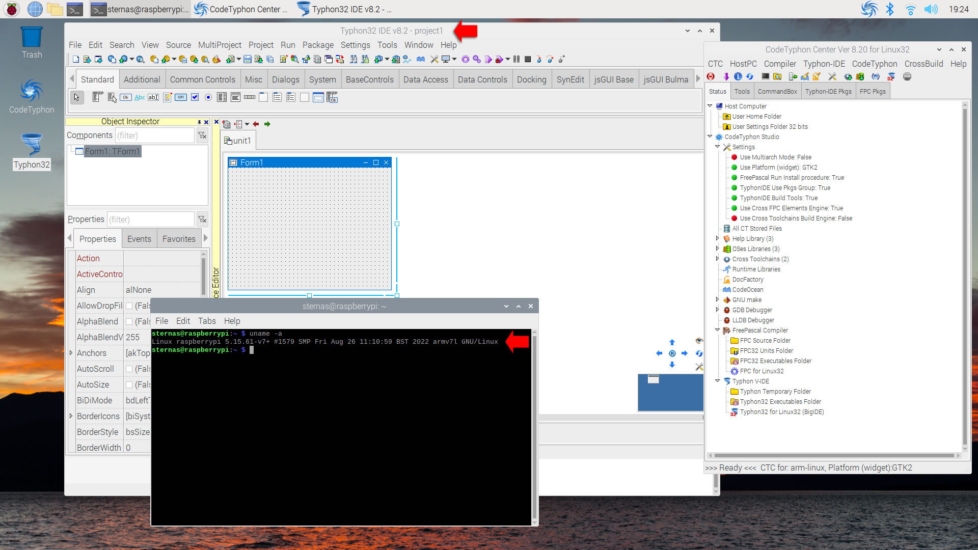

We test CodeTyphon on PI4 with the latest OSes:
32 bit here
File: raspios_full_armhf-2023-05-03
64 bit here
File: raspios_full_arm64-2023-05-03
Screens:
32 Bits OS
and 64 Bits OS
Always you can "Build ALL" with CTCenter and attach zip actions log file here.

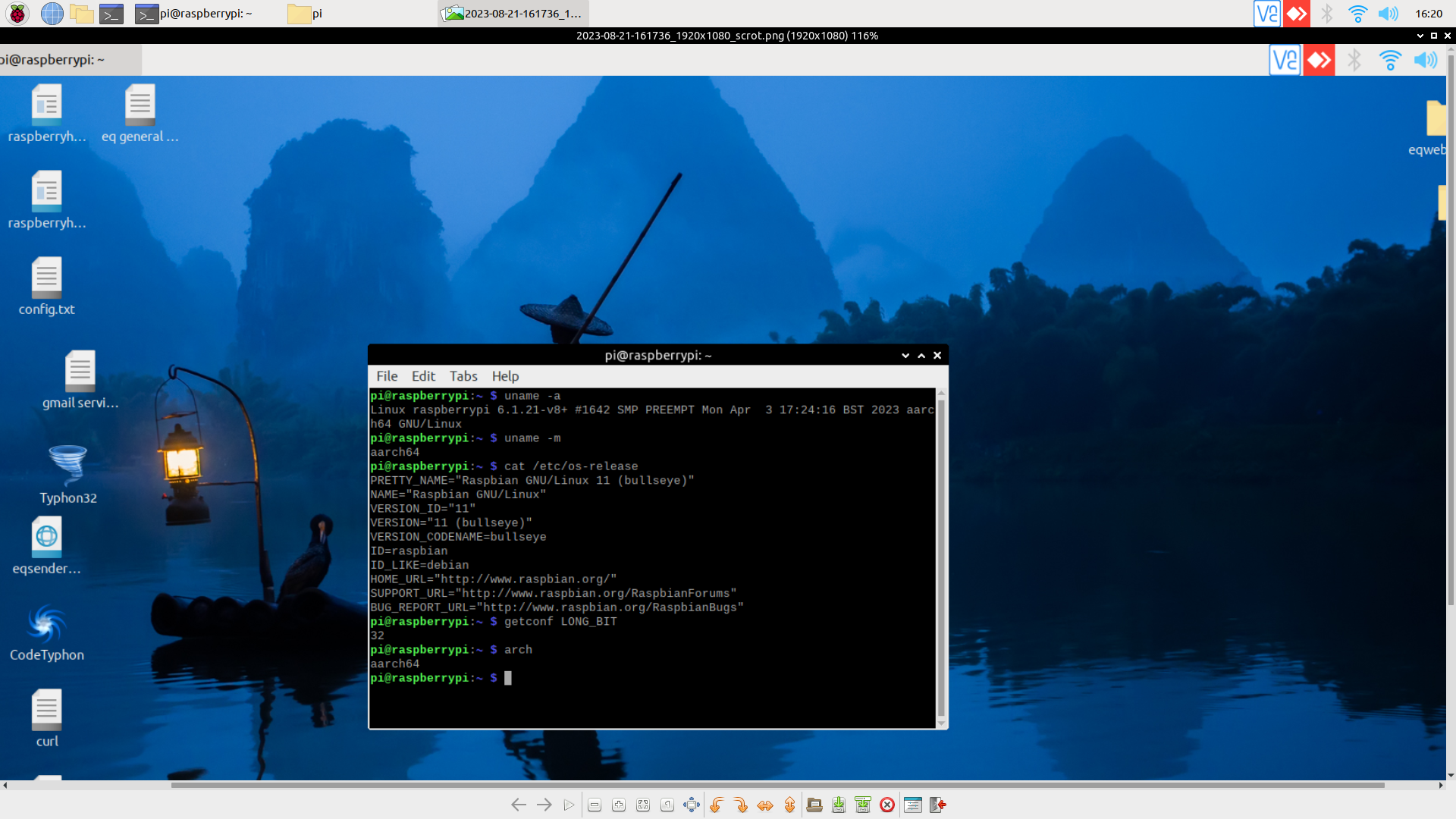

I am not experienced in Linux systems so i am confused trying to discover if my system is 32 or 64 bit .
Have got any idea ?

Cannot install CT 8.1 on Raspberry 3 years 1 month ago #17971
Your system with uname -a report aarch64
so is 64Bit OS.
The 32Bits OS with uname -a report armv7l
Look in my screens above.
PS: CodeTyphon has MultiArch ability on Arm64 OSes
Cannot install CT 8.1 on Raspberry 3 years 1 month ago #17980
  • George Christodoulou
  • George Christodoulou's Avatar Topic Author
  • Posts: 17
I installed 32 bit version of of Raspberry OS but 64 bit kernel is also present.
The Pi 4/400 firmware now prefers the 64-bit kernel if one exists.
That is why Codetyphon ''sees'' 64 bit
Setting arm_64bit=0 to   /boot/config,txt  file forces OS  to use the 32-bit kernel.
Thanks for your help.
