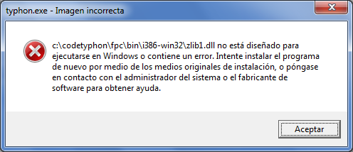

the library zlib1.dll is corrupted, and and I've seen, that does not find other libraries

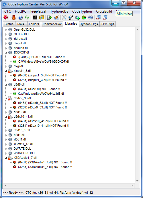

Sir On Win7 64
the CT installation is very simple
a)-Install system libraries info here
b)-log in in Windows as user with Administrator Privileges info
c)-Remove any previews Lazarus and FreePascal Installations
Now:
1)-Remove manual C:\codetyphon directory
2) unzip in any place CodeTyphonIns.zip
3)-Go to new CodeTyphonIns directory
4)-Simple double click on install.bat, not as Administrator etc
if this NOT work, please check your PATH files, your PC Configuration, Antivirus etc

Using CT since version 3 installation never failed me so far.
  1. I tried putting in the path to start.
  2. Run install.bat as administrator and non-administrator.
  3. Remove the antivirus.
  4. Remove access control.
  5. 64bit Windows if
  6. I did everything and just fails.
Demoniac, Win7!!!!
Uso CT desde la version 3, nunca me falló la instalación hasta ahora.
Probé poneindo en el path al comienzo.
Ejecutar install.bat como administrador y no administrador.
Quitar el antivirus.
Quitar el control de acceso.
Windows si es de 64bits
hice todo e igual falla. Maldito Win7.
