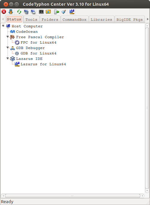

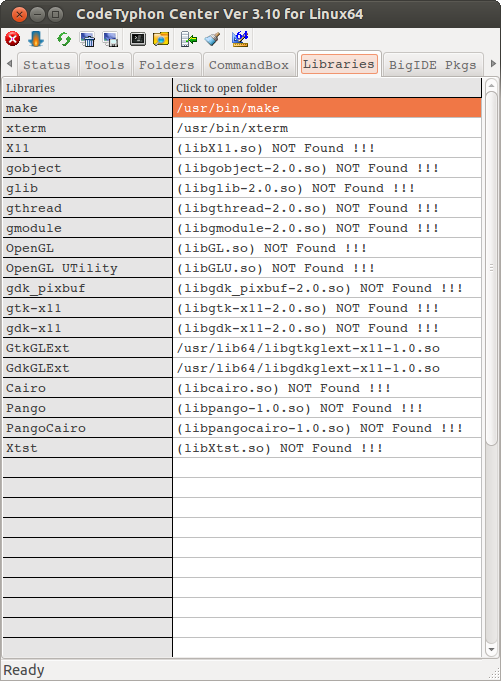

I add 2 images of CodeTyphon Center: Status and Libraries. In status missing rows and in libraries many lines it says NOT FOUND.
My English sentences are generated by "Google Translate".

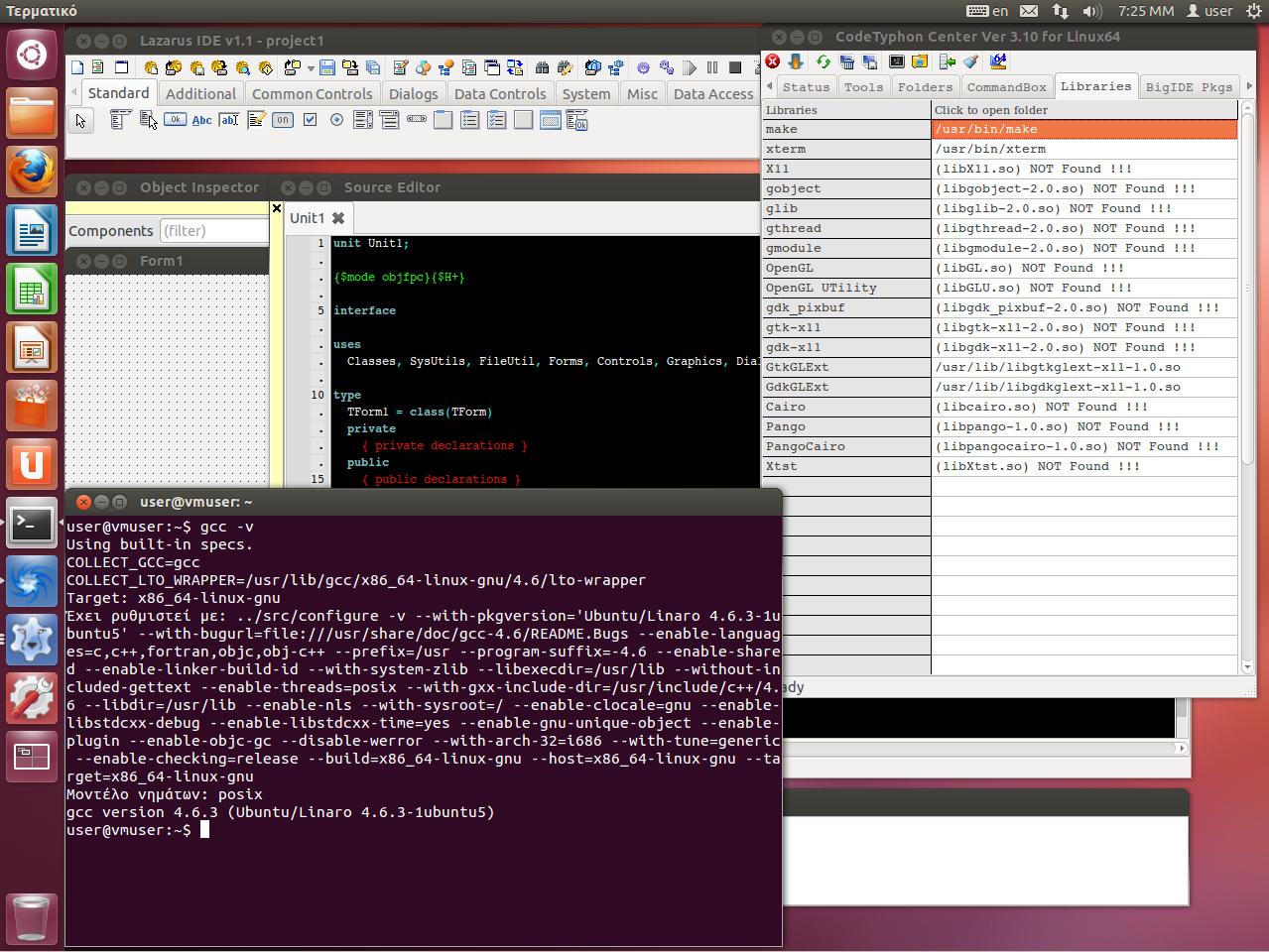

Ubuntu12.4 CT3.10 -> Lazarus64 BIG IDE NOT Build 13 years 4 months ago #2880
  • Manos S. Pappas
  • Manos S. Pappas's Avatar
  • Posts: 69
I am really puzzled with this compilation behaviour; I have installed CT 3 on Kubuntu 12.4/12.10 x64 without issues and currently I'm using it on Arch x64 (upgrade to CT 3.10 done this Monday).
Could it be - regarding the missing libraries you mention - that your Ubuntu installation needs updating? I can try installing Ubuntu 12.10 on a Virtualbox VM to test.
Best Regards,
Manos S. Pappas
Ubuntu12.4 CT3.10 -> Lazarus64 BIG IDE NOT Build 13 years 4 months ago #2884
  • Michele
  • Michele's Avatar Topic Author
  • _-*-_ Forgive my English.
  • Posts: 16
In this list many Libraries are NOT Found !!!.
This can be a problem?
Last edit: by Michele.

Help, please, i have the same problem of "libraries not found".
Im using CodeTyphon 3.1 on Ubuntu 12.04 32 bits.
Ubuntu12.4 CT3.10 -> Lazarus64 BIG IDE NOT Build 13 years 4 months ago #2893
  • Posts: 4618
  • Thank you received: 1131
This is "normal" Sir
for Ubuntu Linux

1. Installed Ubuntu 12.04 x86_64 version using a VirtualBox VM (2GB RAM, 2 Cores).
2. After installation a full system update was performed (about 160MB of updates). Reboot.
3. Started CodeTyphon install.sh script from a command prompt as a regular user (i.e no sudo or su).
4. Selected option "1. Install System Libraries". The script completed without errors.
5. Selected option "0. Install CodeTyphon" and then from the build menu chose "8. Remove and build ALL".
Lazarus Small IDE was built, executables stripped. Then Lazarus BigIDE built, external tools built, executables were stripped.
Everything worked fine, see attached picture.
The fact that there are missing libraries in CodeTyphon Control Centre does not cause any problem with the compilation.
The only thing I can recommend is to remove CodeTyphon completely, fully update your system and try installation again.
Ubuntu is known for notorious patching of packages (i.e it's an easy to install distro but does not work well with third-party packages like CodeTyphon), breaking package compatibility.
Best Regards,
Manos S. Pappas
