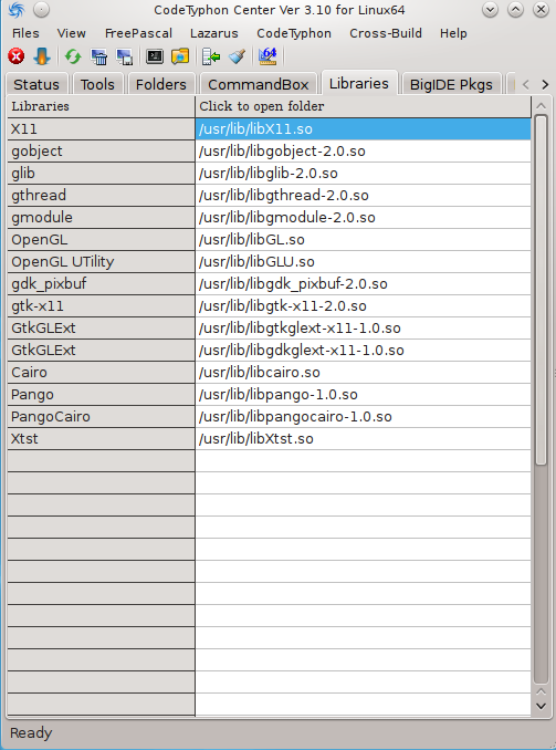

Probably it's Ubuntu, because under Arch Linux x64 the libraries are found (see screeshot).
Ubuntu is probably the less compatible distribution for using third-party applications, especially ones with insane complexity like Codetyphon.

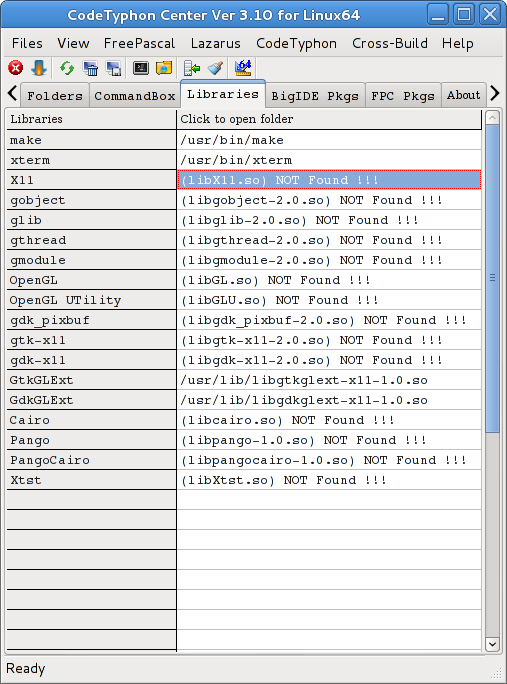

In my Debian Sid I see the attached picture, but a locate give that :
du@pc-du:~$ locate libX11.so
/usr/lib/i386-linux-gnu/libX11.so.6
/usr/lib/i386-linux-gnu/libX11.so.6.3.0
/usr/lib/x86_64-linux-gnu/libX11.so
/usr/lib/x86_64-linux-gnu/libX11.so.6
/usr/lib/x86_64-linux-gnu/libX11.so.6.3.0
du@pc-du:~$
I precise that the Lazarus BIG IDE seems to compile and run perfectly but I do not yet perform big stress tests.
In my distribution libXxf86vm as the name libXxf86vm1
I hope it can encourage reflection.

#-Fu~/fpc/packages/base/*/units/;~/fpc/fcl/units/;~/fpc/rtl/units/
# searchpath for libraries
#ifdef cpux86_64
-Fl/usr/lib/gcc/x86_64-linux-gnu/4.2.3
#endif
#ifdef cpui386
#endif
#-Fl/pp/lib
#-Fl/lib;/usr/lib
# searchpath for tools
-FD/usr/lib/codetyphon/fpc/bin/$FPCTARGET
-FD/usr/lib/codetyphon/fpc/bin/x86_64-linux/
My English sentences are generated by "Google Translate".
Last edit: by Michele.
Ubuntu12.4 CT3.10 -> Lazarus64 BIG IDE NOT Build 13 years 10 months ago #3054
  • Michele
  • Michele's Avatar Topic Author
  • _-*-_ Forgive my English.
  • Posts: 16
I have updated Ubuntu (not upgrade).
After that I tried again to install CT.
All OK!
But I'm supposed to be happy?
