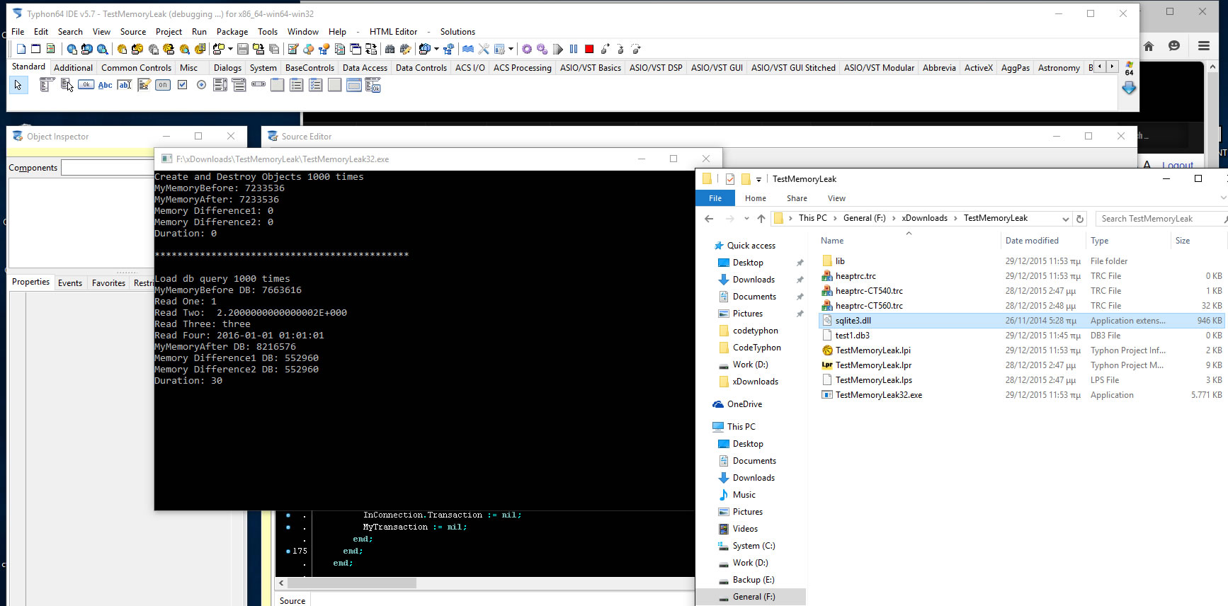

I wrote program which can reproduce memory leak in CT560.
Good thing is that memory leak is connected to database application and not to plain fpc applications.
Program first test creation and destruction of 1000 plain objects. This part is OK.
Second part is query SQLLite database - this part produce memory leak in CT560, but CT540 is OK.
I put heaptrace.trc files so you can see.
I also checks sqldb.pp and found some changes, but I do not think this is problem.
Problem is probably somewhere in TFields components of sqldb system.
Project is compiled for Win32. I use Win32 CodeTyphon.
Regards, Dinko

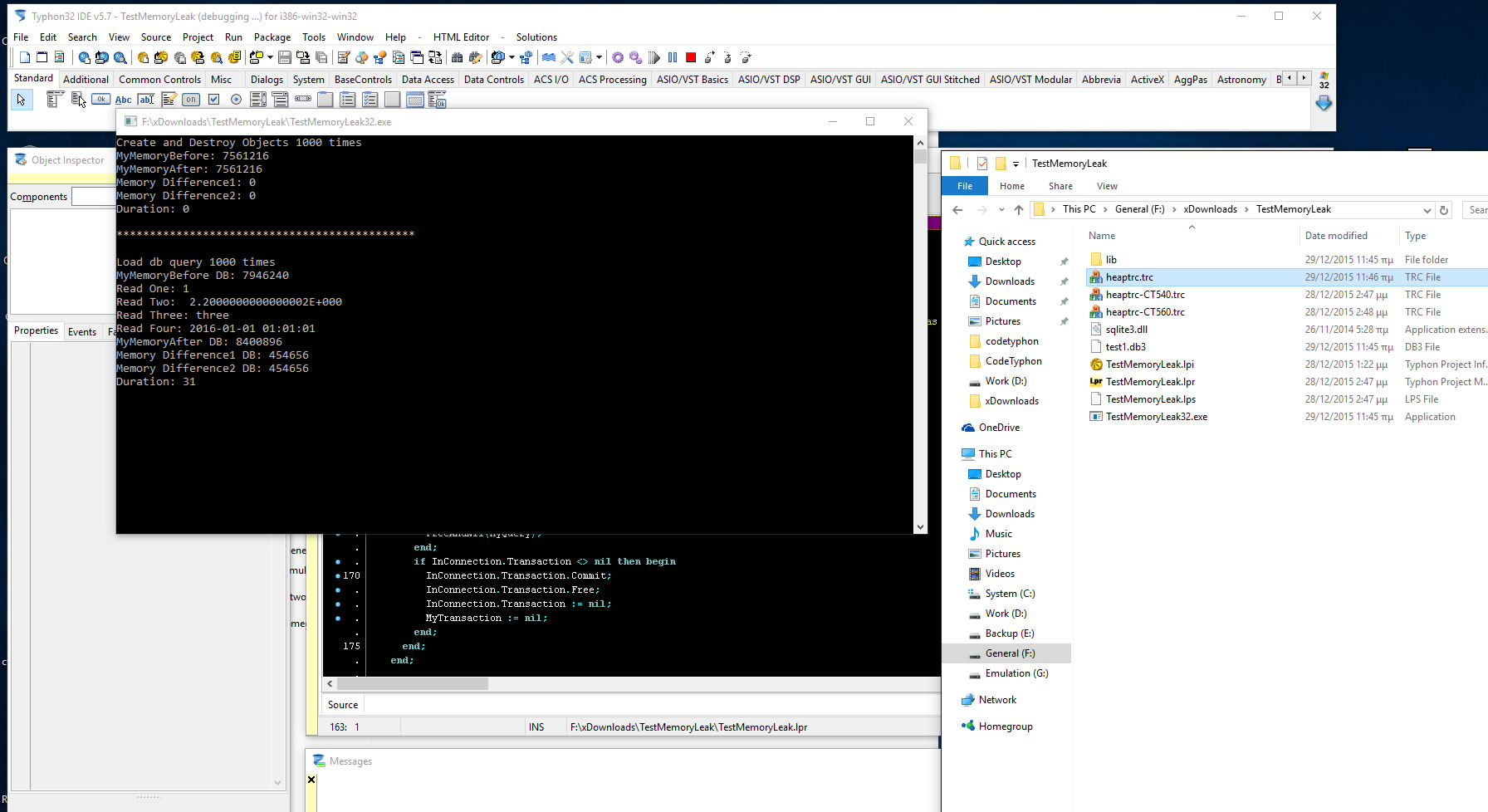

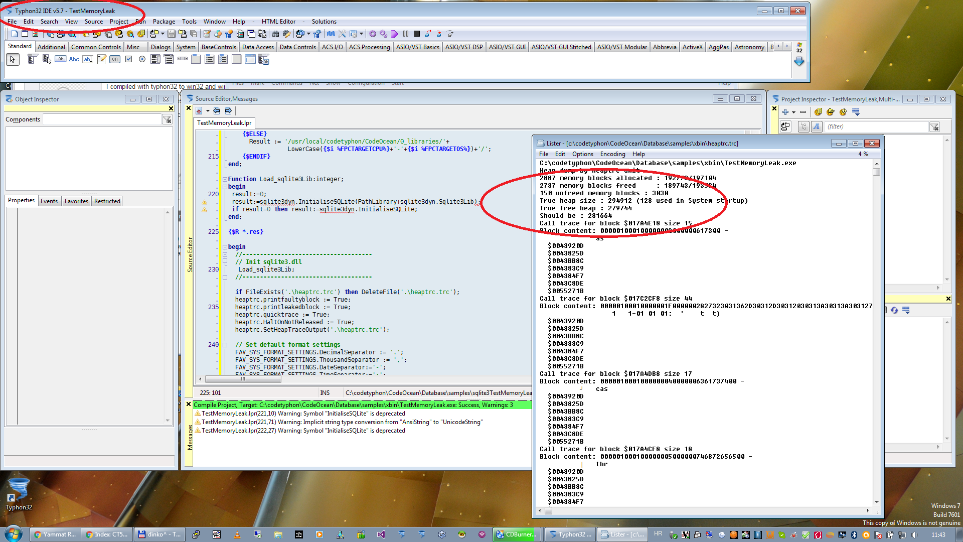

I installed update for CT570. Installed succesfully *** CT LAB 5.7.0 Revision 005610 Actions ***
Unfortunately leak still exists.
I compiled with typhon32 to win32 and win64. Same error exists like in CT560 build 005600
Check out attached picture.
Also I updated query in test program so it use query params (so I can check params leaks)
To find leak use heap trace after program regularly finish (dont check memory print on standard output)
Regards, Dinko

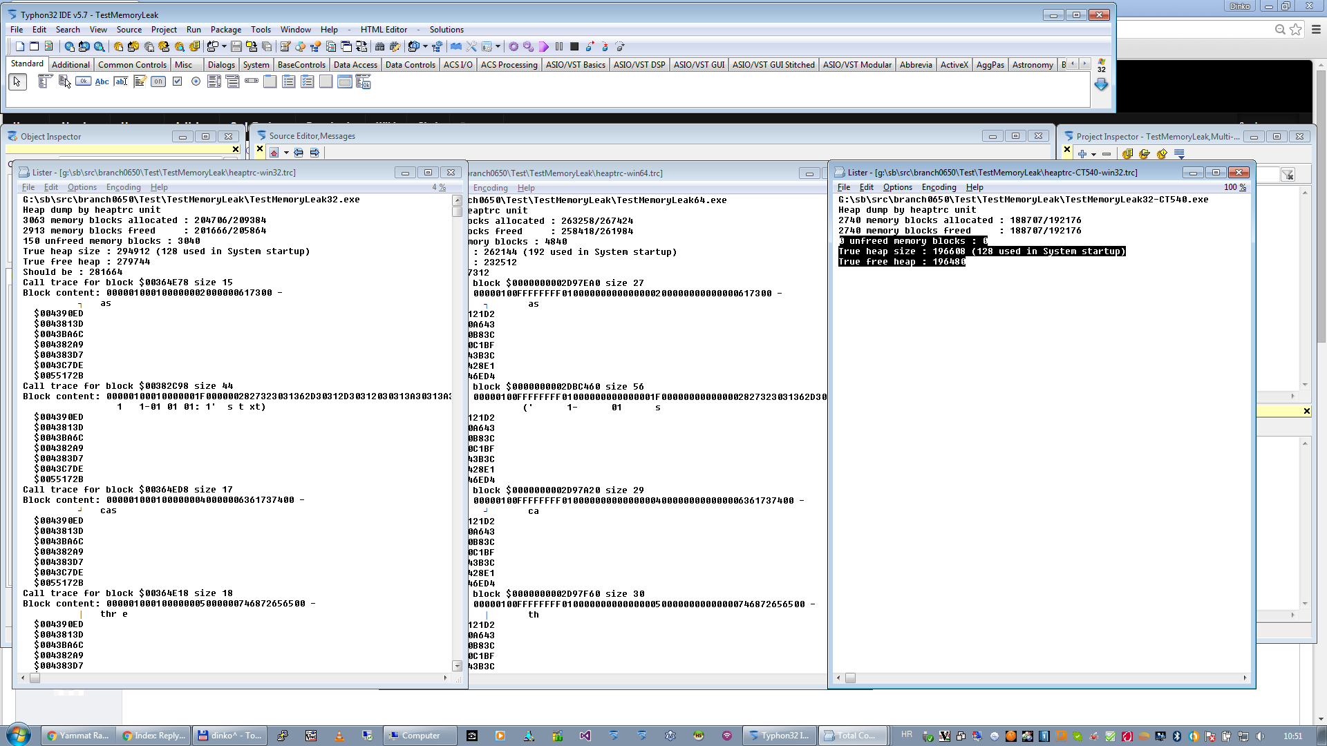

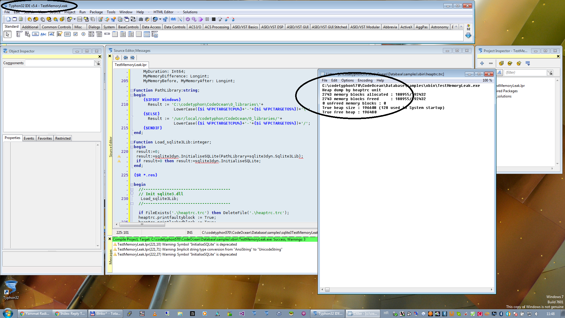

CT560 MemoryLeak - ProjectExample 10 years 9 months ago #8802
Sir, here in our lab we have the same result as my review post
I can't give more help
CT560 MemoryLeak - ProjectExample 10 years 9 months ago #8803

Application must finish regulary (press some key at the end). After that heaptrc.trc file will be written.
Then you check heaptrc.trc file and see if there is some memory unreleased.
Can you, please, do that again and attach screenshot of heaptrc.trc file
Regards, Dinko
