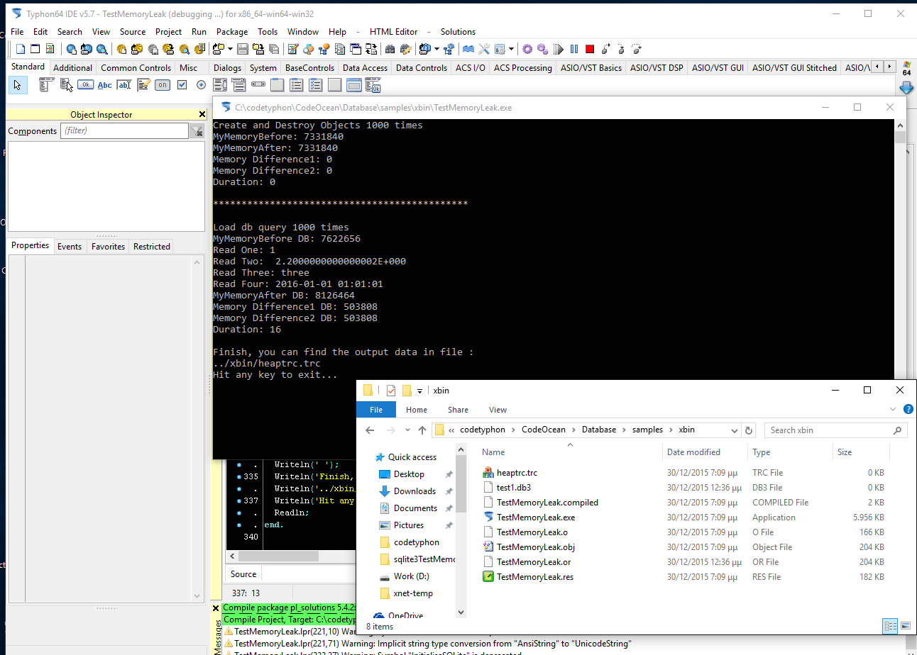

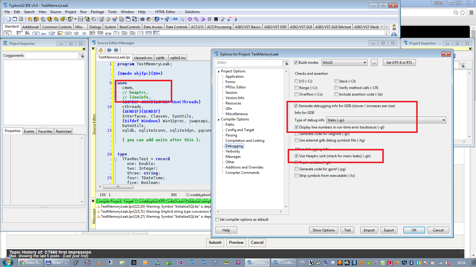

I managed to create false heaptrc report with 0 unfreed blocks. Checkout HeaptraceConfig.png configuration. Try and recompile and you will get 0 unfreed.
But, if you uncomment heaptrc after cmem statement in program unit, and uncheck Use heaptrc unit then you will get correct report.
According to picture you send I can tell that you did not press and key to finish program. When you press and key command prompt will appear (or black window will disappear) and heaptrc will be created.

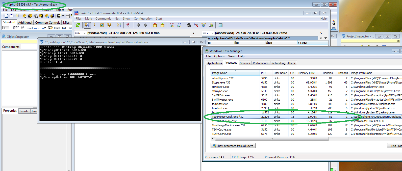

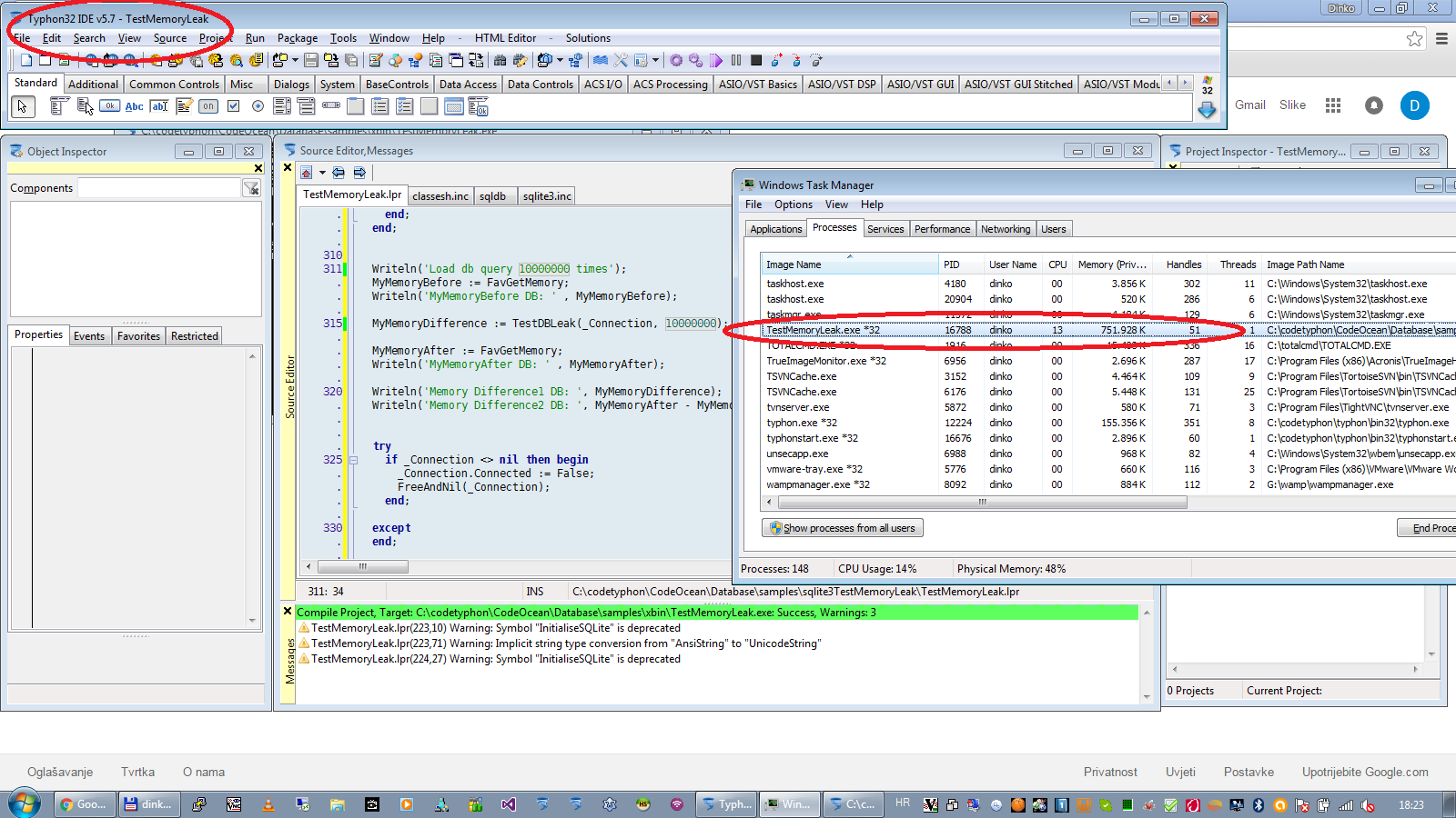

One more proof that something is wrong is TaskManager. I increase loop to 1000000 just to force program to run much longer, so I can look task manager. You can see that CT570 consumes lot of memory and CT540 almost nothing for the same source.
Sorry for badgering, but this is really important form me, and others. I think 99% of applications are somehow database connected.
Maybe someone other can confirm this behavior of CT570.. In attachment you can find latest source.
Regards, Dinko
Last edit: by Dinko. Reason: Change picture :-)
