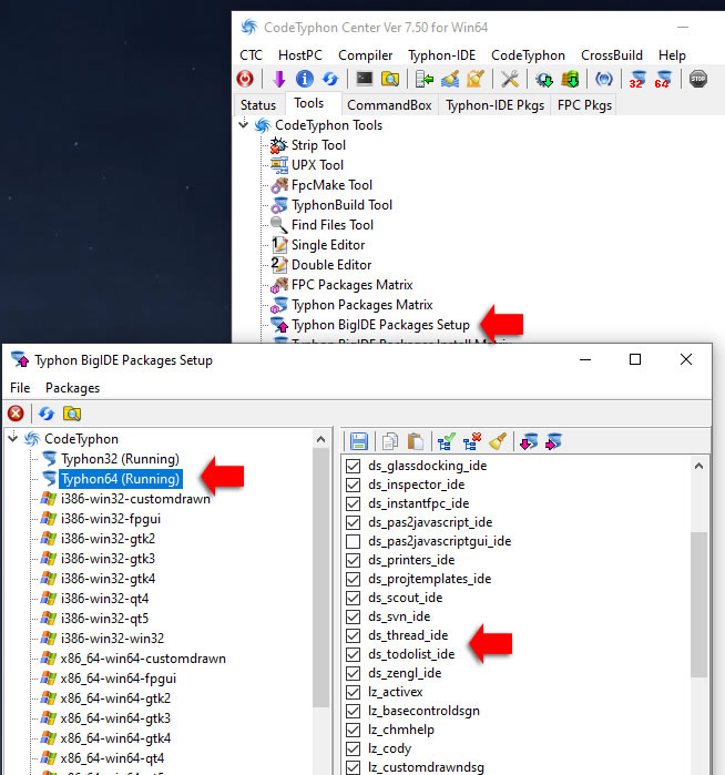

Now I did a number of reinstalls I really miss the possibility of selecting and compiling multiple packages in one go (especially in the 32-bit version which by default has only a number of packages installed).
Could you consider adding a selectbox per package in the "Package Files from List" window as a feature request for a next version, it would really speed up reinstalling packages?
Or is there already a simple way to select multiple package for installation in one run?
(There is the Install/Uninstall packages of course but via the list there is no such possibility)
Last edit: by Jan Roza.
CT LAB ver 7.40 5 years 6 months ago #15824
  • Posts: 1447
You can use CTCenter=>Tools page=>"Typhon BigIDE Packages Setup"
to modify BigIDE Packages with checklist way
CT LAB ver 7.40 5 years 6 months ago #15825
  • Posts: 234
Thanks Matis!
I never thought to look in CT Center.
Man, CT has so many places where you can set up things!
Next round I will check this one.
CT LAB ver 7.40 5 years 6 months ago #15826

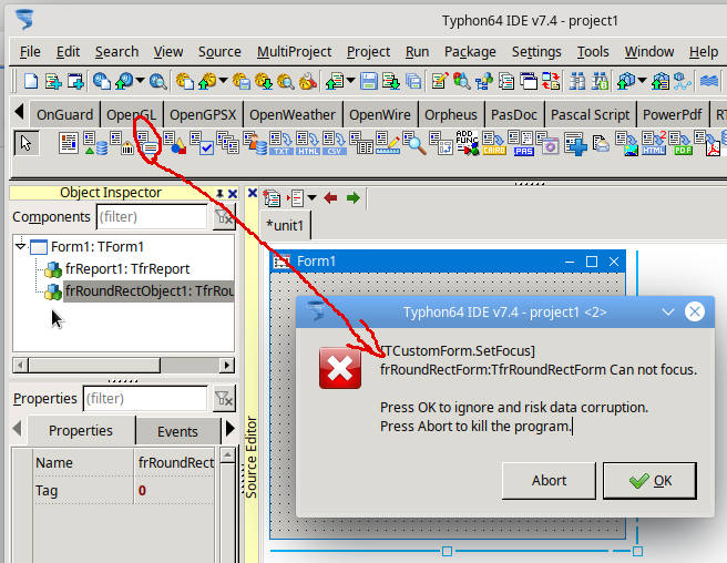

Thank you for your work! i use components: rxdbgrid, fpspreadsheet, sqldb(sqlite) - everything works ok. Little problem with lz_Report.
When trying to put an TfrRoundRectObject on the form, an error message takes off:
"[TCustomForm.SetFocus] frRoundRectForm:TfrRoundRectForm Can not focus.
Press OK to ignore and risk data corruption.
Press Abort to kill the program."
In a real task where it is used by clicking on OK, you can continue working and compile a project in which the object will function normally. there is no such error in version 7.3
My system Linux 4.19.0-16-amd64 #1 SMP Debian 4.19.181-1 (2021-03-19) x86_64 GNU/Linux
Best regards.
CT LAB ver 7.40 5 years 6 months ago #15856
  • Posts: 4646
we will test and try to fix this
