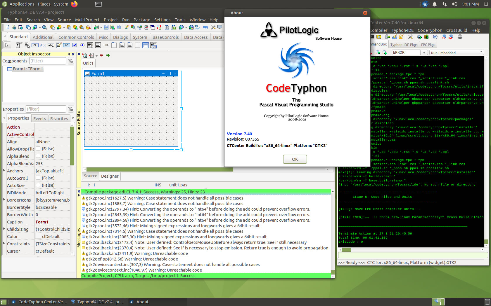

We release LAB CT Ver 7.40 Revision 007355
for this problem.
Tested on Win 10, Fedora 33, Debian 10.8 and Ubuntu MATE  20.10
Screen from Ubuntu MATE  20.10.

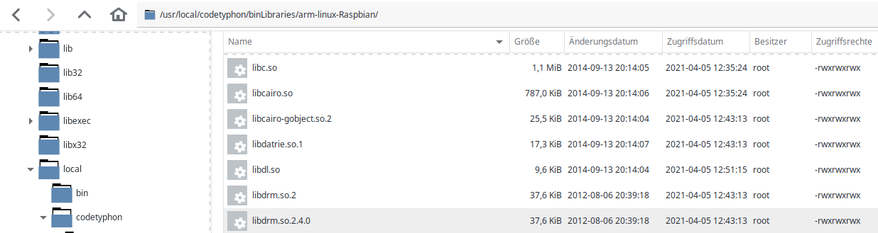

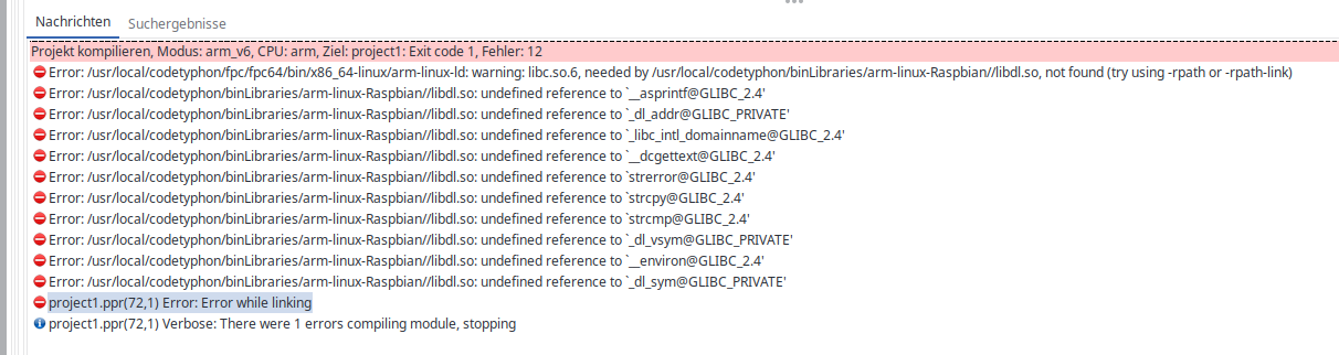

Is it possible that there is still an error in the area of cross-compilation with arm processors?
I get the error message: Error: /usr/local/codetyphon/fpc/fpc64/bin/x86_64-linux/arm-linux-ld: warning: libc.so.6, needed by /usr/local/codetyphon/binLibraries/arm-linux-Raspbian//libdl.so, not found (try using -rpath or -rpath-link)
but the file is available at the specified location.
