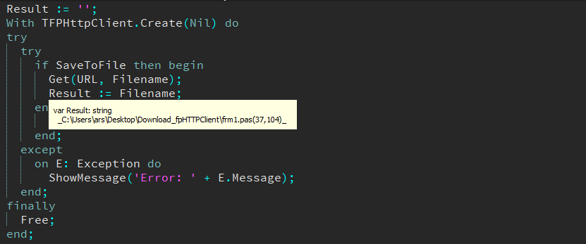

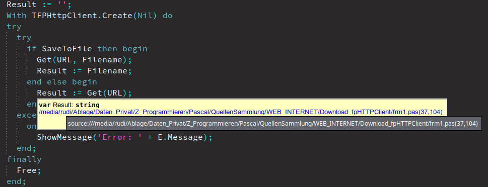

Hello everybody!
Where can I set the different behaviors of CT?
If I go over a variable under Linux, I can then jump to the declaration. See image behavior_Linux.png
If I go over a variable under Win7_32 it doesn't work. See image behavior_Win732.png
In both cases the latest version of CT is used.
I think it's just a matter of setup, but I can't find this point.

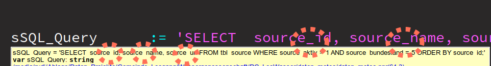

On Linux I noticed that the letters are slightly cut off at the bottom. (See image Debug.png)
