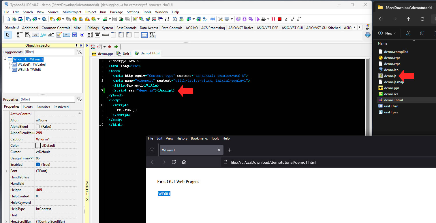

I have just joined the community and installed Code Typhone according to instructions, all went well. I am now trying the "First GUI Webproject" step by step example and is well, except when I hit the play button, the compilations etc. works fine and the Firefox Web browser displays but nothing on the screen, it is just blank.
Any pointers would be welcome, I have no idea how to troubleshoot or what to do now?

Yes, I did, exactly as per the example...why do I get blank screen then when I click on "play" button of IDE?

Hi, thx for taking a look, I attach the project here. :)
First GUI Webproject help needed 1 year 7 months ago #18860
  • Posts: 1434
  • Thank you received: 230
You rename the project and files but you forgot to
set the new  *.js file to
demo1.html
So, the web browser can't find the javascript file to run.
Not
<script src="project1.js"></script>
but
<script src="demo.js"></script>
at line 7 of demo1.html
