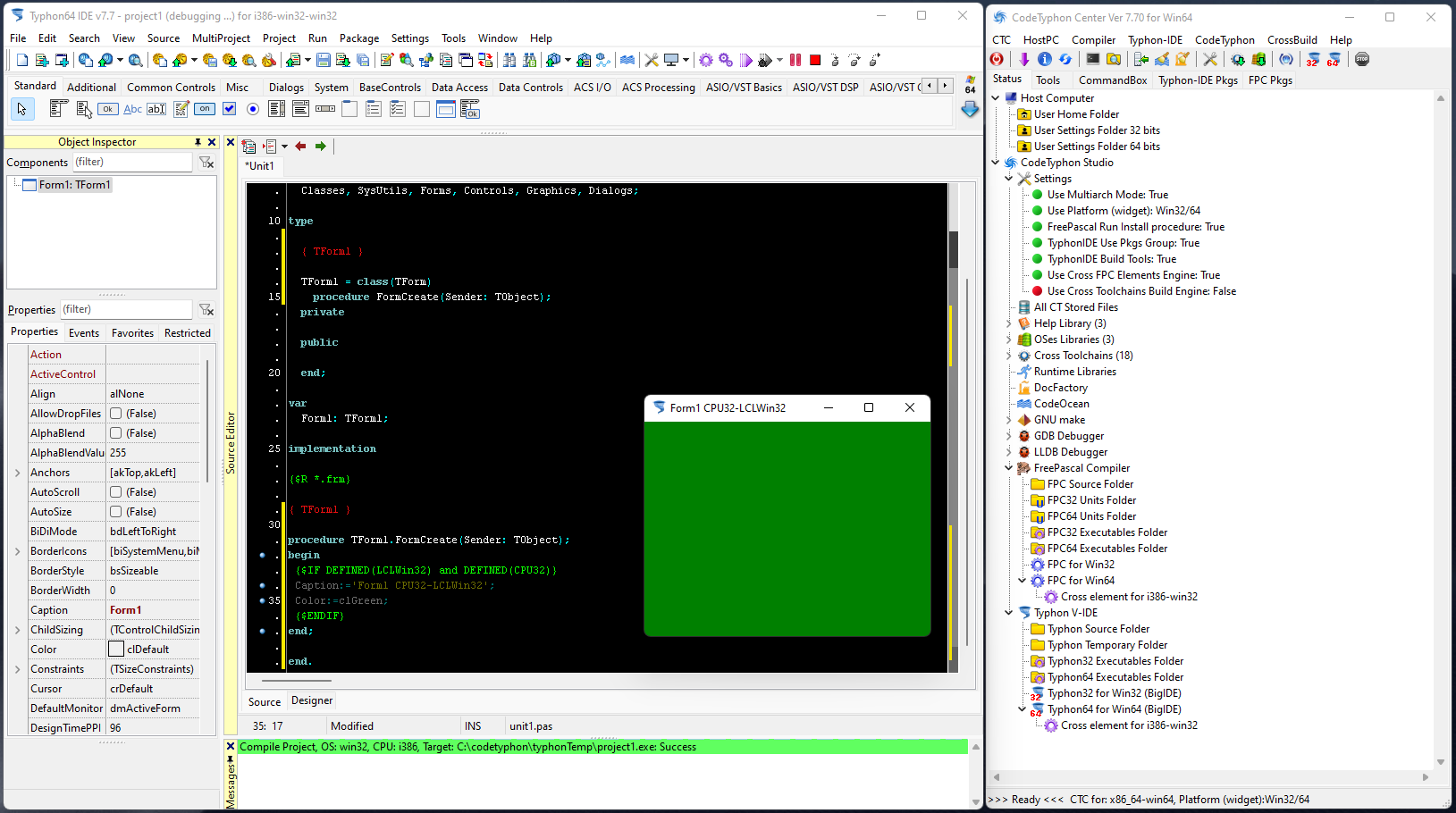

1) The problem with CrossBuild from Win64 to Win32 for project that use 80 bit 80x87 FPU
it's problem of MS Windows.
You must use the SSE CPU instruction set, for floating point math OR
not use 80 bit 80x87 FPU in your projects.
2) We don't know what SecureBridge components are, so what to suggest...
3) Use Typhon32 for Win32 projects, if that projects use 80 bit 80x87 FPU.
