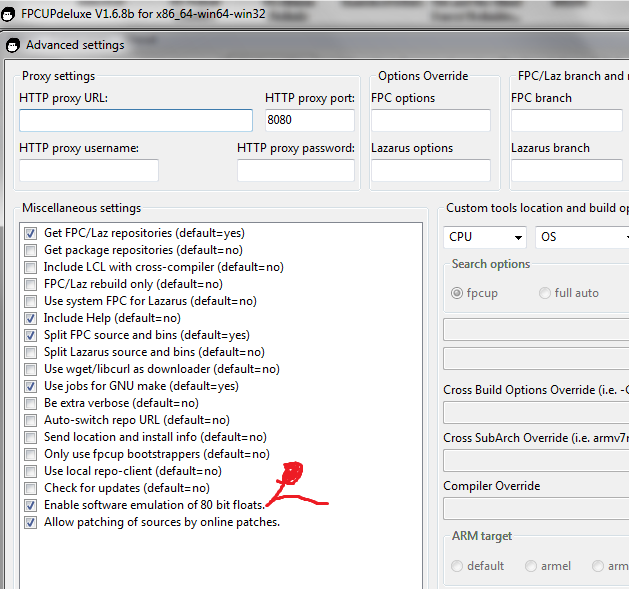

does CT truely use 80bits FPU instructions set for Extended type or is it stick with the 64bits set?
I ask because I saw an option in the deep setup of fpcupdeluxe, to activate 80bits emulation

Well, it sounds like 80bits wide Extended reals type is "an option" when building the underlaying compiler 3.x.x
That's why I ask... it could be important for HiTech scientists, and it's not clear
(I read many pages with google around the 64bits / 80bits FPU... saying that not that much (C,C++) compilers use the 80bits High Precision)
Regards

CT-FPC has software 80bits FPU switch (FPC_SOFT_FPUX80) enable by default for Win64
NOTE:
Win64 (not other x86-64 platforms) has deprecated the use of the 80 bit 80x87 FPU.
You now have to use the SSE unit for floating point math,
which supports up to 64 bit double precision like most FPU's on other platforms.
So, if you want to cross-compile Win64=>Win32 (target win32 support 80 bit 80x87 FPU)
you must enable FPC_SOFT_FPUX80 switch to Win64 host compiler,
CT-FPC do that by default.
