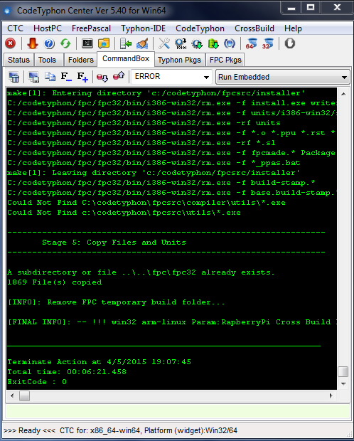

       Stage 5: Copy Files and Units
A subdirectory or file ..\..\fpc\fpc32 already exists.
1694 File(s) copied
[INFO]: Remove FPC temporary build folder...
[FINAL INFO]: -- !!! win32 arm-linux Param:RapberryPi Cross Build Element Build OK !!! --
Terminate Action at 05/05/2015 10:09:01
Total time: 00:05:45.579
ExitCode : 0
