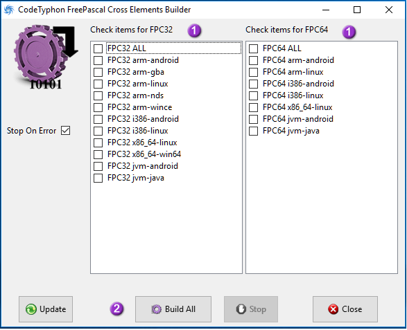

This tool give you the ability to build many FreePascal cross elements
with one click.
1) Select the cross element(s) you want to build from the left list (32 bits) and the right list (64 bits).
2) Hit "Build All" to start building.
If "Stop on Error" is checked the tool will stop the building procedure to the
FreePascal cross-element with the problem.
"Update" will update the lists of cross elements you can build.
The lists of cross-elements is from cross-toolchains that your CodeTyphon installation have.
If you want more cross-elements you must,
download the target(s) cross-toolchain(s) with Download Toolchains CTCenter tool
or
build the target(s) cross toolchain(s) with Toolchains Builder CTCenter tool.
