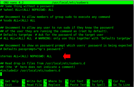

1. Step : Preparation
Give to installation user sudo root privileges.
Open the file “sudoers” located at /usr/local/etc/sudoers using your favorite text editor.
If you use nano editor you can simply enter the following into the Terminal:
su
nano /usr/local/etc/sudoers
user ALL=(ALL:ALL) NOPASSWD: ALL

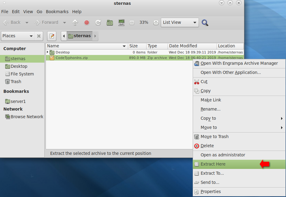

2. Step : Download
Download CodeTyphonIns.zip
to your /home directory

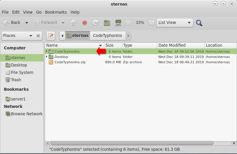

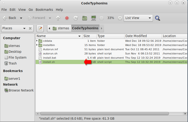

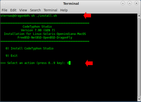

3. Step : Install
Go to CodeTyphonIns directory and execute the "install.sh" (as "normal" user with "sudo" root privileges)
To execute from terminal install.sh script
sh ./install.sh (execute install.sh)

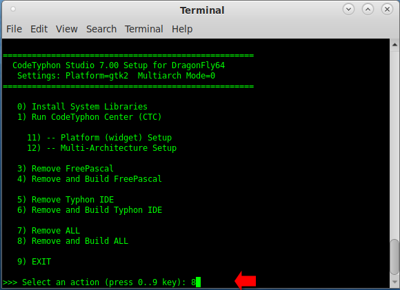

4. Step : Setup and Build
NOTE:
From "Setup Script" Select option (0) "Install System Libraries", to install some System Libraries
(2-5 minutes procedure)
From "Setup Script"
(10-45 minutes procedure)

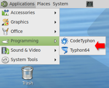

5. Step : Use CT
