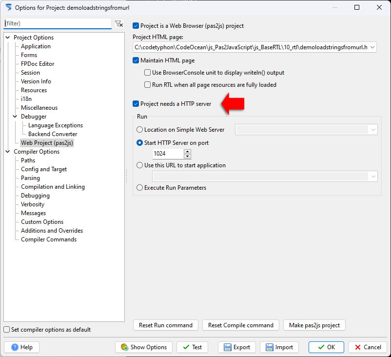

Please look at
codetyphon\CodeOcean\js_Pas2JavaScript\js_BaseRTL\10_rtl\demoloadstringsfromurl.ctpr
and
codetyphon\CodeOcean\js_Pas2JavaScript\js_BaseRTL\10_rtl\demoloadstreamfromurl.ctpr
These sample need HTTP Server in options
