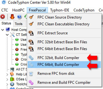

Sir, to rebuild fcl-web and fcl-xml FPC units
just open CTCenter and select
FreePascal => "FPC 32 Bits, build Compiler" or
FreePascal => "FPC 64 Bits,build Compiler"

it takes a lot of time, is it there a handy process to build only chosen units? by the way, I want to join programmers team, specifically for web, how can I join?
after long re-compiling, now it does not work... it shows these messages...:
Warning: Recompiling fphtml, checksum changed for htmlelements
weblazideintf.pp(25,29) Fatal: no puedo encontrar fphtmlutilizado por WebLazIDEIntf. Asegúrate de que todos los ficheros ppu del paquete se encuentren en su correspondiente directorio de salida. ppu en directorio incorrecto=C:\codetyphon\fpc\fpc32\units\i386-win32\fcl-web\fphtml.ppu..

I found a way, I had to open the .lpk lz_fpweb.lpk, and update the paths to the sources, now it compiles easily... I want to upgrade the fpweb components and give to everyone, a better idea would be to update to html5...
