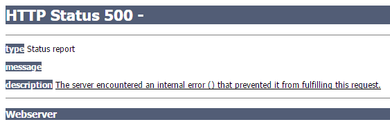

This is the response I am getting from SOAPUI:
<html><head><title>Webserver - Error report</title><style><!--H1 {font-family:Tahoma,Arial,sans-serif;color:white;background-color:#525D76;font-size:22px;} H2 {font-family:Tahoma,Arial,sans-serif;color:white;background-color:#525D76;font-size:16px;} H3 {font-family:Tahoma,Arial,sans-serif;color:white;background-color:#525D76;font-size:14px;} BODY {font-family:Tahoma,Arial,sans-serif;color:black;background-color:white;} B {font-family:Tahoma,Arial,sans-serif;color:white;background-color:#525D76;} P {font-family:Tahoma,Arial,sans-serif;background:white;color:black;font-size:12px;}A {color : black;}A.name {color : black;}HR {color : #525D76;}--></style> </head><body><h1>HTTP Status 500 - </h1><HR size="1" noshade="noshade"><p><b>type</b> Status report</p><p><b>message</b> <u></u></p><p><b>description</b> <u>The server encountered an internal error () that prevented it from fulfilling this request.</u></p><HR size="1" noshade="noshade"><h3>Webserver</h3></body></html>
Its HTML not XML nor XHTML. In HTML hr tag does not require end tag, for reference please see W3School . It's bug in pl_wst for reading XML as per laz2_XMLRead and xmltextreader unit. Line no 3481, 3482 in xmltextreader unit and line no 3453 in laz2_XMLRead unit.

Your EXMLReadError comes from the parsing of the response returned by the server, which is HTML, a HTML page displayed below.
Your parser expects XML, not HTML.
It is a server internal error, and the returned page produces an error on your side after this.
Nothing surprising ;)
I would say something is wrong with the parameters you try to send to the service (format ? encoding ?).
