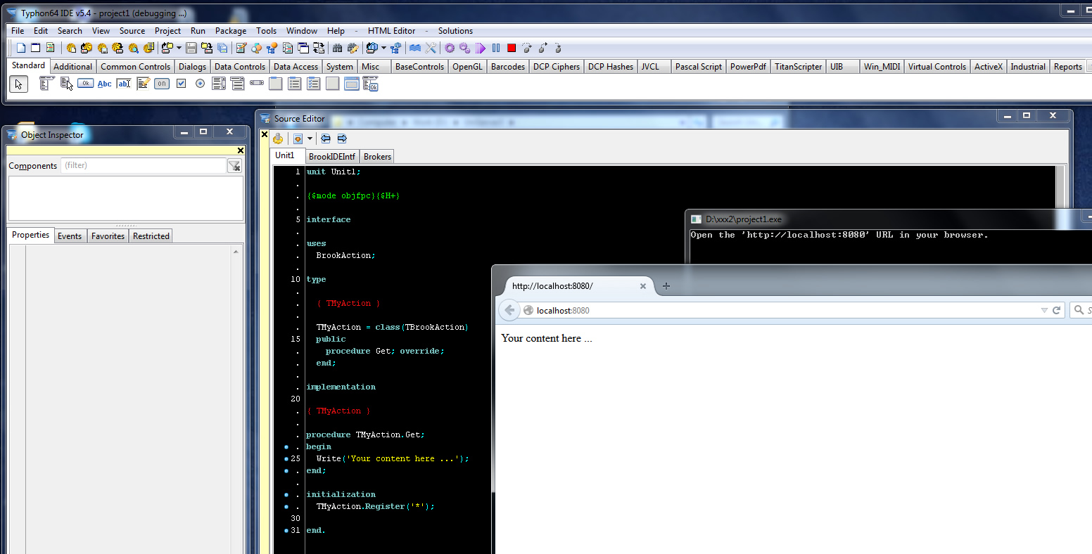

Routes broken? 11 years 5 months ago #7227
sir ultil we add code to pl_Brook\source\ideintf\brookideintf.pas
use this patch for unit Brokers of your project
unit Brokers;
{$mode objfpc}{$H+}
interface
uses
  BrookFCLHttpAppBroker, BrookUtils,
  BrookRouter, BrookApplication;                 // <=====
implementation
initialization
  TBrookRouter.RegisterService;          // <=====
  BrookRegisterApp(BrookFCLHttpAppBroker.TBrookApplication.Create);   // <=====
  BrookSettings.Port := 8080;
finalization                                                // <=====
  TBrookRouter.UnregisterService;       // <=====
end.
please report here if the code work OK
screen from Typhon64 on Win7-64

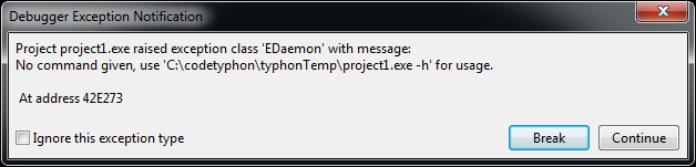

Brook Embeded server worked perfectly but Embeded daemon server gives attached error message. Please see the attached image.

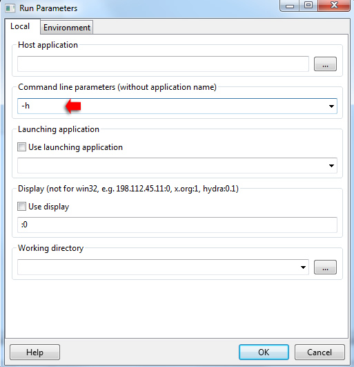

Routes broken? 11 years 5 months ago #7231
Go to Typhon IDE => Run => Run Parameters...
and add -h to start application parameters
now you must write and code for this Embeded daemon server
more info at brook web page silvioprog.github.io/brookframework/
