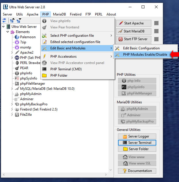

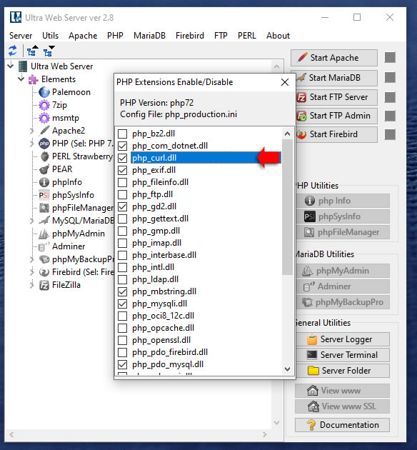

UWS PHP has many modules, we disable many of them (NOT common use) for speed...
a) Close ALL Servers
b) Go to PHP=>Edit Basic and Modules=>PHP Modules Enable/Disable
c) and Check php_curl.dll
d) Start Servers again

Excelent, all is ok now. Thanks a lot for your quick answer.
