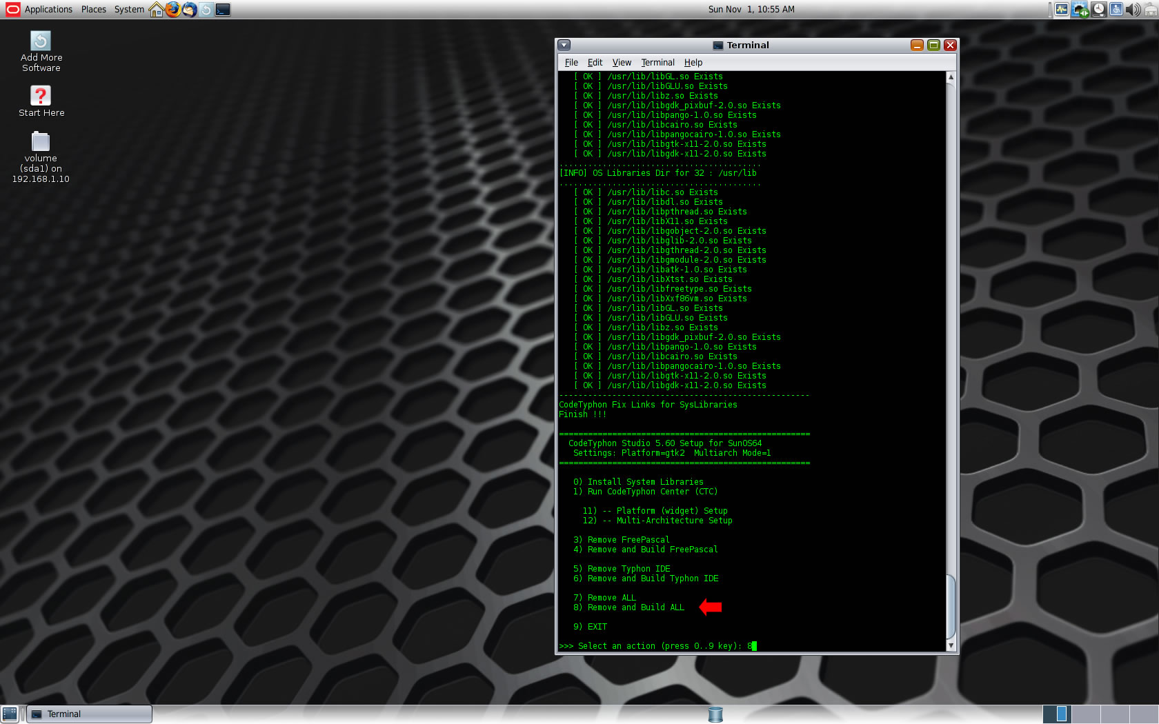

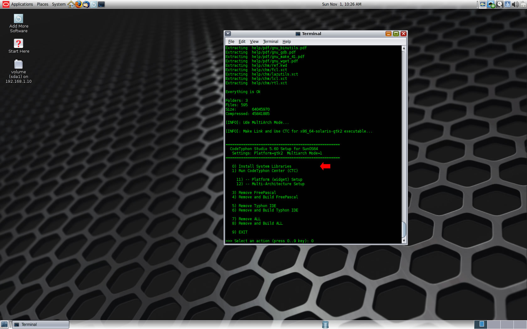

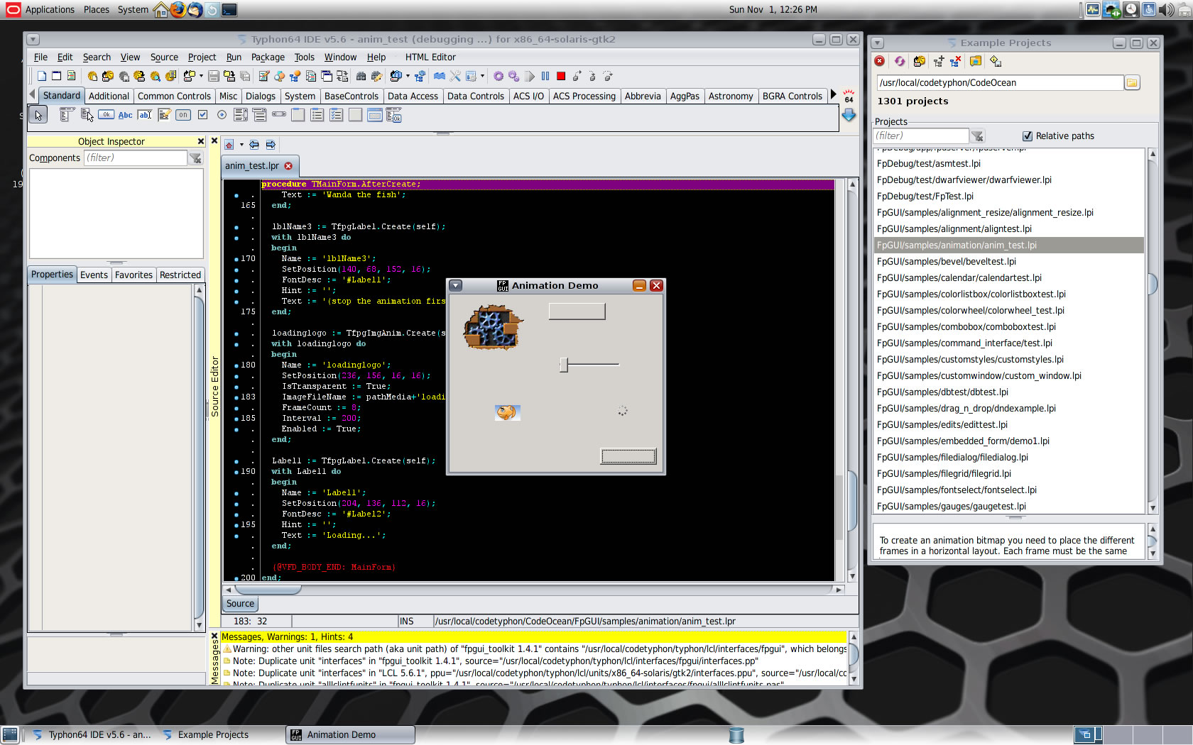

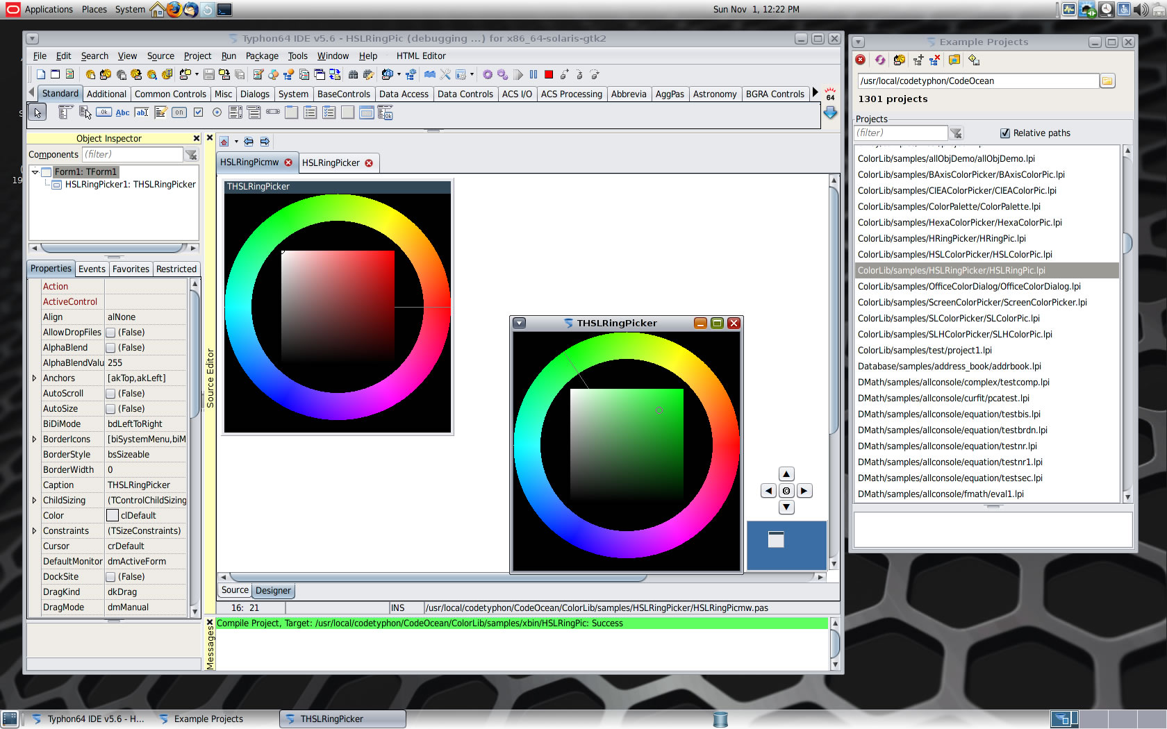

CodeTyphon on Solaris 11.3 10 years 11 months ago #8471
We test Lab CodeTyphon ver 5.60 on
Oracle Solaris 11.3 ( info )
(it's the same procedure with other Unixes (Linux, FreeBSD, MacOS etc)

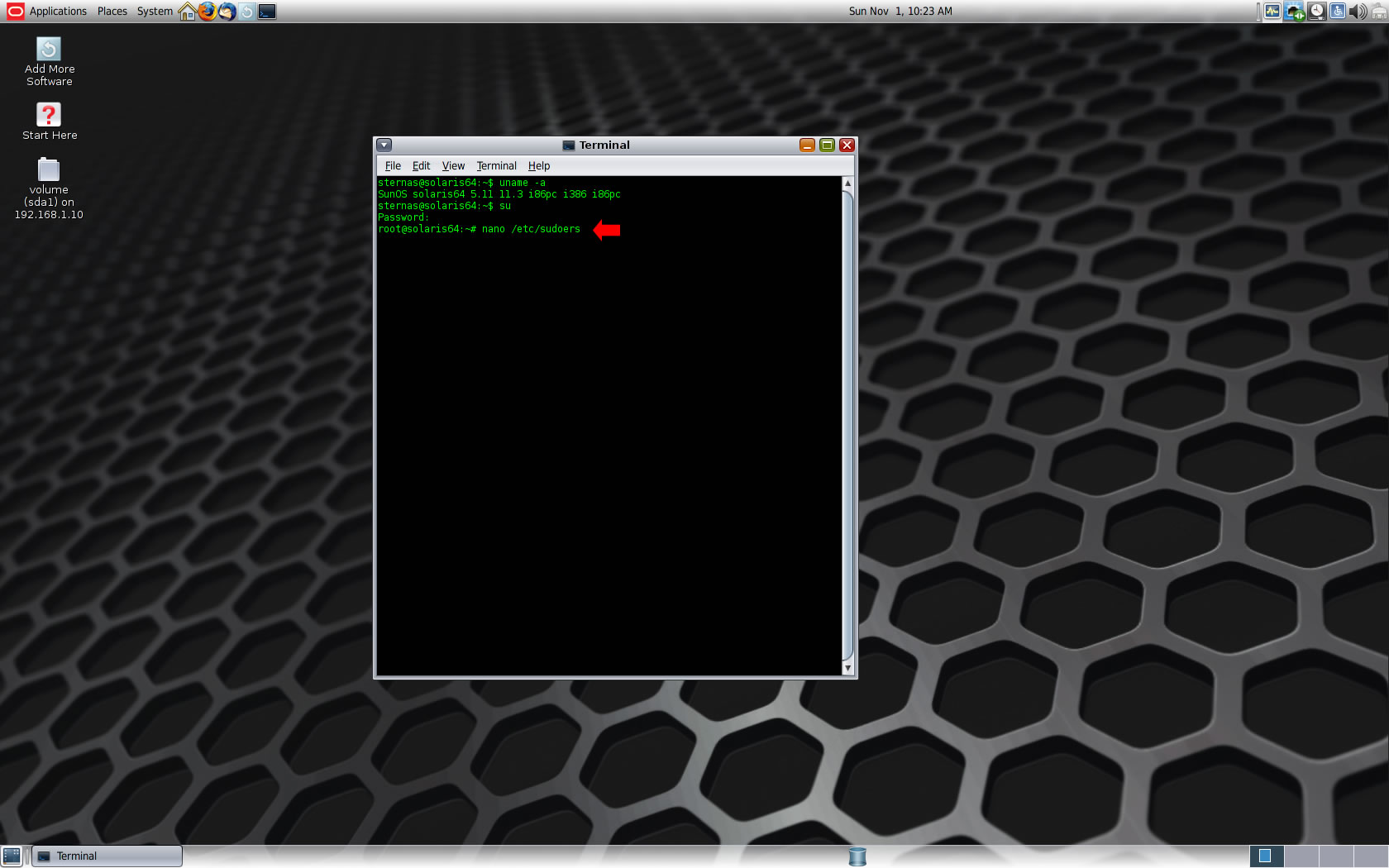

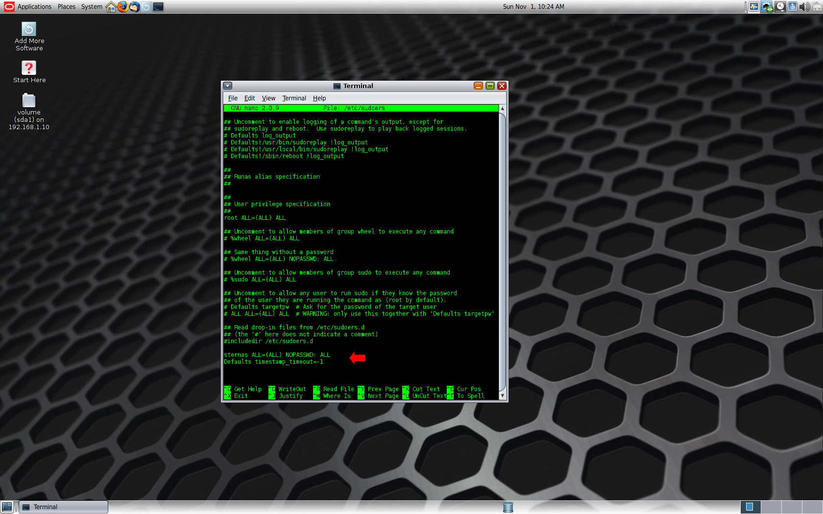

1)-Give full "sudo" permissions to current user.
su
nano /etc/sudoers
add in /etc/sudoers file the line
USER	ALL=(ALL) NOPASSWD: ALL
Defaults timestamp_timeout=-1

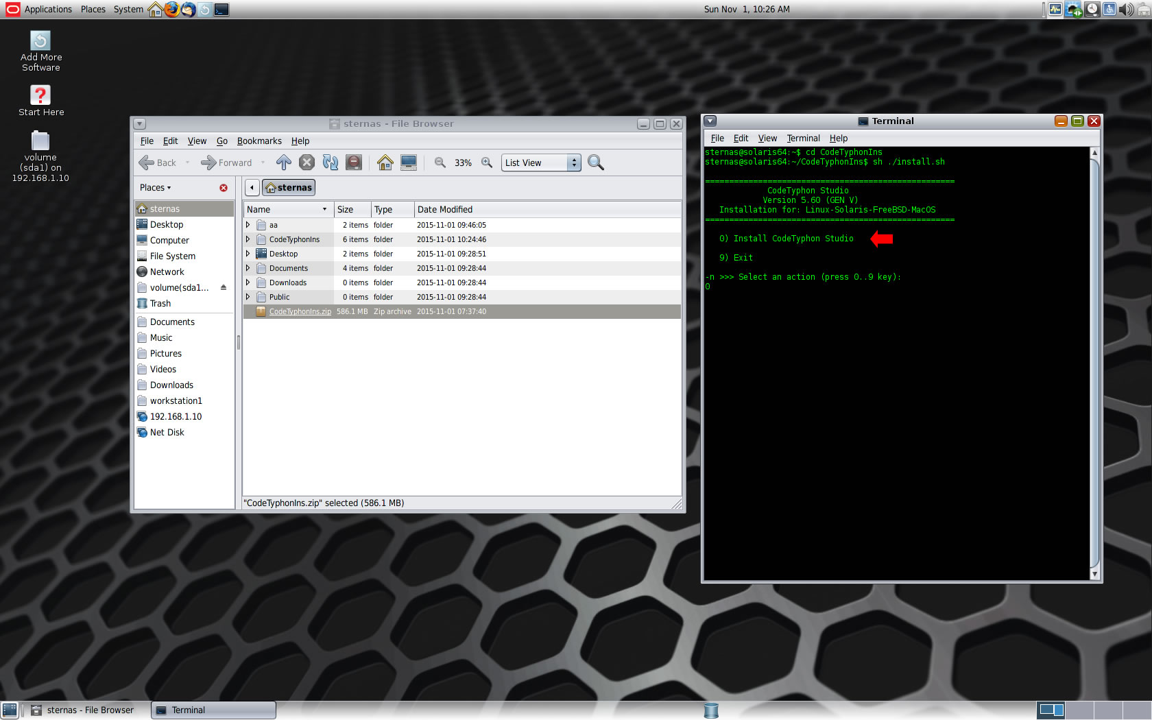

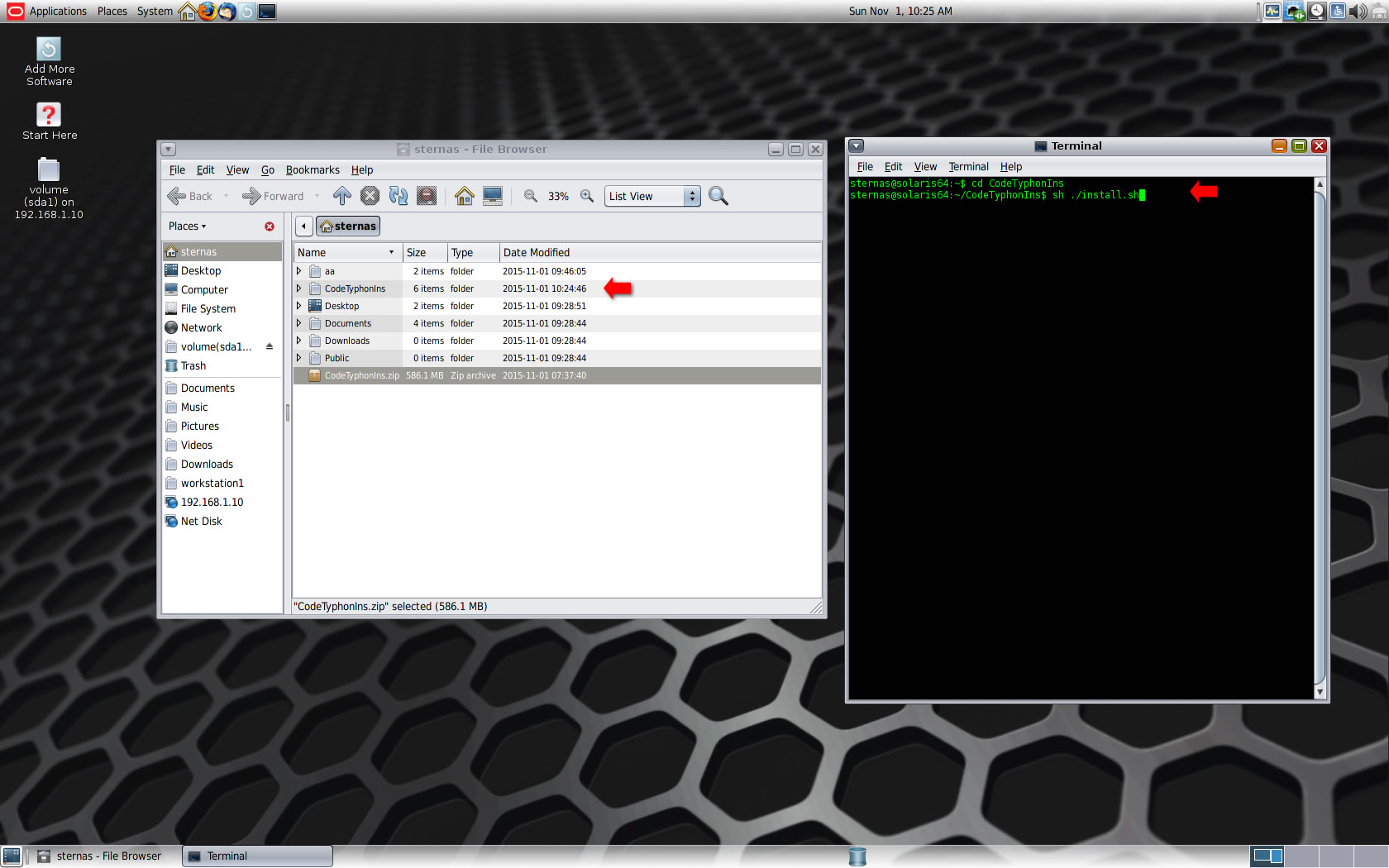

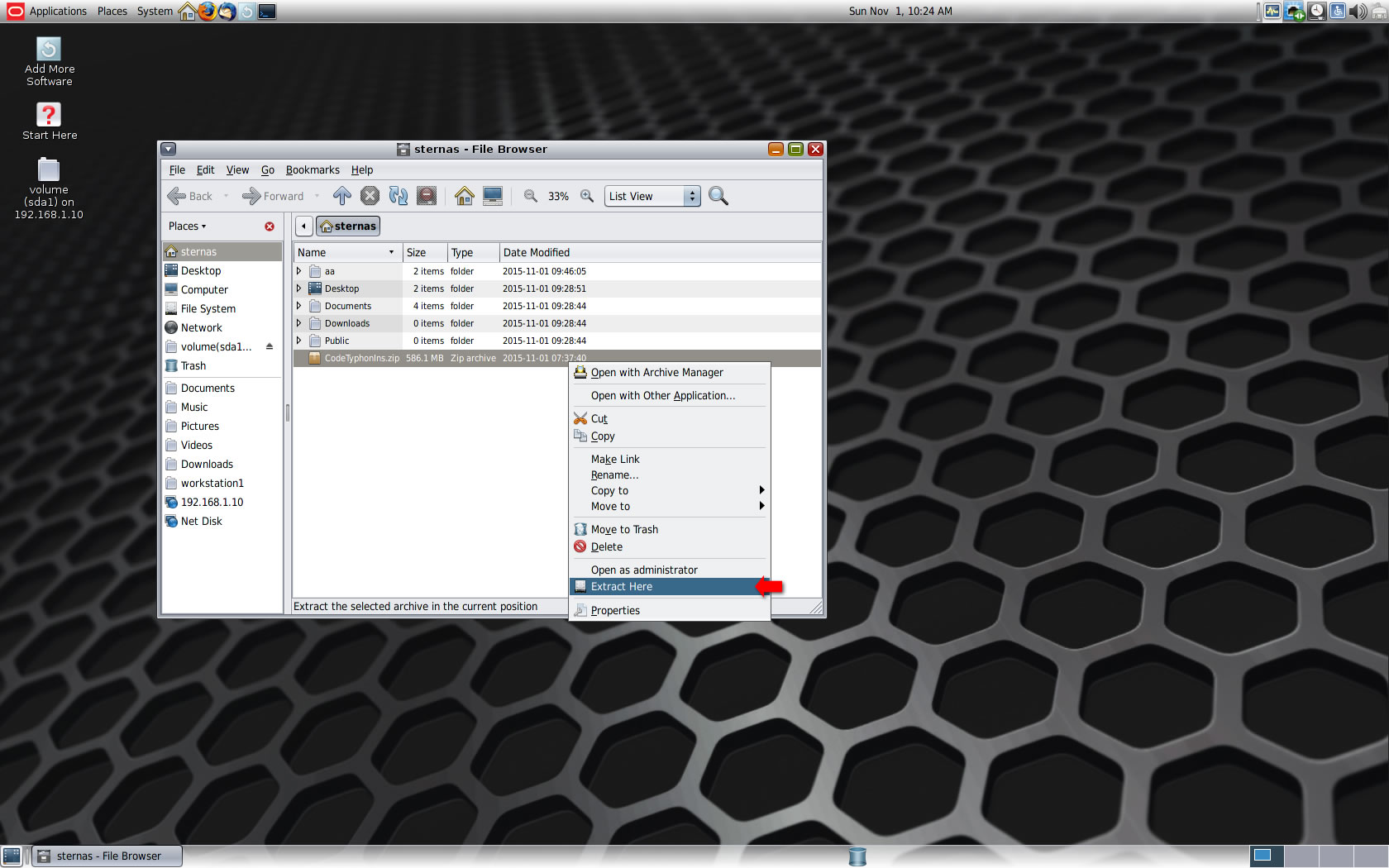

2)-Download and Unzip CodeTyphonIns.zip
3)-Run installation script

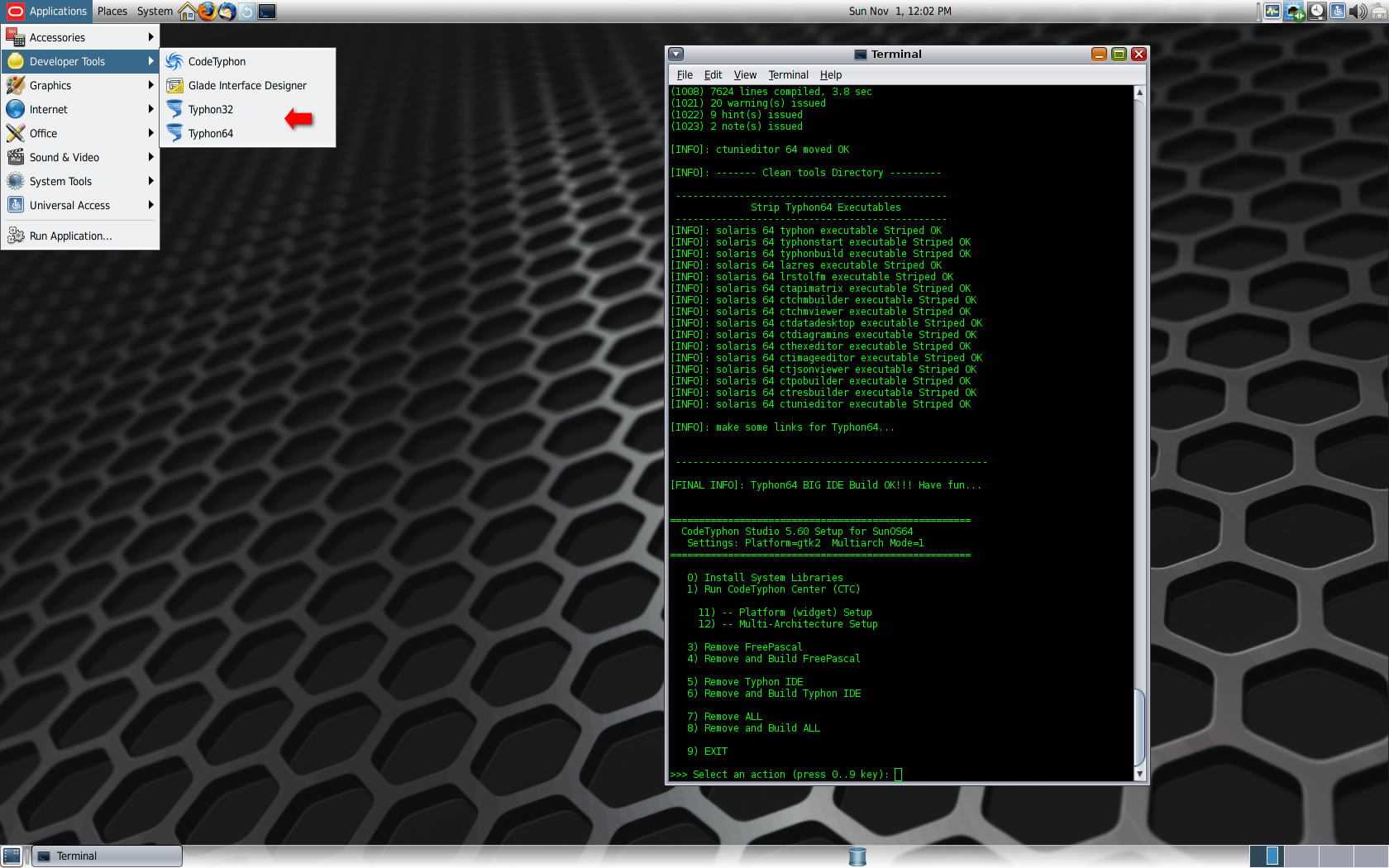

4)-Install "System Libraries" from CT Setup script.
5)-Build ALL FPC and Typhon IDE.

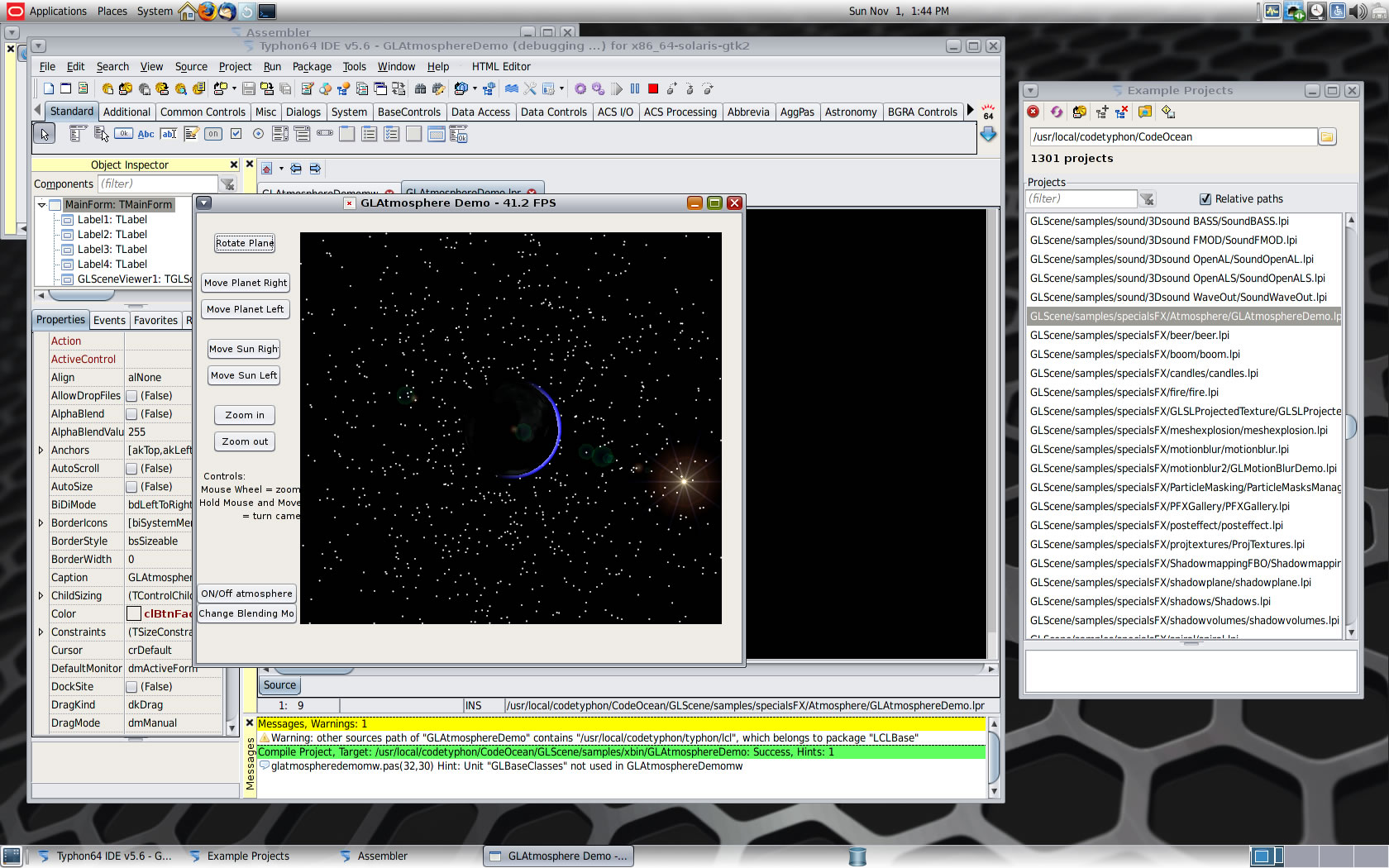

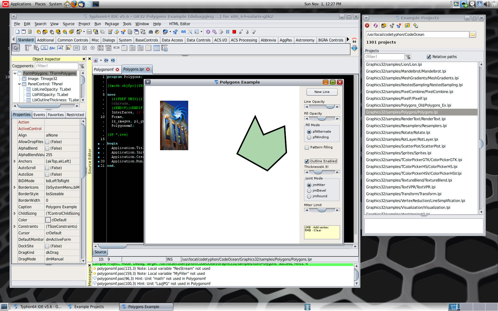

CodeTyphon on Solaris 11.3 10 years 11 months ago #8472
General CT tests list :
-CT System libraries installation (MultiArch)
-CT Installation
-CT Build All procedure (MultiArch)
-CT Update procedure
-FreePascal compiler tests
-Typhon IDE tools tests

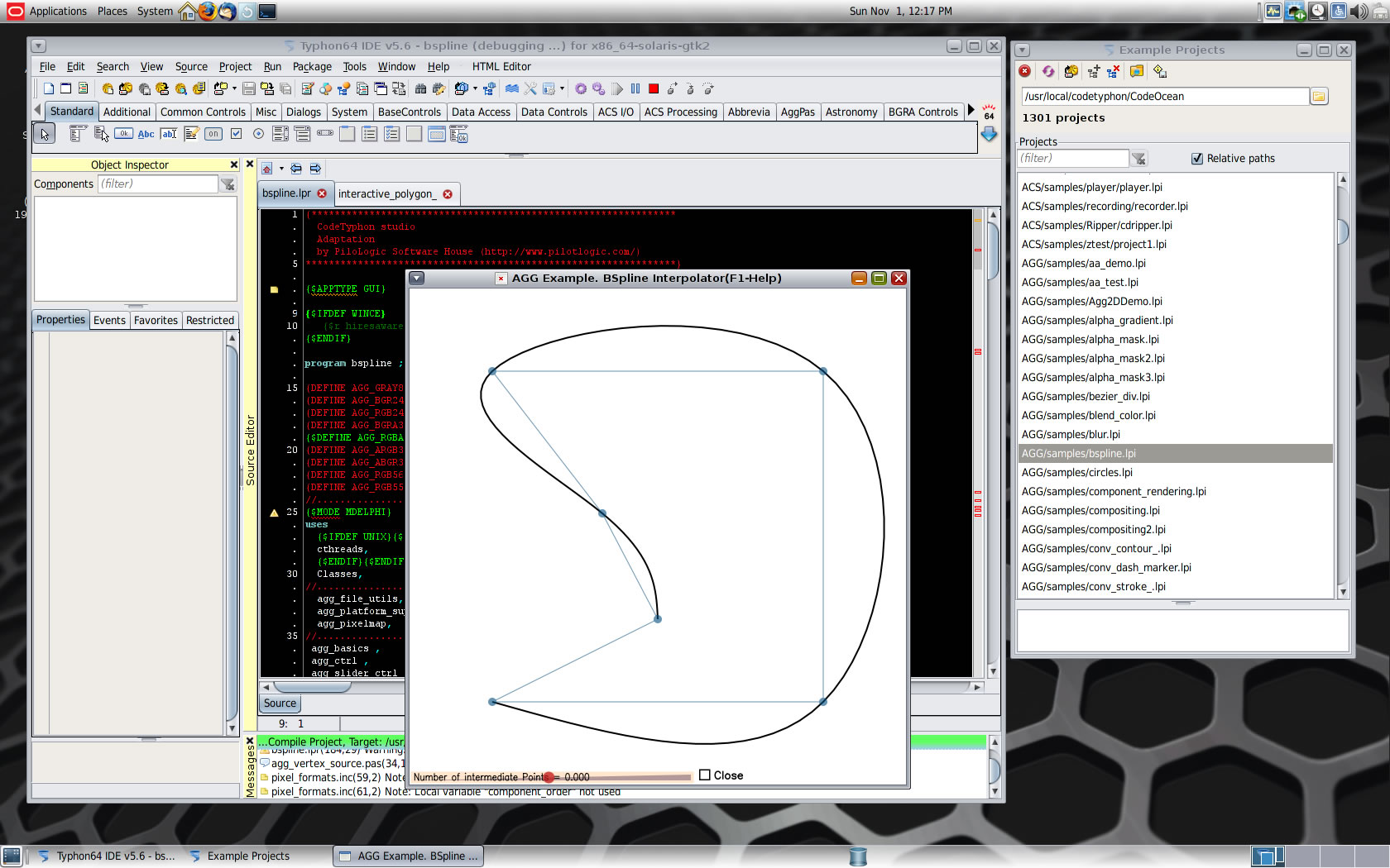

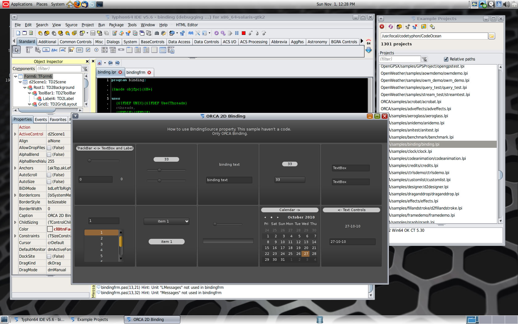

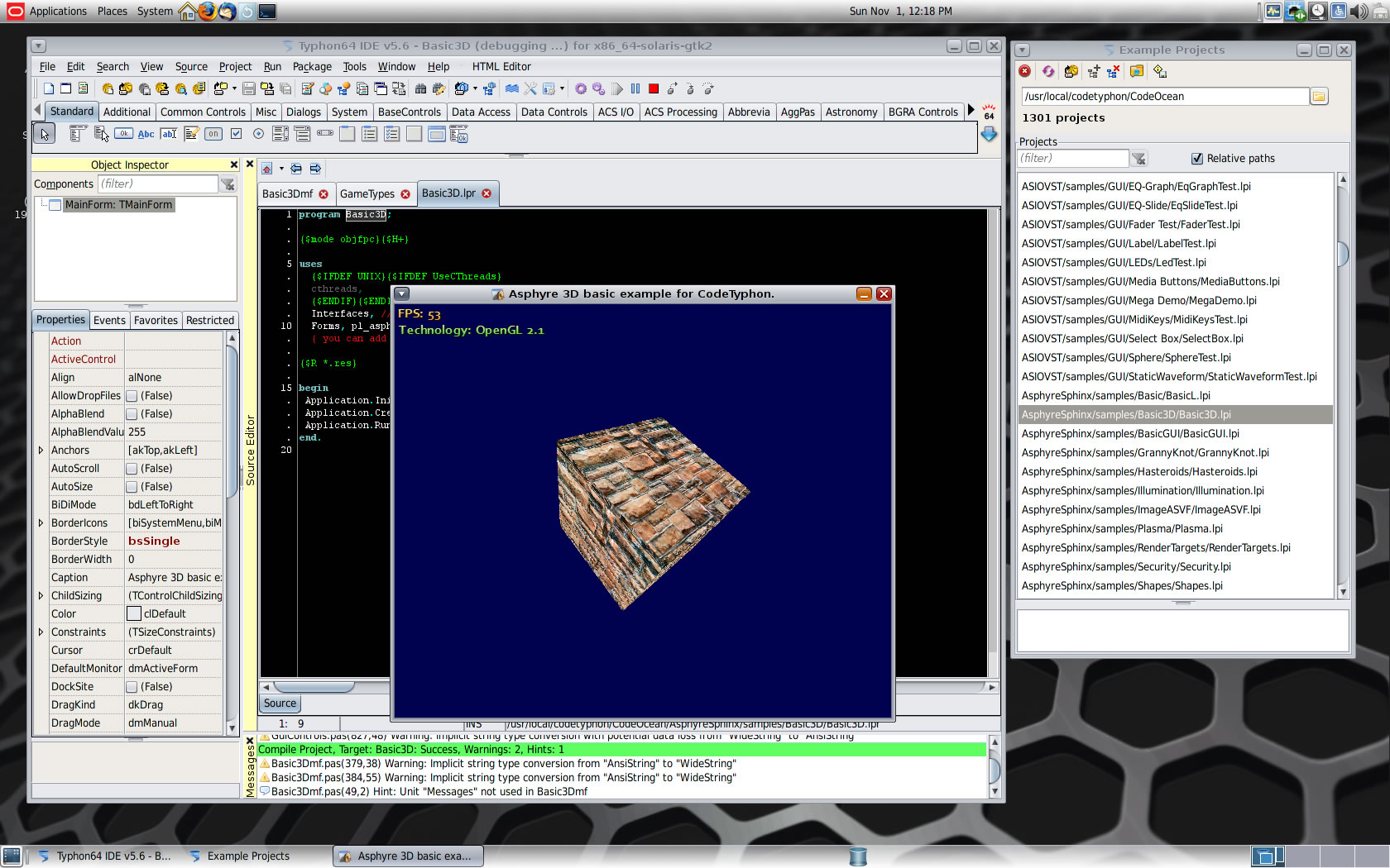

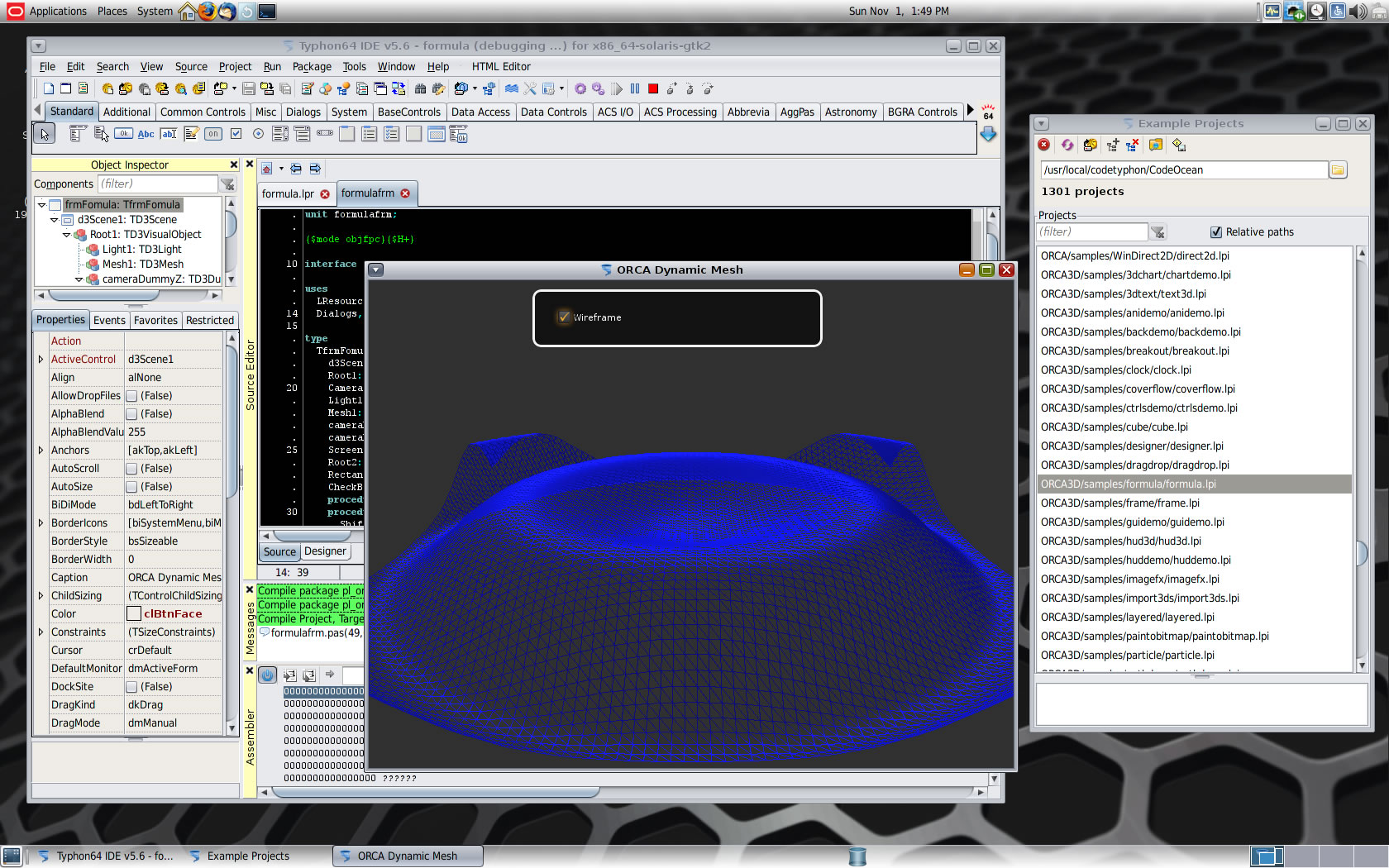

-CodeOcean samples tests
pl_ExControls,,
pl_AsphyreSphinx (yes on Solaris)
pl_Graphic32 (yes on Solaris)
pl_VampyreImaging (yes on Solaris)
pl_Orca,
pl_GLScene,
pl_Orca3D
etc...
