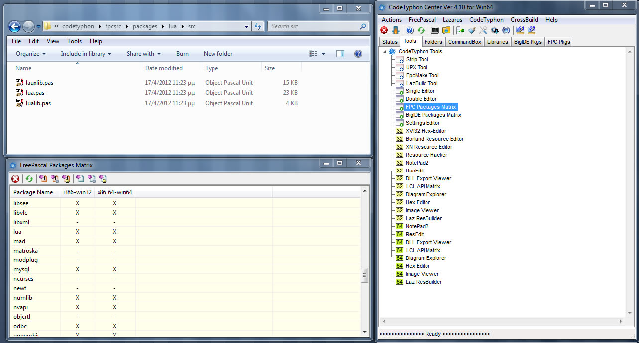

Lua! 13 years 7 months ago #3301
Look at CT FPC packages
codetyphon\fpcsrc\packages\lua\src

I have looked at that, but, as I've said before, I can find an alternative for this:
module(L)
        def("greet", &greet)
How can I do this?
