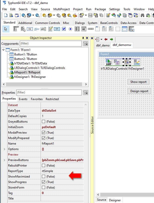

I notice that whatever I do the report window always opens in a fixed size window and I have to maximize it manually.
Is there a property or a way to get the report window opening maximized after a ShowReport?

Lzreports window always open with the same size 6 years 6 months ago #14618
we already fixed
We add property ShowMaximized: Boolean to TfrReport
and works for
frReport.ShowReport
frReport.DesignReport
procedures.
Have Fun and stay healthy too
