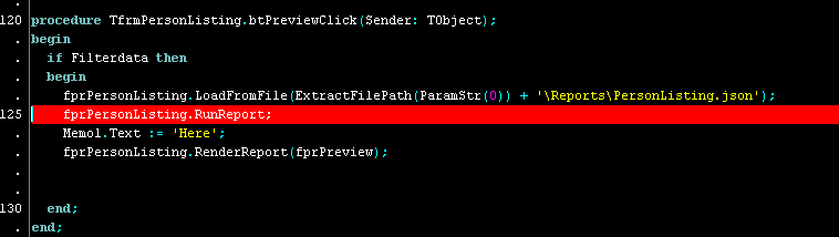

So I switched it to tfpjsonReport now I can preview the report in design time, during runtime it gives me that message.
I am attaching the source code.
fprPersonListing.LoadFromFile(ExtractFilePath(ParamStr(0)) + '\Reports\PersonListing.json');
fprPersonListing.RunReport;
fprPersonListing.RenderReport(fprPreview);

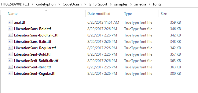

C:\codetyphon\CodeOcean\pl_FontEngine\samples\xmedia\
and copy arial.ttf to your app folder

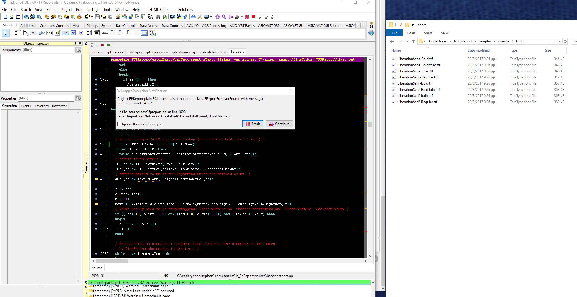

Putting Arial.ttf in the project folder does not help.
I spent a couple of days digging.

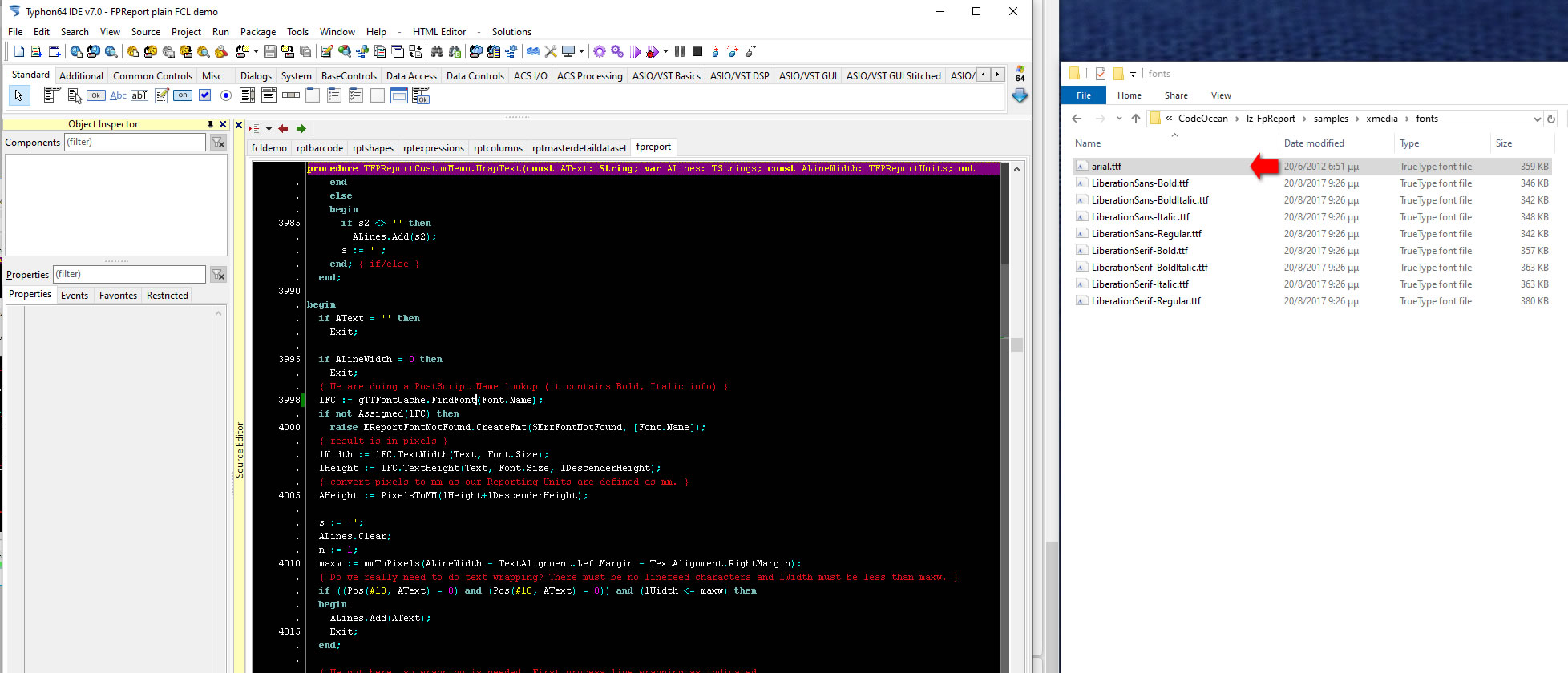

In the FPReport source code I found out that for some reason this is not working:
lFC := gTTFontCache.FindFont(Font.Name); ===>>>> Font.Name in this case is 'Arial'
if not Assigned(lFC) then ====>>>> IFC is nil here, so the above line does not return the font object
raise EReportFontNotFound.CreateFmt(SErrFontNotFound, [Font.Name]);
This is a problem with the code in fpTTF that might be related with Windows 10. I wonder if there's an update to this function.

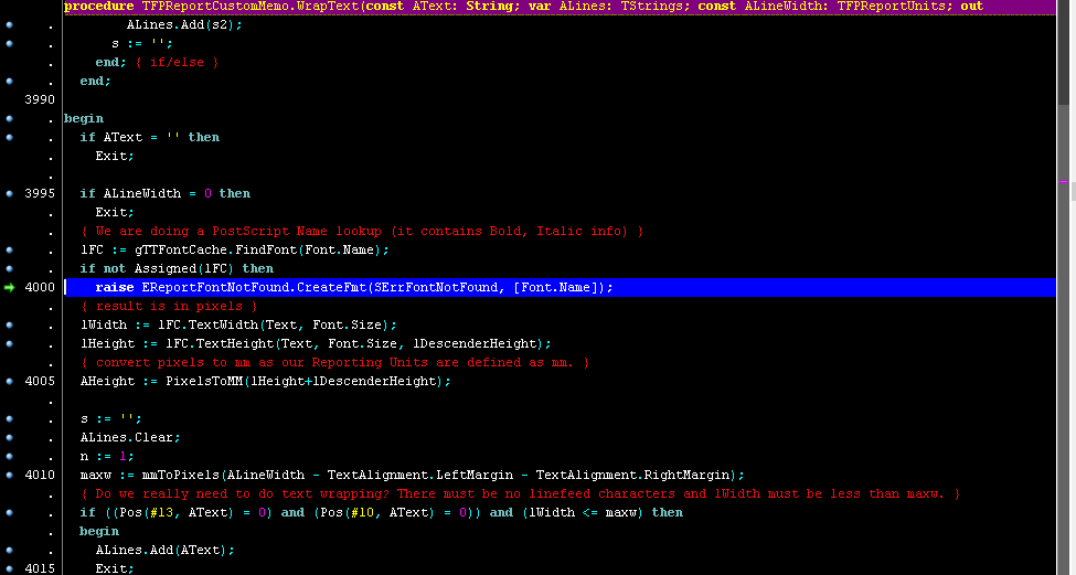

Same error, I am getting the error on fpreport.pp.
I am attaching the images.

1) Put fixes above in FpReport source.
2) copy C:\codetyphon\CodeOcean\pl_FontEngine\samples\xmedia\arial.ttf
to your FpReport font folder
We get the same with error with you, without arial.ttf
with arial.ttf in FpReport font folder, ALL OK
The above CodeOcean sample project is:
C:\codetyphon\CodeOcean\lz_FpReport\samples\demos\fcldemo.ctpr

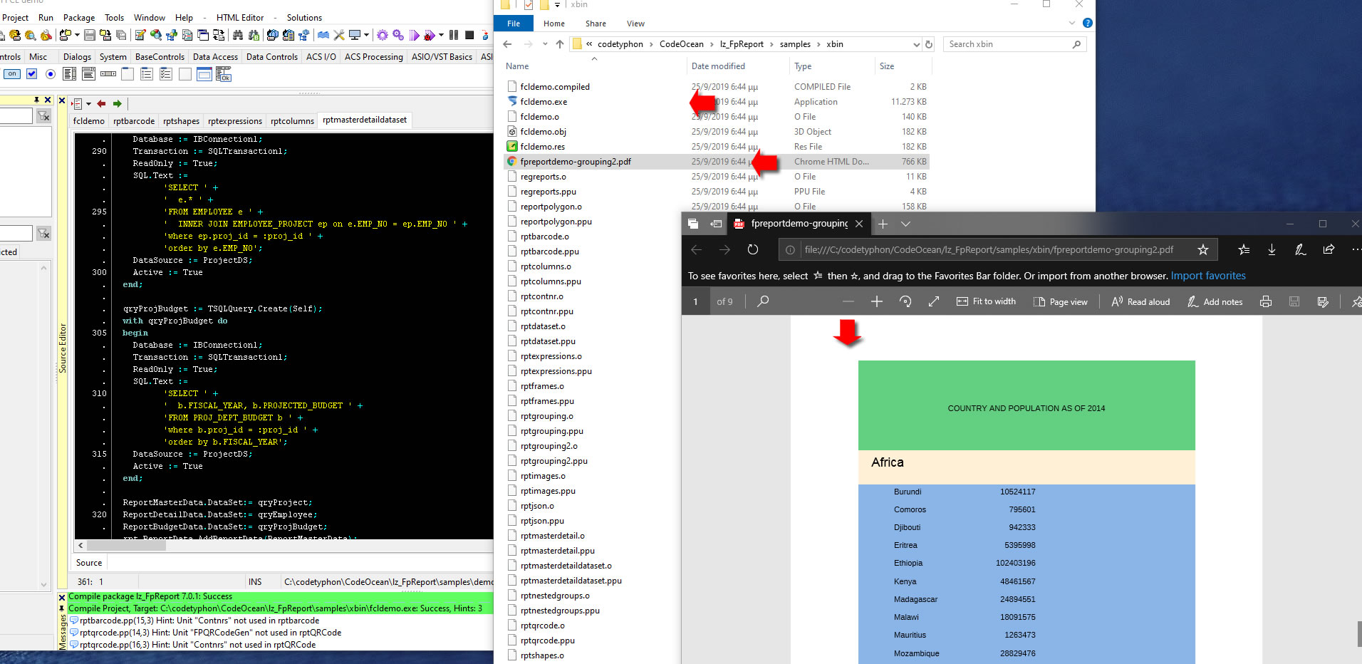

Missing Font "Arial" CT 6.8 6 years 8 months ago #13831
  • Posts: 4624
  • Thank you received: 1132
It's NOT GUI app.
Look at fcldemo.ctpr out directory
C:\codetyphon\CodeOcean\lz_FpReport\samples\xbin\
fcldemo app build fpreportdemo-grouping2.pdf
Missing Font "Arial" CT 6.8 6 years 8 months ago #13832
  • Jose Ceravolo
  • Jose Ceravolo's Avatar Topic Author
  • Posts: 25
Yes, the report is there.

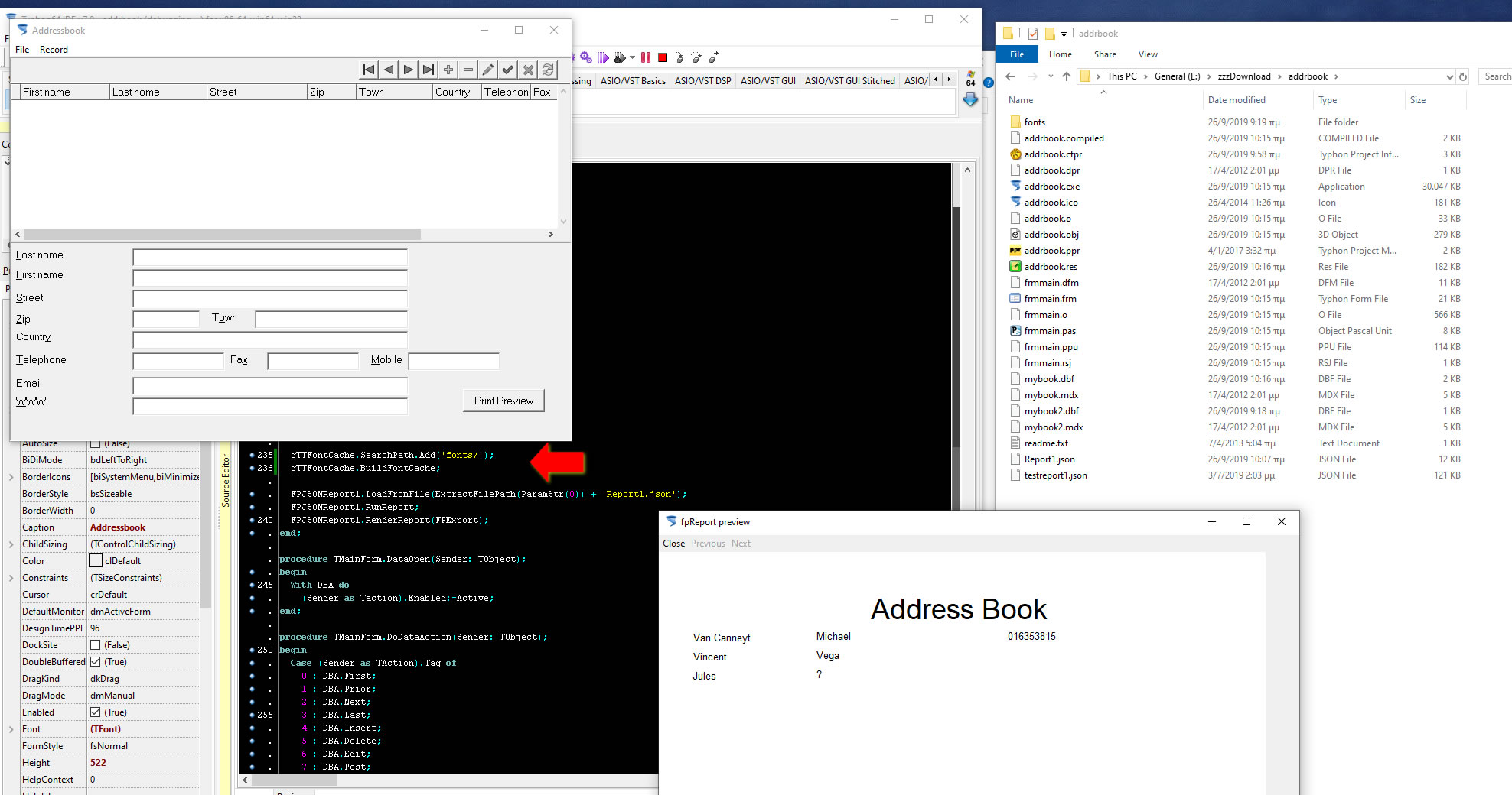

I used the Address Book sample to duplicate the problem.
I am attaching the whole project.
Missing Font "Arial" CT 6.8 6 years 8 months ago #13839
  • Posts: 4624
A) Solution A
-First of All
make a folder "fonts" into your addrbook app
copy to new "fonts" folder arial.ttf from CodeOcean Samples
-In Report1.json Line 89 replace "Arial-BoldMT" with "Arial"
-In your main app unit frmmain
add to uses fpTTF unit
uses
  SysUtils, Variants, Classes, Graphics, Controls, Forms,
  Dialogs, DB, Dbf, Grids, DBGrids, DBCtrls, ExtCtrls, ActnList, Menus,
  StdCtrls, Buttons, fpjsonreport, fpreportdb, fpreportformexport,
  fpTTF,    //<<<<==== ct9999 ====
  FPReport;
and 2 lines at
procedure TMainForm.btPrintClick(Sender: TObject);
  gTTFontCache.SearchPath.Add('fonts/'); //<<<== ct9999 ==============
  gTTFontCache.BuildFontCache;              //<<<== ct9999 ==============
  FPJSONReport1.LoadFromFile(ExtractFilePath(ParamStr(0)) + 'Report1.json');
  FPJSONReport1.RunReport;
  FPJSONReport1.RenderReport(FPExport);
gTTFontCache is Variable in fpTTF.pp
I think now you can continue by your self... :)
Missing Font "Arial" CT 6.8 6 years 8 months ago #13840
  • Jose Ceravolo
  • Posts: 25
Excellent!!!
I changed it a bit.
I added LCLIntf to the uses clause and changed the lines to update the font cache to:
gTTFontCache.SearchPath.Add(GetEnvironmentVariable('WINDIR') + '\Fonts\');
This way all fonts in windows work.
Thanks for your help!
