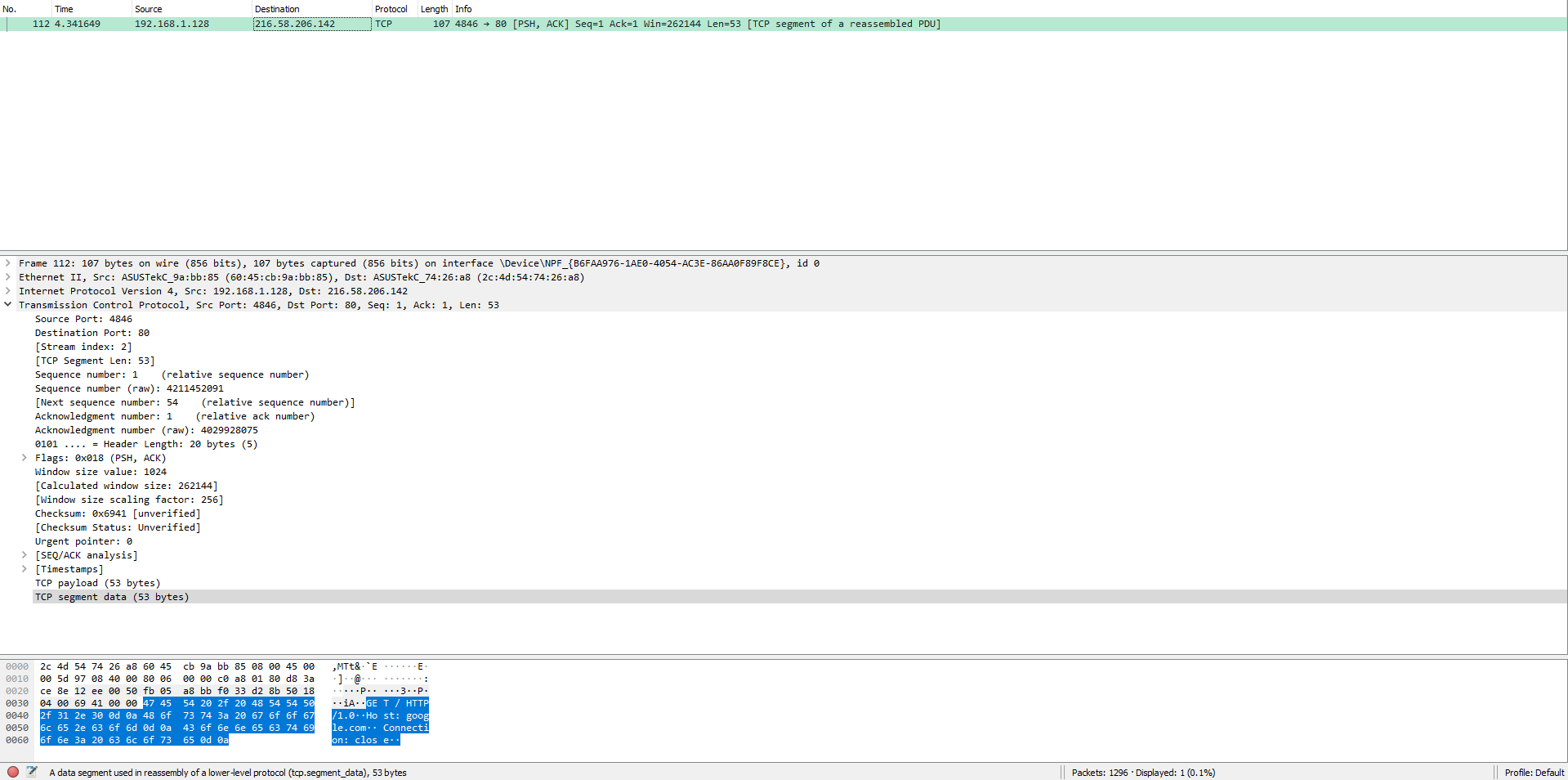

Hi all,
I had an application that was working fine in a previous build of CodeTyphon, but since upgrading to the latest release the TvsVisualHTTP component is not sending requests correctly, and as such, I'm getting no data through. I have checked the packet data using Wireshark, and it isn't showing as a valid HTTP request, but instead, it is showing as fragmented TCP packets.
The methods in question are vsVisualHTTP.Post(URI,Data) & vsVisualHTTP.Get(URI), both of which seem to be sending malformed packets and never firing the OnData event.
I'm using Typhon64 (7.0, 2020-02-04, Rev62514) with FPC 3.3.1/Rev43891) - platform x86_64-win64-win32/win64.
Any advice/help greatly appreciated.

Hi Sternas,
I just upgraded to 7.1 LAB and spent 30 minutes compiling the 64-bit BigIDE, the problem still persists.
As a test, I am attempting to GET google.com and receiving no response or data in the OnData event, and Wireshark doesn't recognise the request as HTTP traffic.
See attached pictures.

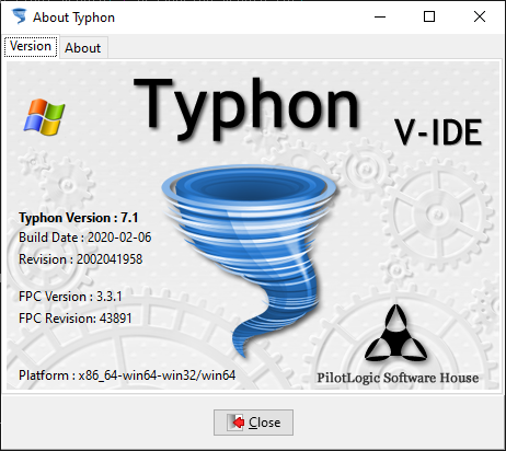

vsVisualSynapse - TvsVisualHTTP Client POST/GET not working 6 years 7 months ago #14352
your FPC is from CT ver 7.0 ????
The problem was in FPC 7.0
LAB CT 7.1 has FreePascal 3.3.1 Rev :2002041958 (=> 20-02-04 19:58 yy-mm-dd hh:mm )
Please Remove and Build ALL (FPC and Typhon)
Please look at this post

  • Posts: 14
Ahh, I see, my apologies, rebuilding again now.
