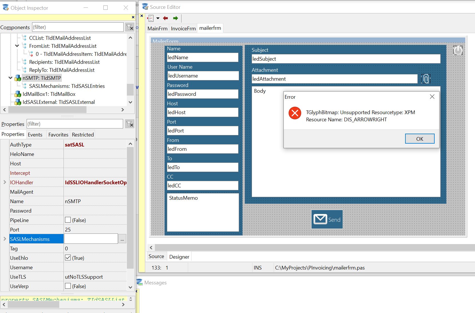

Indy 7 years 4 months ago #13500
  • Joao Barbosa
  • Joao Barbosa's Avatar Topic Author
  • Posts: 38
Hi there,
when i try to open the SALSMechamisims in the smtp componenet on a form it gives me the following error
in the attached file please help
Indy 7 years 4 months ago #13501
  • Posts: 1436
  • Thank you received: 233
Your CT ver ?
Indy 7 years 4 months ago #13504
  • Joao Barbosa
  • Posts: 38
ver. 6.80

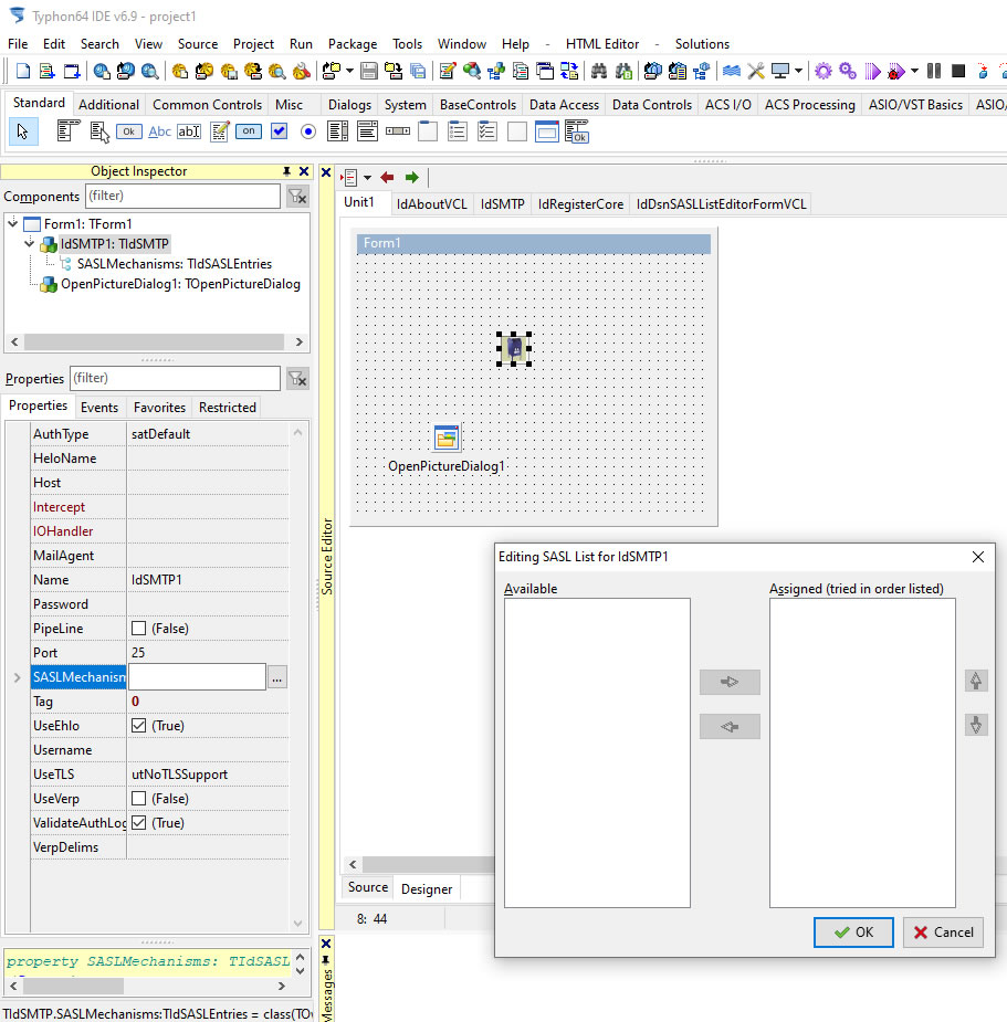

Indy 7 years 4 months ago #13506
we fix the problem
1) Replace directory C:\codetyphon\typhon\components\pl_Indy
with new Fixed pl_Indy ver 6.91
2) Compile pl_Indy package (you must delete old pl_Indy\lib if exists)
3) Rebuild Typhon IDE
Indy 7 years 4 months ago #13510
  • Joao Barbosa
  • Posts: 38
Thank You, it works now
Indy 7 years 4 months ago #13511
have fun
