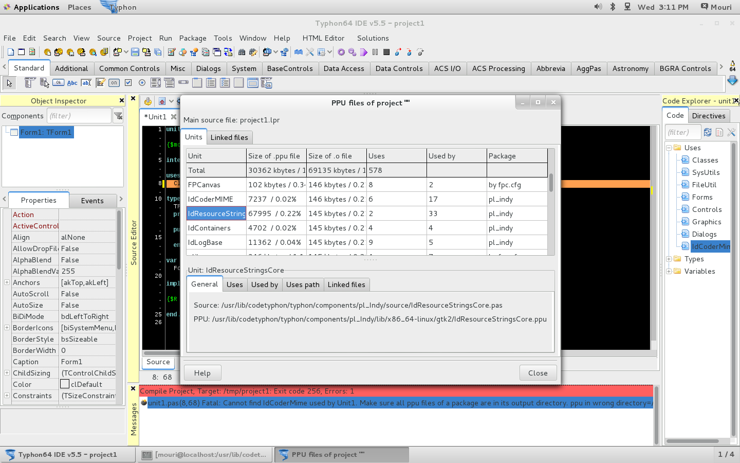

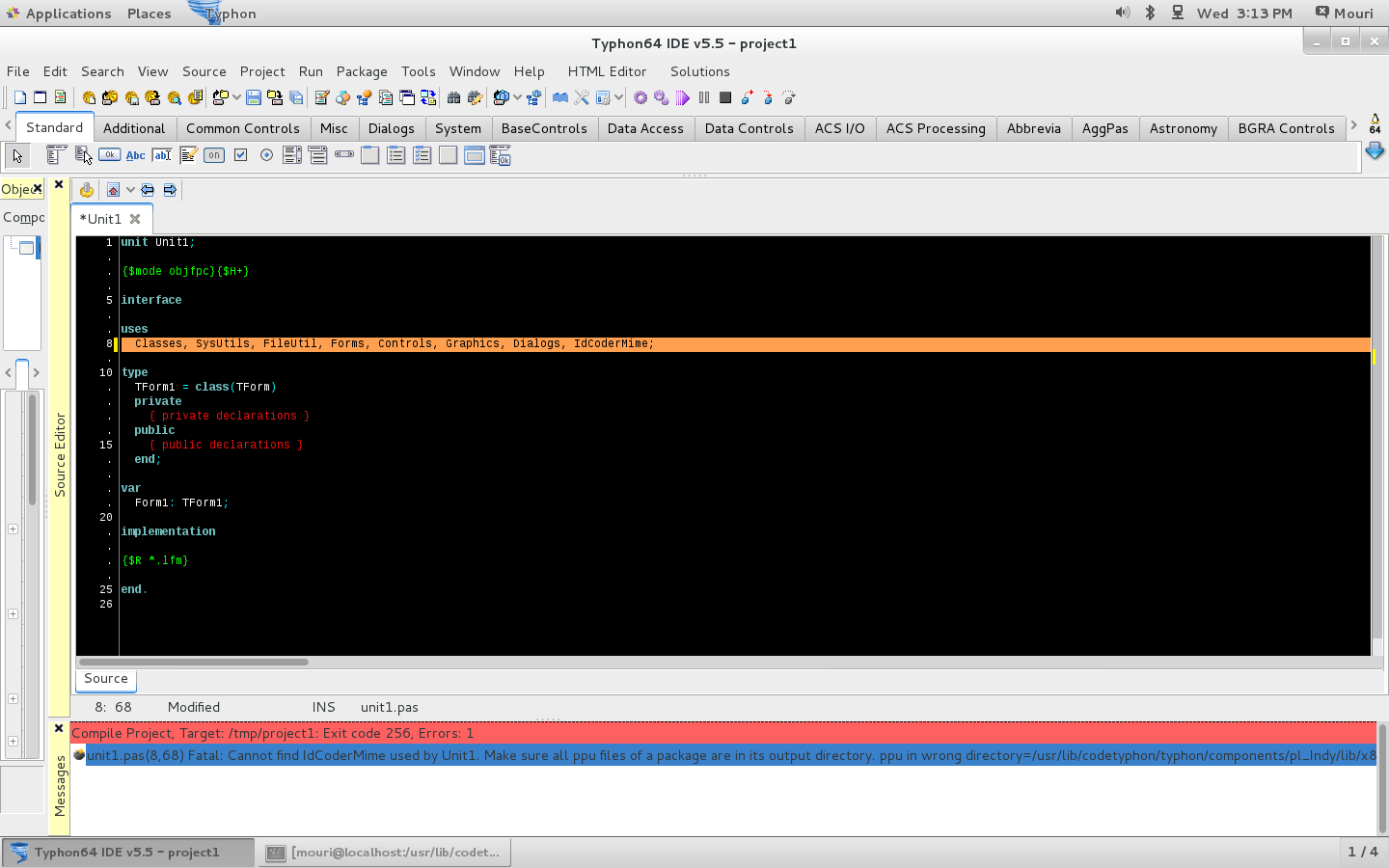

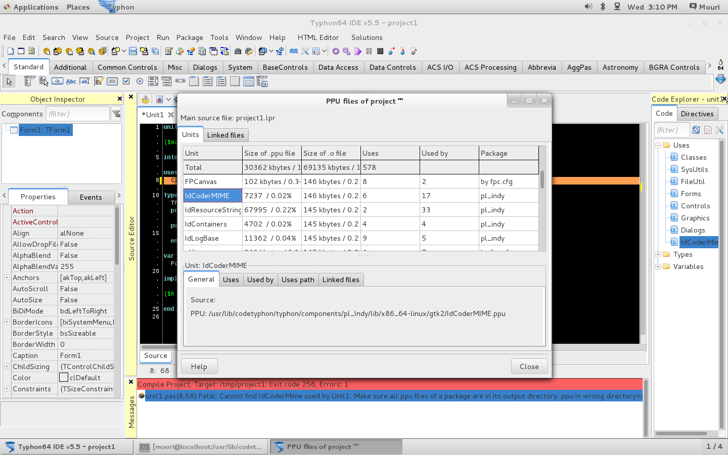

When I try to compile any project which has IDCoderMime unit, I got compile error as per attached images. Strange thing is in PPU files in project view every unit has pas file except of IDCoderMime.pas. Please see the attached images. Also I got exception as following:
sgcWebSocket_Helpers.pas(24,27) Fatal: Cannot find IdCoderMime used by sgcWebSocket_Helpers,
incompatible ppu=/usr/lib/codetyphon/typhon/components/pl_Indy/lib/x86_64-linux/gtk2/IdCoderMIME.ppu, package pl_indy

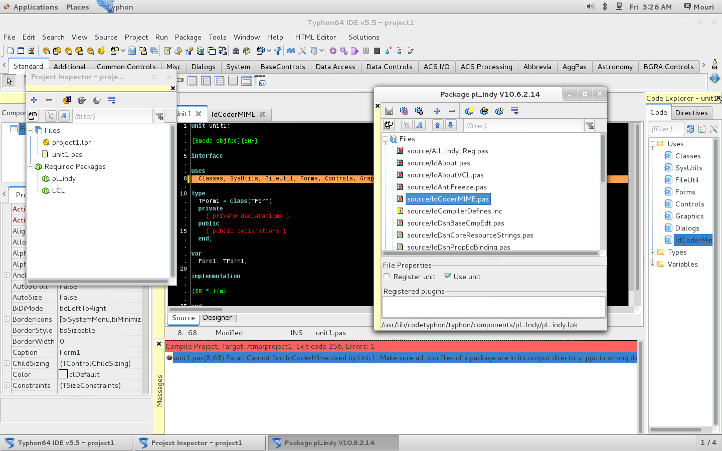

try to add in pl_indy package IdCoderMime.pas unit
IDCoderMIME unit problem in CentOS 7 64bit CT 5.5 10 years 9 months ago #8309
  • Md. Shariful Alam Khan
  • Posts: 111
Still having same problem. Have added IdCoderMIME.pas in pl_indy package. After compiled pl_indy package and also build typhon64 IDE. Please see attached screenshot.

Solved the issue. It was case sensitive on unit name. I used IdCoderMime which should be IdCoderMIME.
