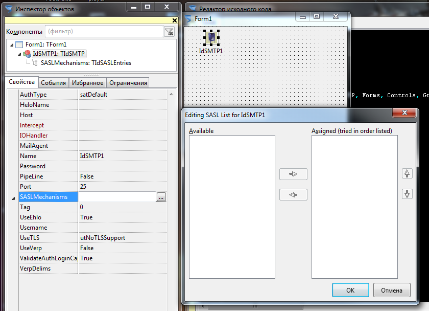

Hi Sternas,
Error in CT 4.60 wasn't repair. Still I have an error when I click SASLMechanisms property in IdSMTP component:
"TGlypthBitmap: Unsupported Resourcetype: XPM Resource Name: DIS_ARRORRIGHT"

So, I'm fix this problem.
Source file IdDsnSASLListEditorFormVCL.pas use wrong method
Glyph.LoadFromLazarusResource('some_ref')
1. this method must be changed on this
LoadGlyphFromLazarusResource
2. rebuild IDE and you will see
You can use the file in attach.
Enjoy.

Thanks ZeUsM .... I check this ...

I checked this and is working perfectly :) thanks another one ZeUsM
Sternas, Could you make this change in next CT release. Thx !!!
