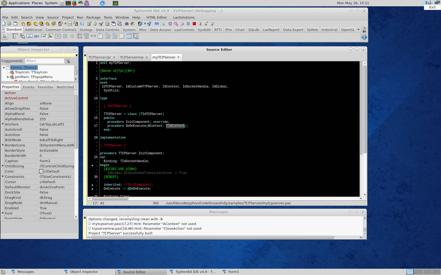

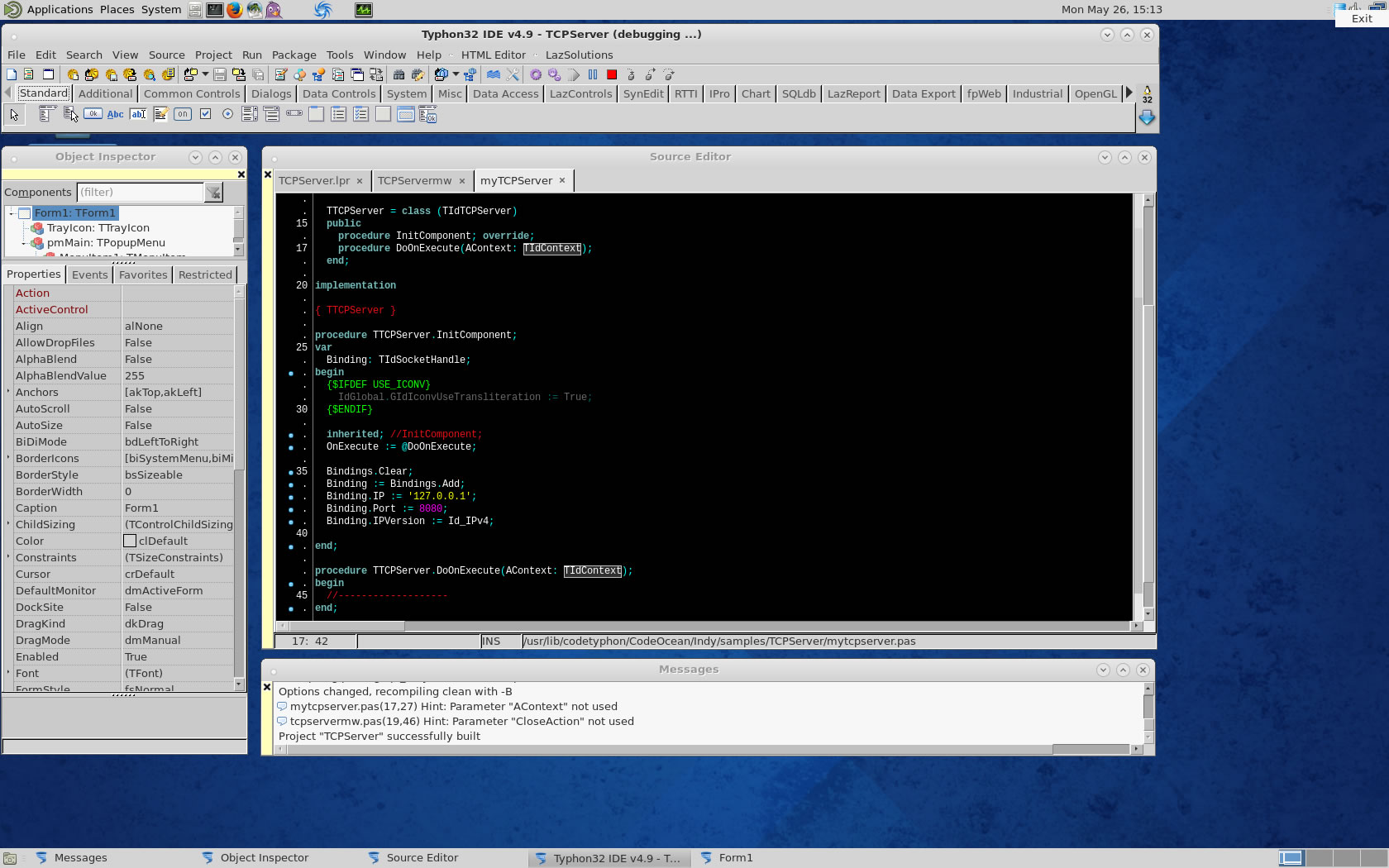

Re:Error Indy lib [RELOADED] 12 years 4 months ago #5514
  • Posts: 4637
Our demo-suggestion for a TIdTCPServer project
CT Lab 4.90, pl_Indy (22-5-2014 SVN trunk Rev 5139)
and some screens from Typhon64 and Typhon32 on Fedora 20 64bits, with MATE and MultiArch
