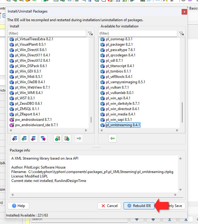

Hi well how i can install lamw on ct on package is not show up the way can select and install.....
i select install multiplatform but now show up android app to select kind of app are going to create....
how can develop app for android...

Install to TyphonIDE, LAMW CT packages..
Select and ADD
Build TyphonIDE
