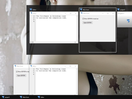

I tried to set  ShowInTaskBar := stAlways to both forms (also the main form). In this case, the editor form doesn't lose focus when the autocomplete function gets activated, but when the application is launched (only the main form is visible), there are two buttons in the taskbar. One with the name of the form and one with the name of the project.

But I don't want the editor StayOnTop all the time. The medium working solution to set ShowInTaskbar := stAlways also for the main form. But there is this strange additional button in the taskbar (see picture below).
Last edit: by Premysl Beran. Reason: Wrongly added picture
