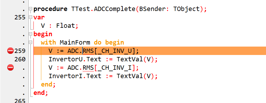

From time to time an error occurs in completely innocent code:
And if you just run the compilation again, the error does not occur again.
Sometimes there is a message about an internal compiler exception, sometimes without this message...
What it is?
