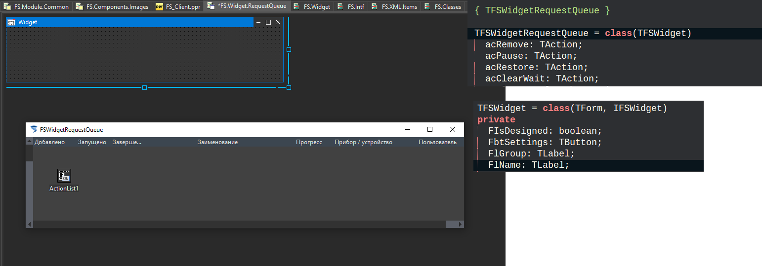

The form TFSWidgetRequestQueue inherits from TFSWidget and not directly from TForms. Then we inherit TFSWidget from TForm and the IFSWidget interface.
As you can see in the picture, the form is shown twice. One is in the form designer itself. The second seems to be in runtime. This form can be safely dragged between monitors. And the form is not tied to the designer in any way.
When you try to close it, a dialog box appears to save the form before closing. But the form does not close.
During debugging, this form sometimes overrides CodeTyphon and doesn't let you do anything. Sometimes you somehow manage to get back to CT.
Sometimes you have to restart CodeTyphon to continue working, because such a form remains active during debugging, and the CT seems to disappear.
It was seen on CT 8.0 and 8.1 on Windows 10 on three computers.
Windows 10 ~ CT 8.1

Please test TyphonIDE
without DarkTheme.
Any Sample Project for our LAB test ?
without DarkTheme
Without the dark theme the behavior was similar.
I'll try to build a sample project later.
Windows 10 ~ CT 8.1
