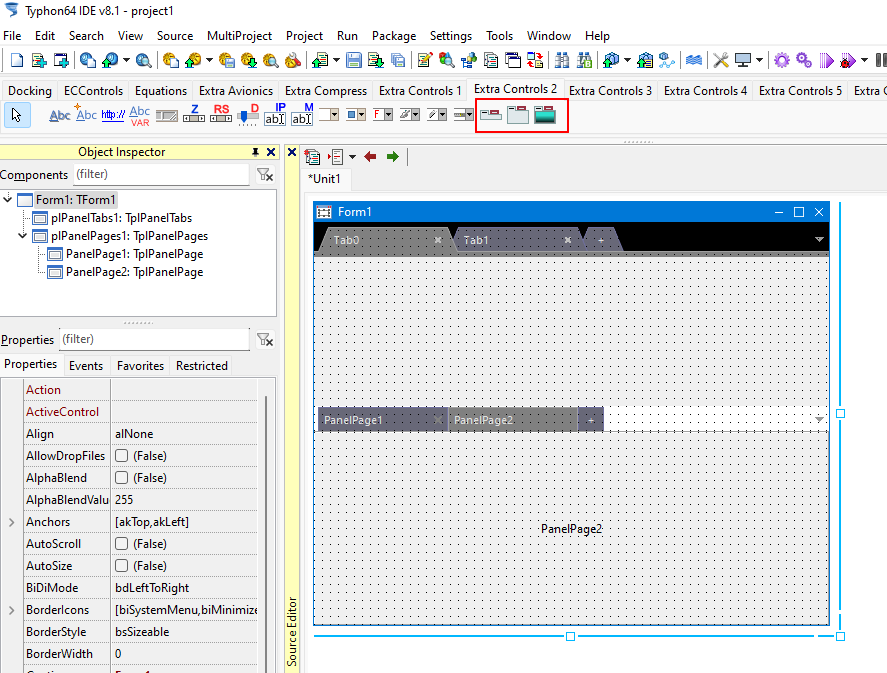

I Can't find attab control 3 years 5 months ago #17672
CodeTyphon has in Extra Controls 2 page:
-TplPanelTabs
-TplPanelPages
-TplTabColorControl
Are Custom draw Tab and Page controls.
