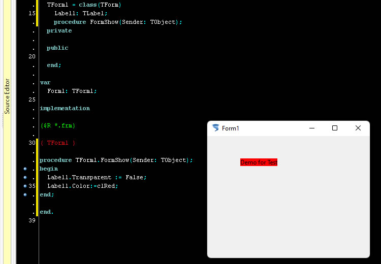

Label.Color cannot be specified. 4 years 1 month ago #17305
Just first set TLabel property Transparent := False;
procedure TForm1.FormShow(Sender: TObject);
  Label1.Transparent := False;
  Label1.Color:=clRed;

Thank you, Stenas Stefanos.
I was dynamically spawning  TLabel instances on my original calendar application.
And there I changed TLabel.Color many times.
Since CT7.8, an accident occurred there, and I was honestly in trouble.
Therefore, I asked a question on this forum, but it was very helpful to receive a clear answer immediately.
