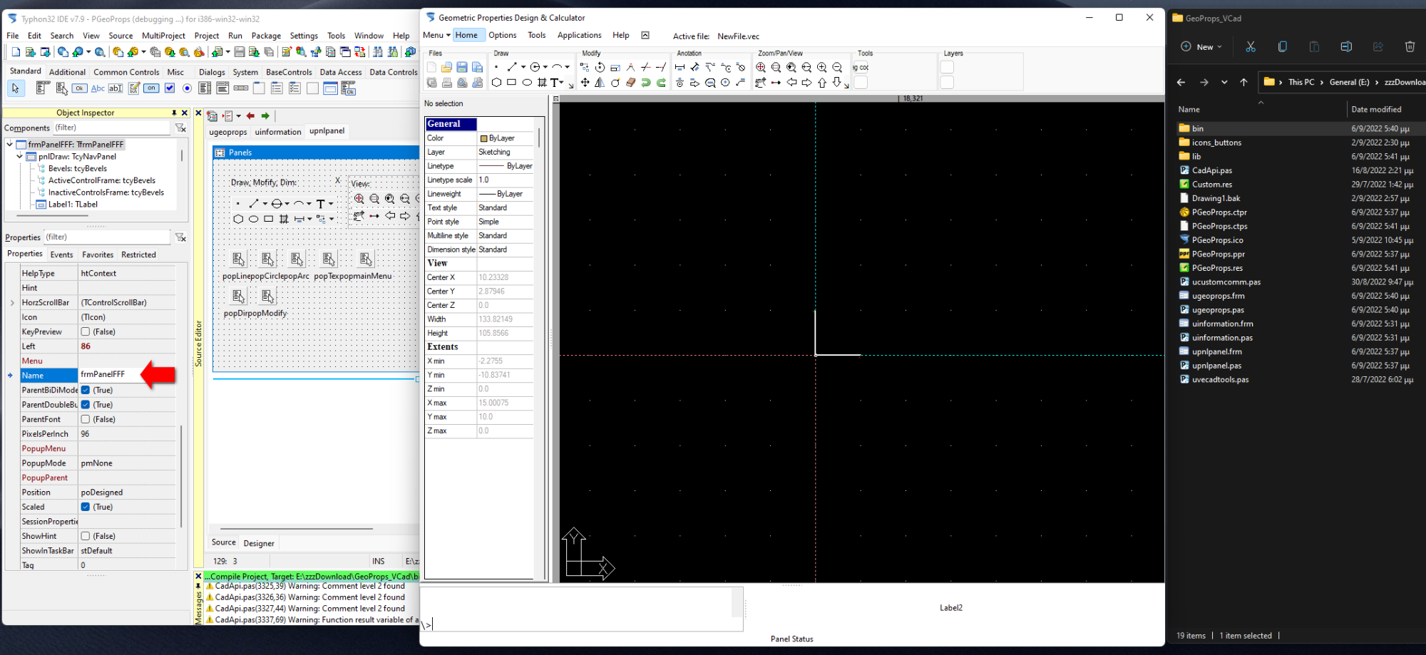

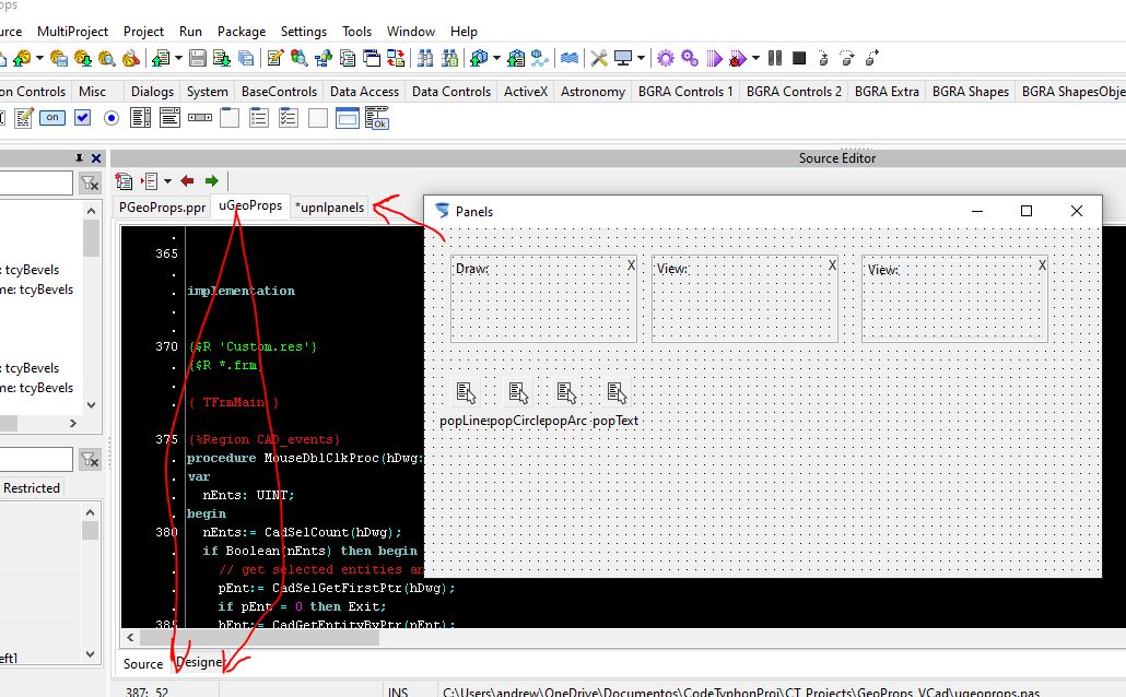

Unit form is shown as a floatting window 3 years 11 months ago #17267
  • Andrew John Richter Cass
  • Posts: 30
Hi everyone!
One of my units from a project doesn't show it's form as an embeeded design window (i have to use F12 to show it). It's enoying since it happens only with one unit.
Someone knows what happening?
Thanxs

Unit form is shown as a floatting window 3 years 11 months ago #17274
  • Posts: 1412
  • Thank you received: 224
Try this
-Change the Form name in Object ins
-Save project
-Close TyphonIDE
-ReOpen TyphonIDE
Unit form is shown as a floatting window 3 years 11 months ago #17275
  • Posts: 30
Thanks for your help.
I found the fallowing solution/problem:
Looking at the project files i found that the statement "Application.CreateForm(TfrmPanels, frmPanels) in 'ppr' file; " wasn't there!

Unfortunately the problem merged again. Randomly the forms open as floating or embedded.
I turned off the embedded mode until the problem is solved. Thanks for your attention

I'm leaving here a copy of the faulty project so you may see it.
The unit that isn't showing the form in an embeeded way is the upnlpanel.pas
regards

We Fix the upnlpanel.frm and
we Rename TfrmPanel =>TfrmPanelFFF
to ALL project units.
We test upnlpanel.pas many times and all are OK in Embedded Form Designer.
1) Because, Simple Forms names used and from TyphonIDE,
please, don't use so simple Forms names to your Projects.
2) in CadApi.pas, procedure ShowPropWndEmbedded(WindowHandle: THandle; Container: TWinControl);
use similar "Embedded" way like Typhon Embedded Form Designer.
My suggestion is to use ShowPropWndEmbedded(Foo) only in runtime
Fixes without bin folder in attach file: GeoProps_VCad2.7z
Screen from Win 11 ent and Typhon32
