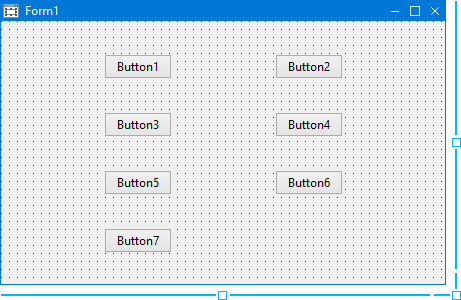

After setting the ChildSizing properties of a form i examined a very strange behaviour. The result can be seen in Picture ('Form1_Pic3'). To test for yourself, start a new project, set the ChildSizing properties according to Picture ('Form1_Pic2a') and put a few buttons on the Form, or you can use the attached example project (ChildSizing.zip).
Steps to repro:
1. After opening the attached example project the form designer looks like (see 'Form1_Pic1') with the ChildSizing properties set to (see 'Form1_Pic1a').

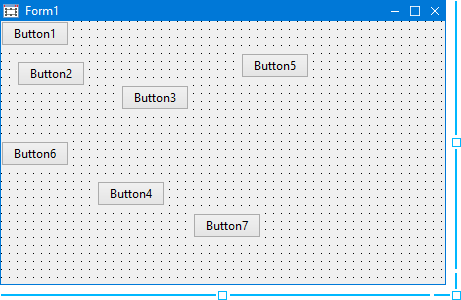

2. After changing the Layout property to (see 'Form1_Pic2a') the form is changed to (see 'Form1_Pic2'). All Looks Ok so far.

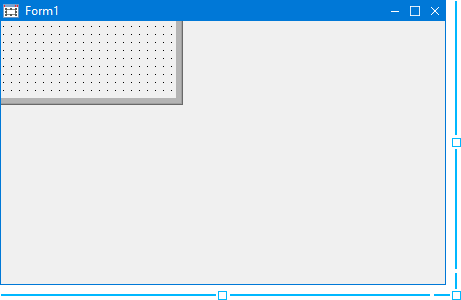

3. Now switch to form designer and click on the form and you will see this Picture ('Form1_Pic3').

Form with ChildSizing properties 5 years 23 hours ago #16163
  • Posts: 1428
  • Thank you received: 229
it's Embedded Form Designer problem
I will add this to LAB To-Do list
