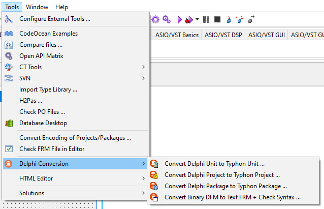

Second, Typhon has a Delphi2CT converter.
This tool will TRY to convert your code to Typhon IDE.
My suggestion is to start with this tool.

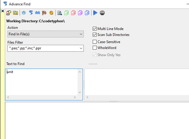

I'm often use the function "Search in files" for a component name. If there is no result then I'm changing to the WWW to get a result.
Converting Delphi source code to Typhon 5 years 3 months ago #16069
  • Posts: 4641

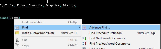

You can use and Typhon=> Search=> Advance Find
